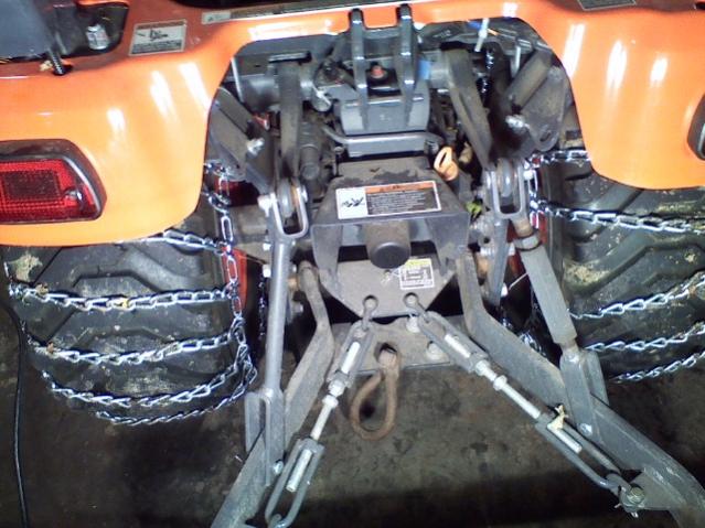

Made sure it was tight on the inside of the wheel. After "working the chains in" inside looks good. So far, so good.

RCW,
how close are those to the MMM? Where did you get your chains from?
thanks
Very close - one had some slack that slapped the deck a little. Had to cinch it up a bit. MMM is off now - came off shortly after chains went on. Snowblower goes on soon.
Got them at a locally-owned hardware store in my small hometown. They ordered them in for $130. (I don't buy stuff online much)

After they were pulled tight, they may not hit the deck. Not sure though, since the deck came off. I did mow once with it on, and it was OK. You are moving much faster mowing than pushing snow. Slow down, and it may be all good.
In these parts, the MMM could act like a skid plate, and high-center the whole tractor. You'd just sit and spin.
I'd try the chains. If that doesn't work, find a spot to hank the deck and store it. Just my opinion.

Ummm, did you or did you not wind up using spacers? I just picked up two link chains for my BX-2670 today. I haven't been down on my knees to look at available space yet.
10,207
7,126
I did not use spacers. When tight, all is good, so far. I've done the driveway several times now without issues.
