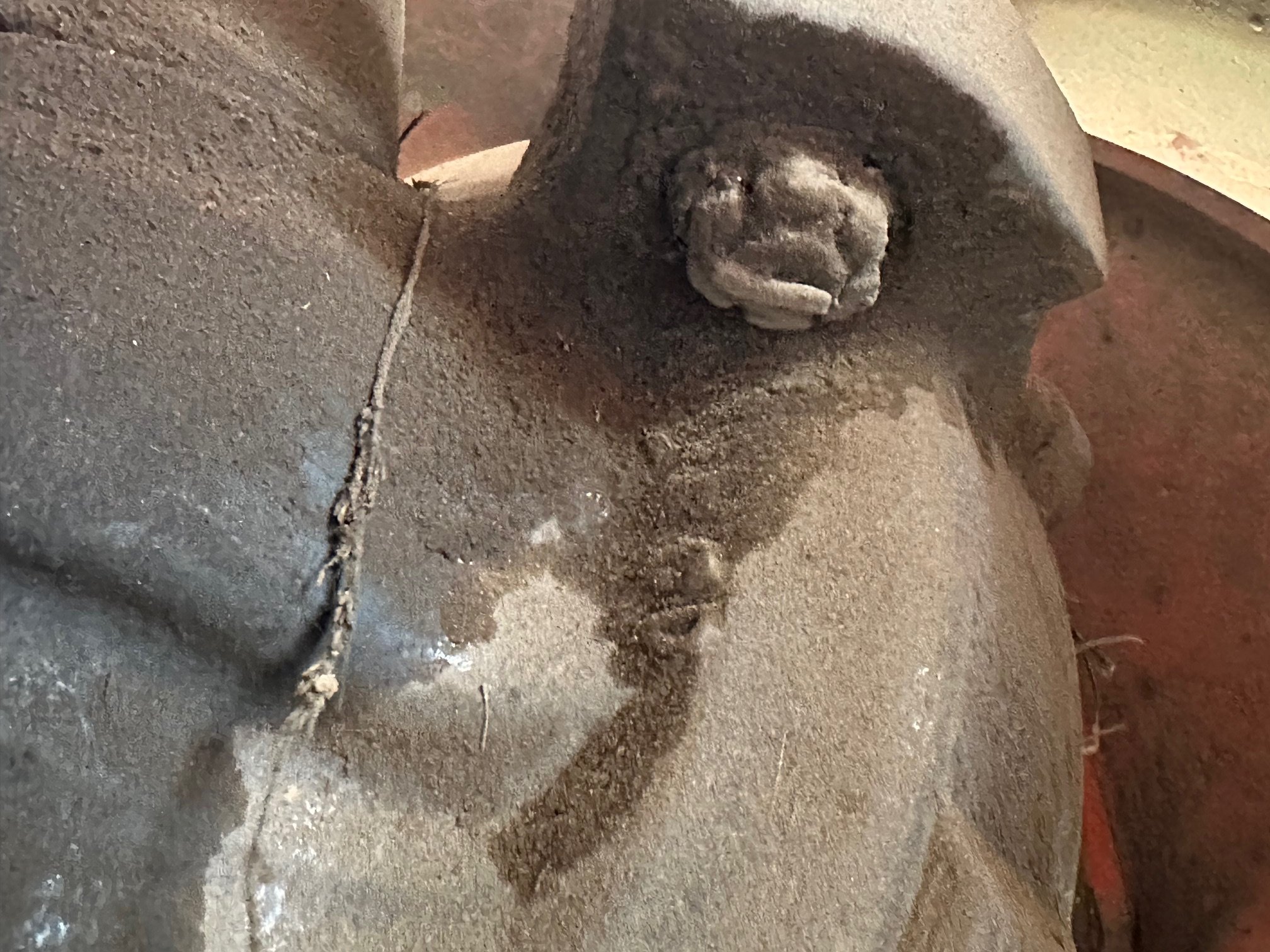

So, I'm just going to add onto this thread as it is related. I crawled under the front to get a better look at the tie rods. 3 of the 4 thread posts that connect the tie rods to the tractor have something like a castle nut on them. However, the 4th one which is on the wheel hub side, had a welding rod still stuck to the threads. Upon close inspection, it looks like the nut wasn't there, but some really nasty welding is. It looks like it might even be connecting the threaded post to the cast housing on the hub. My question is: if this is the case, how do i get the tie rod out? I guess I could use a sawsall and maybe cut through just under the knuckle joint on the tie rod? but if the threads have some spill over from the jackleg weld, i'm worried if i do anything, i might break the cast housing? i don't do a lot of welding, but is it like soldering in that if i put enough heat on it, it just melts? will that happend before i damage the cast housing? as you can tell, i'm just fishing for thoughts as i don't know how to even start on this. thanks again for any wisdom shed.

Welding is not the same as soldering or brazing. Soldering is lowest temperature method then brazing then welding is the highest temperature. Soldering and brazing only melt the additional material but not the parent material. Welding actually melts the parent material and adds small amounts of filler material to create the fillet of the weld.
You can NOT remove a weld joint through heat alone. You have to physically separate the two parts through a cutting or grinding process.
Post a couple of pictures and people will be able to make suggestions on how to proceed. Worst case will be to have to replace the main tractor part along with the tie rod.

so, the first pic is obviously the one in question. it is looking up at the tie rod end/threaded post. I also included a shot of the other side, showing how it should look (through the grime :p) and one of the center attachment point which shows a clean version, although inverted with nut on top, instead of nut underneath. if i need to get a better picture, i can do that too.

Put a grinder to it and grind off the weld. Just be careful you don’t grind any of the casting or you will have a hard time keeping the new replacement end tight. You might need a die grinder to finish up the job if there is any weld inside the hole.

they did weld up in the cavity. i hadn't thought about using a dremel (I have this already) to get up in there. thanks for the option.
