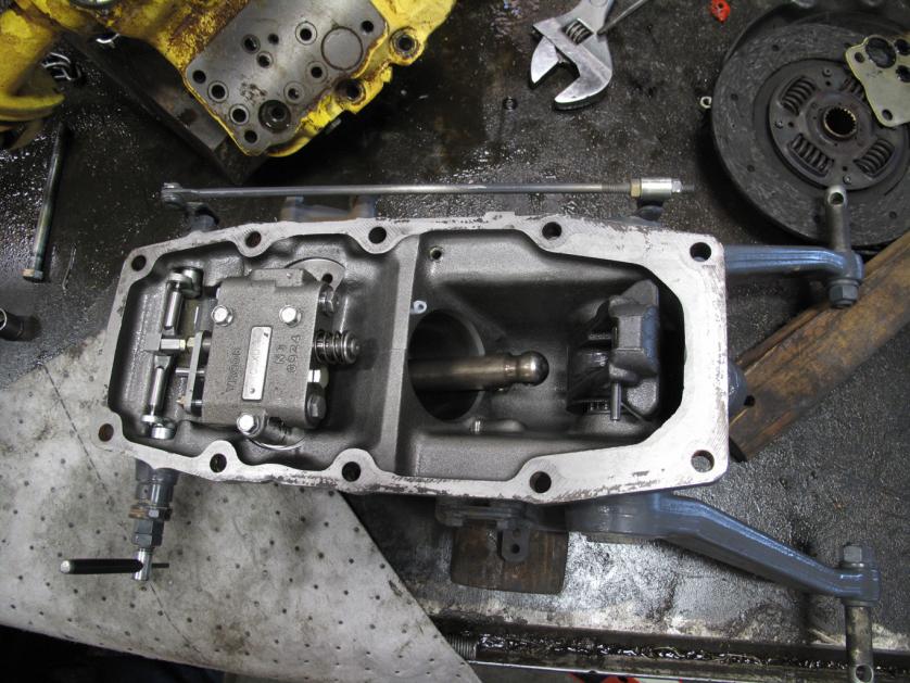

Here is what an L3800 HST 3-pt looks like under your seat. This is the cover, containing the 3-pt, inverted on a work table...
The HUGE piston (about the size of a Chevy 305 piston) pushes a pretty massive connecting rod which pivots the 3-pt control arm inside the rear end. That moves the lift arms on the outside of the rear end.
The funny box with all the levers and push rods to the left is the 3-pt control valve. Its controlled by the 3-pt lever simulated by his punch used to twist the linkage. That valve was a common problem with L3800 3-pt arm chatter going up and down. My valve was replaced. The part ran over $900 and was covered under warranty.
Here is the rear end under that cover...
Hope that gives you an idea of what you are looking at. I am betting the piston is stuck in position and needs to be broken loose... You can take this cover off pretty simply by disconnecting the linkage on the outside. You could soak the back side of the valve with penetrating oil over night and maybe carefully heat the piston cylinder with propane. AFAIK, there is no way to get behind the piston to hammer on it except by hydraulic pressure. There is no gasket upon reassembly, only silicone RTV gasket seal. Pretty safe to go inside and poke around. Just be sure to cover the rear end with a big towel to keep stuff out of there!

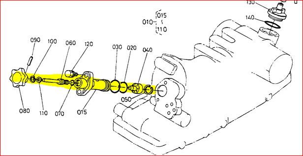

We removed the descend rate control valve. It was in good shape and appeared to be working. With 150 lbs weight on the hitch, there was no movement with the valve fully closed or fully open. We are considering digging deeper as TX Jim recommends.

If you removed the descend rate control valve and it didn't drop, you have a problem, as removing that valve should allow all the fluid that is in the cylinder to just flow out regardless of any settings and the three point should have come crashing down!

After seeing the diagram, I agree. If you flood the cavity left by the valve housing, some of that may flow into the pressure side of the piston. They say acetone and tranny fluid make a killer penetrating fluid. If all the rubber seals come out with the valve core, howsabout a little acetone? That should vapor off after the tractor runs awhile. Or, a penetrating oil?
Sure would beat dismantling the rear end. Given the way mine is built, I don't see a way to get on the pressure side of the piston even if the cover is removed. Perhaps there is a little room if you used some wood and tried to further move the piston "in" to break it loose.
