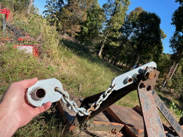

I have a bush hog with a chain from the 3 point mount to the back of the mower. Rigid top link from mount to the tractor. I have to have a way to pick up the mower.
Mowed in plenty of dips and ditches and no bucking me off. Maybe I'm doing it wrong, but the mower link and chain seem to move freely. This is on a 60 year tractor with no seatbelt.

Your chain is doing the same thing as using a chain in place of the top link. I'm not saying that not using a chain is going to get you hurt, but if you mowing in rough places with stumps or other large objects at least consider one.
In the end use what you choose, I choose a chain.

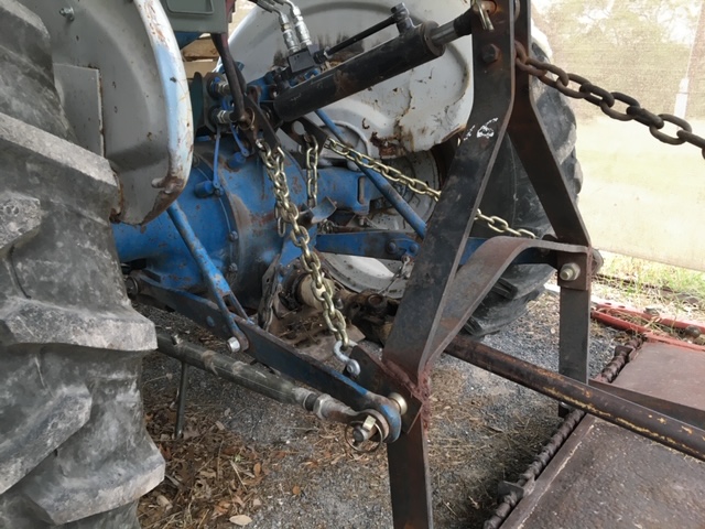

Not only does my Brush Hog brand rotary cutter have a chain on top, but also limiting chains to keep it at a constant height since older tractors won't hold position very well. Most people probably wouldn't cut the areas that I do. Pretty rough terrain, lots of ups and downs.

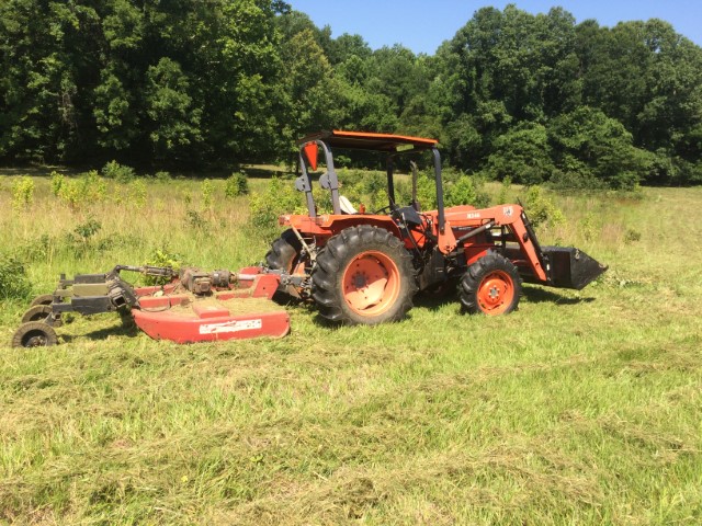

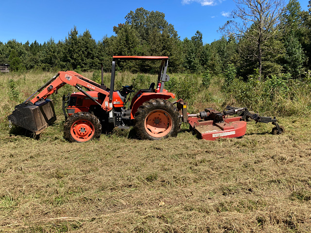

Neither my 3008 Bush Hog nor my smaller 6' cutter have a top link at all. It's called a 'semi lift' where the rear cutter wheel(s) are always on the ground the cutting height is adjusted by the tractor's lift arms.
Another view of the 3008 which has 3 wheels. Notice that there is nothing for the top to attach to.
