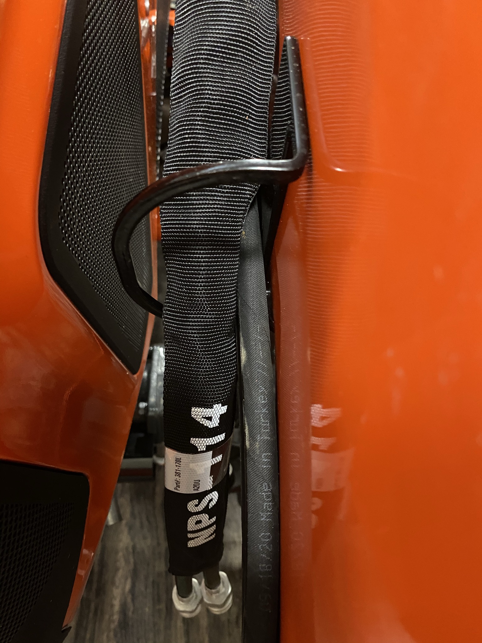

Good day everyone. I finally got the loader and third function for the LX2610, about three months after I got the tractor. The dealer installed the Landpride third function and the bottom button closes the lid of the grapple while the top button opens it. Just wondering if there is a "standard" as to which button does which, you know, kind of like all the loader stick movements are the same across the models and brands. I also want to know if the button function can be swapped so the top button closes and bottom button opens.
Apparently my brain is wired opposite the buttons because as I was putting everything to bed for the night I hit the button expecting the opposite reaction of the grapple and had to catch myself.

Switch the hoses on the third function valve body.
There should be 2 hoses with flat faced couplers on the top of the valve body.

Swap your hose connections to reverse action, it's easier than what you are proposing to do electrically. Mark you hoses after to remind yourself.

Ah...easy enough fix thanks. I do believe they are both flat faced as the pics above.
On my other question...is there a standard button function? Top=close; bottom=open? Or just based on whoever installed it?

So to wrap up. I switched the electric plugs at the solenoid. The hydraulic fitting were M/F so not direct line swappable.
Easy fix and now the buttons match my brain.

So to be clear. The couplers are NOT interchangeable, but the wire plugs at the solenoid valves were. Easy swap and it’s done. Works great. Honestly it was as easy as swapping couplers if they were compatible.
FWIW, I have plenty of 12v wiring experience so had no fear of that if it did get complicated, but it didn’t.
