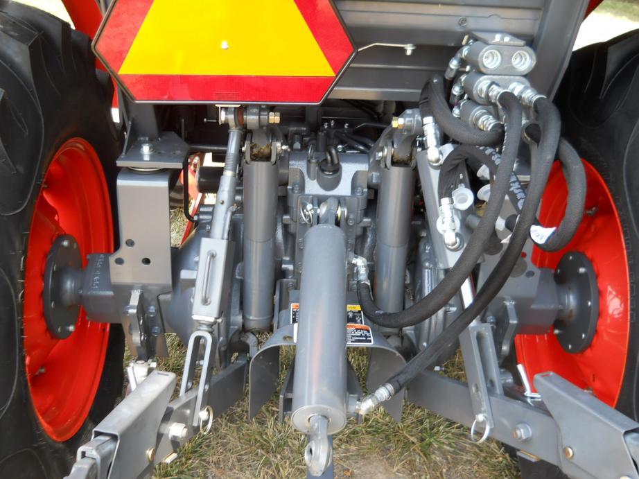

Hyd top link is a cylinder that replaces your standard link so that it can be adjusted using a rear remote (in most cases)
tnt - - Top and Tilt, this is normally done as a kit and it basicly a hyd top link and a hyd cylinder the goes to one of the 3 pt arm so that one arm can be lowered and raised seperate from the other arm.
Ah......hyd cylinder as the top link on the 3pt hitch, so I can raise the bush hog deck up off the ground while driving back into the land, the when I get to the spot to mow, lower it to the ground. Of course I want that ability, do you just drag it along behind you otherwise (if you don't have that option)?
An the TnT is the above but with a cylinder replacing one of the lower links and allows to each side a bit? How far could you swing it, or a blade, without binding the deck drive shaft or the other lower link of the hitch? I'd imagine not very far with the R4 tires? I heard the guy at the dealer the other day say that with the R4 tires, sometimes the lower links would get into the rear tires depending on what you had hooked up.

The hydraulic top link simply allows you to adjust the length of your top link from the seat rather than getting off and doing it by hand. When using a box scraper, you can make angle of attack adjustments on the go to feather your load, dig deeper, spread better etc. On a cutter it will let you raise it higher for transport or when crossing ditches then you extend it to the proper length to get the proper deck angle when cutting.
The side link just allows you to adjust the angle of your scraper or blade to do ditches, grade a smooth spot when your tractor is on a slope, it just does stuff from the seat you normally have to get out of the seat and do by hand.

So is a TnT something that a dealer could add for me when I buy the tractor, or something I'll need to get and add myself? If both, would it be cheaper to do it myself?
Actually, I probably would want to do it myself, I'd rather put it where I want it than let a dealer hack it on where ever it's easiest and quickest for them to install.
MtnViewRanch
Oct 10, 2012
903
360
Lakeside Ca.
Aftermarket will be a lot less $$$ and can end up better than the OEM stuff. ;)
I preferred OEM on my L5740 and got a really good package deal as I have purchased several tractors at my local dealer, but MtnViewRanch knows ore about that stuff as he sells it, so I will defer to his advice. When I get around to it, I will probably be buying a hydraulic top link for my M8540 from him. I already have the remotes on it.
