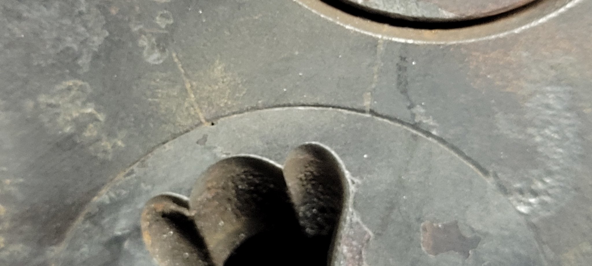

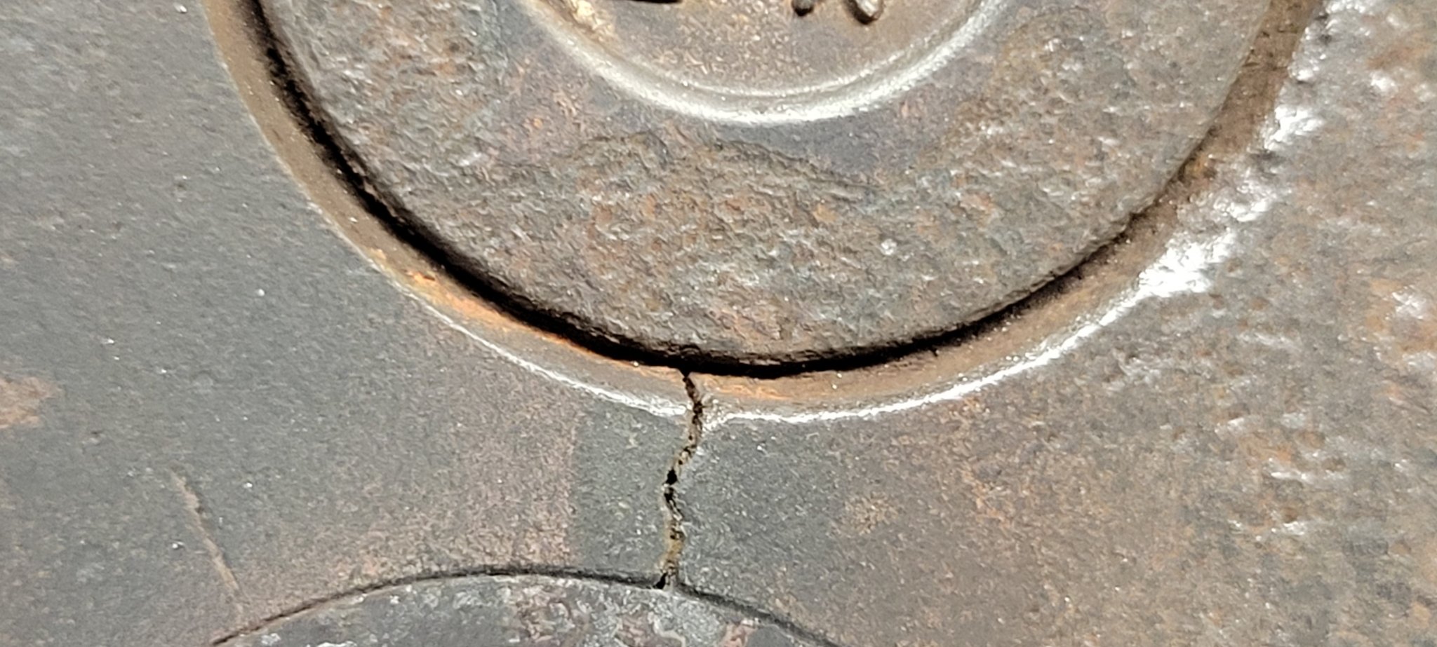

I have uploaded 3 pictures of the head. The first has colored circles indicating the closeup areas of the two other pics. I note that the center cylinder combustion area seems to be more "rusty" than the other two, and that is where the large obvious crack is. I had noticed this season that it took a few more seconds to "clean up" after starting it, which makes me wonder together with the rustier appearance of the center cylinder combustion area if this crack might have been there in a smaller form for a while. I'm not sure if the area circled in yellow is actually a real crack. No where else on the head or head gasket showed any bad signs.

I believe the cap is 12 psi. I already have the head off of it, and I see a crack in it that I'm pretty sure was the problem. I wanted to test the block independently for some peace of mind if possible before committing to installing a new head and head gasket.
From the picture, the crack you have circled in blue is definitely your problem and has been cracked, probably to a lesser extent for some time.
Replace the head and you should be OK. I have replaced dozens of cylinder heads on the 3 cylinder engines in ZD's, BX's, and RTV's and I have yet to find one with a cracked block.

I agree, that head has been cracked for a long time. And that cylinder has had water damage for a long time also. That pitting in number 2 didnt just happen.

Definitely a large crack... then cold thermal shock after overheating... it started hard...then water shot out of the exhaust. Did you check for obviously bent rods by bringing all 3 pistons up to the top of the deck to make sure they top out equally?

agreed the head has been broke for a long time. Replace it.
Kubota blocks generally don't crack, almost always just the head as it's the hottest part of the engine.
