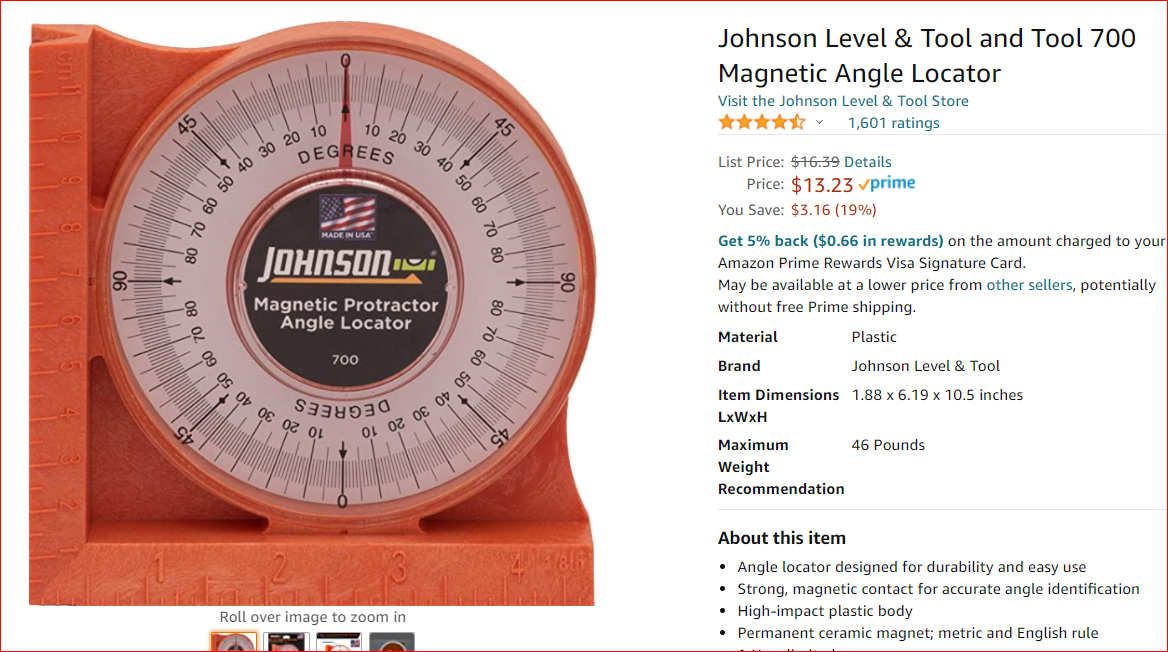

the will do the math for you - and is magnetic- place on hood and run on!
