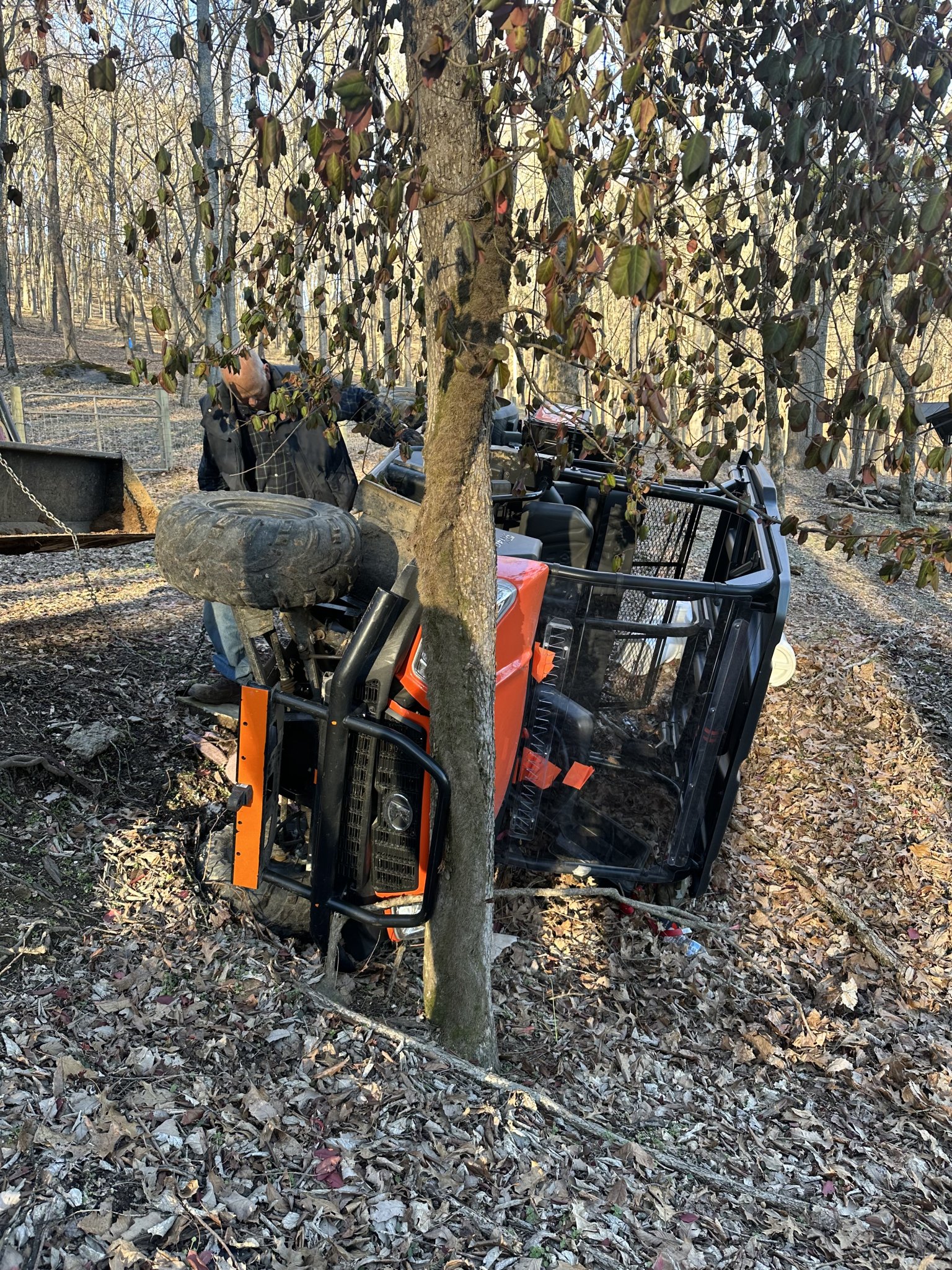

The dog rolled the rtv x1160. Really the dog jumped in and trounced on the accelerator, up a tree and on its side it went.

Standard stuff. Pull glow plugs or injectors (whatever is easier). Turn the motor over and male sure nothing squirts out of the holes. Make sure the oil level is OK. Reinstall whatever you pulled.

Like The Evil Twin suggested.
Get it up right, pull glow plugs or injectors.
Check all fluids.
And check air filter, seen several different pieces of equipment where oil has back feed into air filter.
