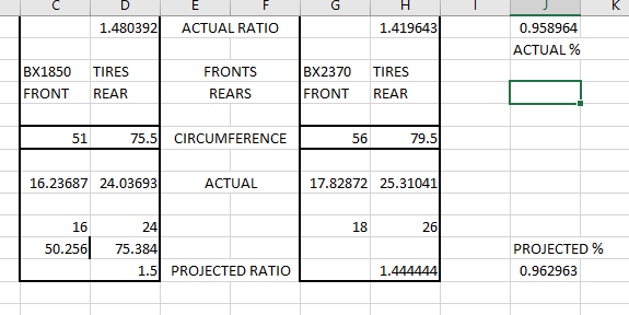

I’m new here but have the same question. I have a bx23s that has r14 tires on it. They work well in the woods but are still too aggressive for my lawn. I want to get a set of turf tires strictly for cutting grass. My question is can I use tires and wheels off a bx1860 on my 23s? I found a good deal on them. I know the tires are smaller but will the rims fit?
10,917
2,737
If you look reaaalll carefully at the front and rear tire sizes on the 1860 ....and then look at the 23s ......
they are different - BUT, and here is the crazy but...... the ratio of them is very, very close.
Notice I am comparing bx1850 to a bx2370 (which should be the same as your two)
The diameter is the math OF the actual measured circumference.
One thing to look at also - the front rim on the 23s is for a 8.5 wide tire and the rim on the xx60 is for a 7.5 wide tire.
I placed 2370 tires ON the 1850 without problems - BUT the rim from the BX2370 rubbed and bound up on the steering knuckle - so I had to get the 18" tires and place on the 7.5" rims from the xx60 ( if this makes any sense)
I am always on grass too - in 4wd - never on a hard surface.

Great information. Thank you. If I understand correctly you tried to put the tires from the 2370 onto the 1860, but could you put the tires and rims from an 1860 onto your 2370, or in my case 23s? Kinda the opposite of what you did? Hopefully that makes sense. Sorry, again I’m new to the bx world.
I can't speak for the OP, but I do know that my BX2200 front tires would not fit on my son in law's BX23S, because the rim was too small to fit on, although the tire size was the same.
I assume that the BX23S wheels would fit on my BX2200, since the wheel itself is apparently slightly larger in diameter where it slips over the hub. This is an assumption though. Pretty sure the bolt pattern is the same, but not sure about that either. Rear wheels worked fine.
