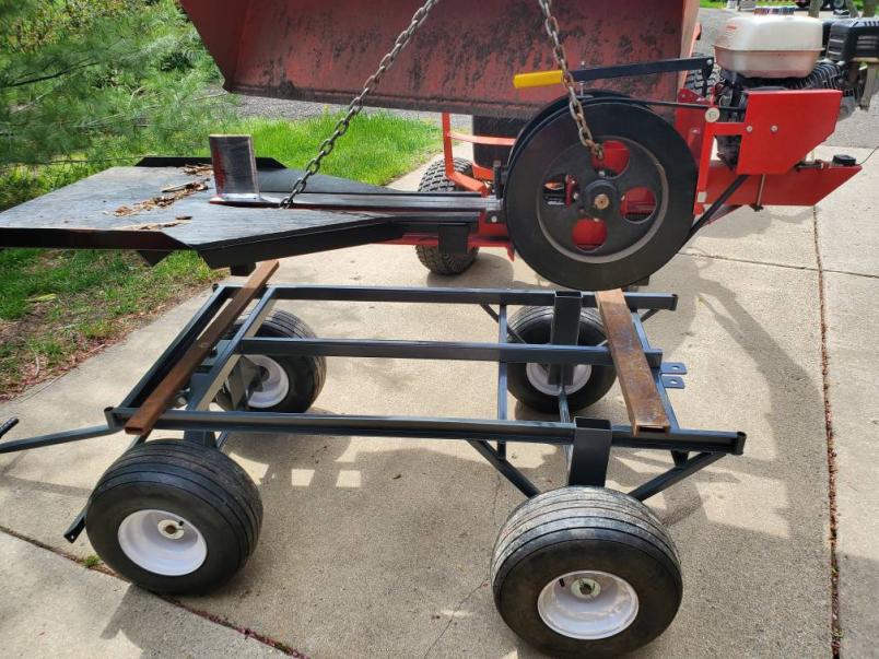

So, after finally getting fed up with lifting the front of my splitter on and off a ball, and having to make 2 trips to move splitting stuff around....
On another forum a friend modified his SS to be a 4 wheel steerable wagon. He put a fair bit of time and parts into it and it looks OE. Very nice job.
I wanted something more plug and play... and Ive been looking for about a year for something suitable to mount the SS onto. I looked at all sorts of carts, wagons, trailers.... building something.
Enter whats called an on deck roofing cart.

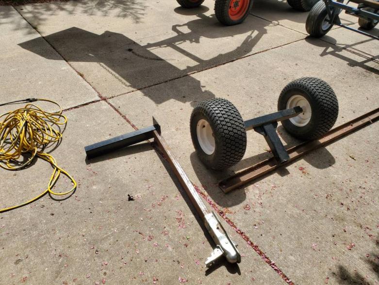

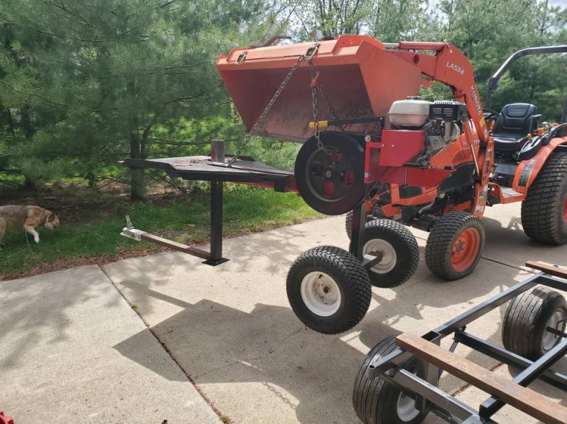

Mounting it to the wagon was pretty straight forward, cut off the axle and front leg...
Grab a couple pieces of scrap and set it on the wagon...

Worked almost exactly like I wanted...
My only concern will be the side rails of the roofing cart. I THINK Ill be able to stand comfortably close enough to the working area to split without feeling like I'm reaching or bending. Ive covered them with pool noodles for now, but if im too far away, Ill have to modify the side rails....

That would have been a bigger job if I didn't have the tractor.

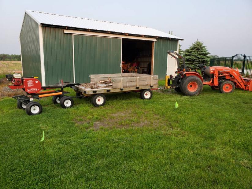

So getting about 10 cords through the splitter post mod... it's too uncomfortable leaning over the work area....
So I moved the splitter over and added additional work table space on the other side.
I didn't have a wide enough piece of hdpe sheet for the table, I'll get that this week.
