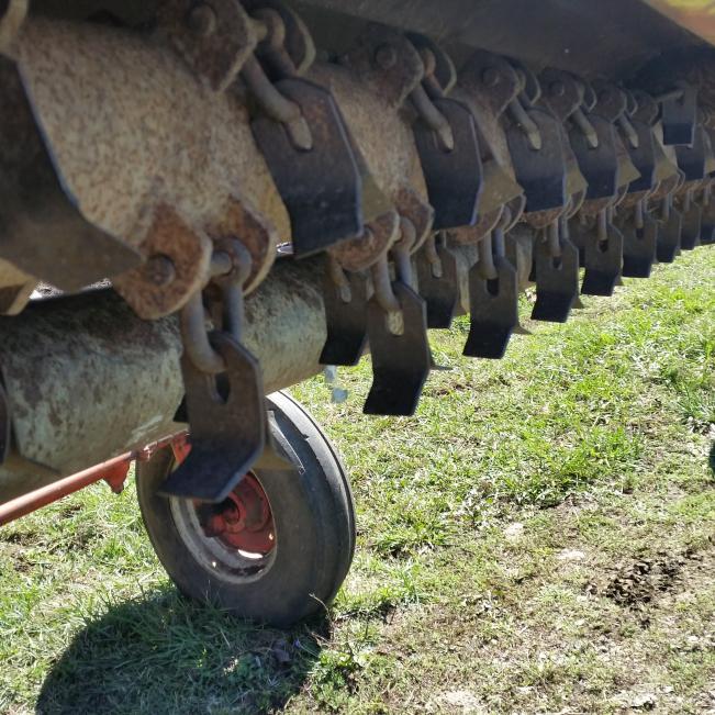

I have 3 flails of various lengths, and all have side slicers and I have no trouble with them.

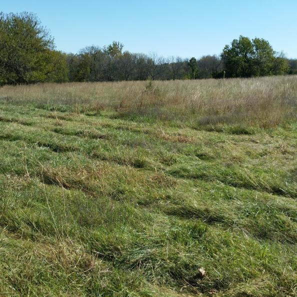

Here's some pictures of a field I mow. It's about 18-24" tall and I cut it leaving 8-9" for grazing. I use an old 7' with side slicers as you can see.
I sure would not be in a hurry to spend the money for duck feet.
I have cut some weeds 5' tall and 1 1/2" in dia. but I have to go over it twice. I can lower the flail and an area without stemy weeds and the cut will look as good as if cut by any mower you can imagine, including a zero turn!

After looking at your flail, it seems like I have very few stations. There are 4 rows of 4, making up only 16 stations, and 32 knives. Kinda skimpy. Probably why the guy got rid of it. He wanted to mow his lawn. Yours has a bunch more cutters.
