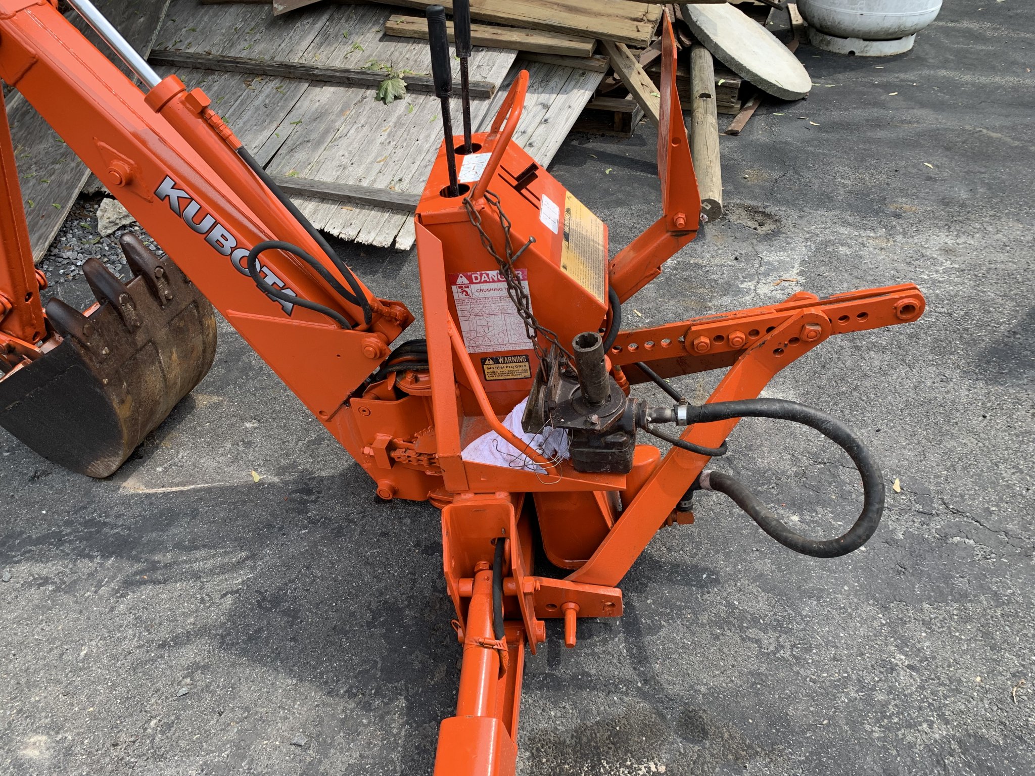

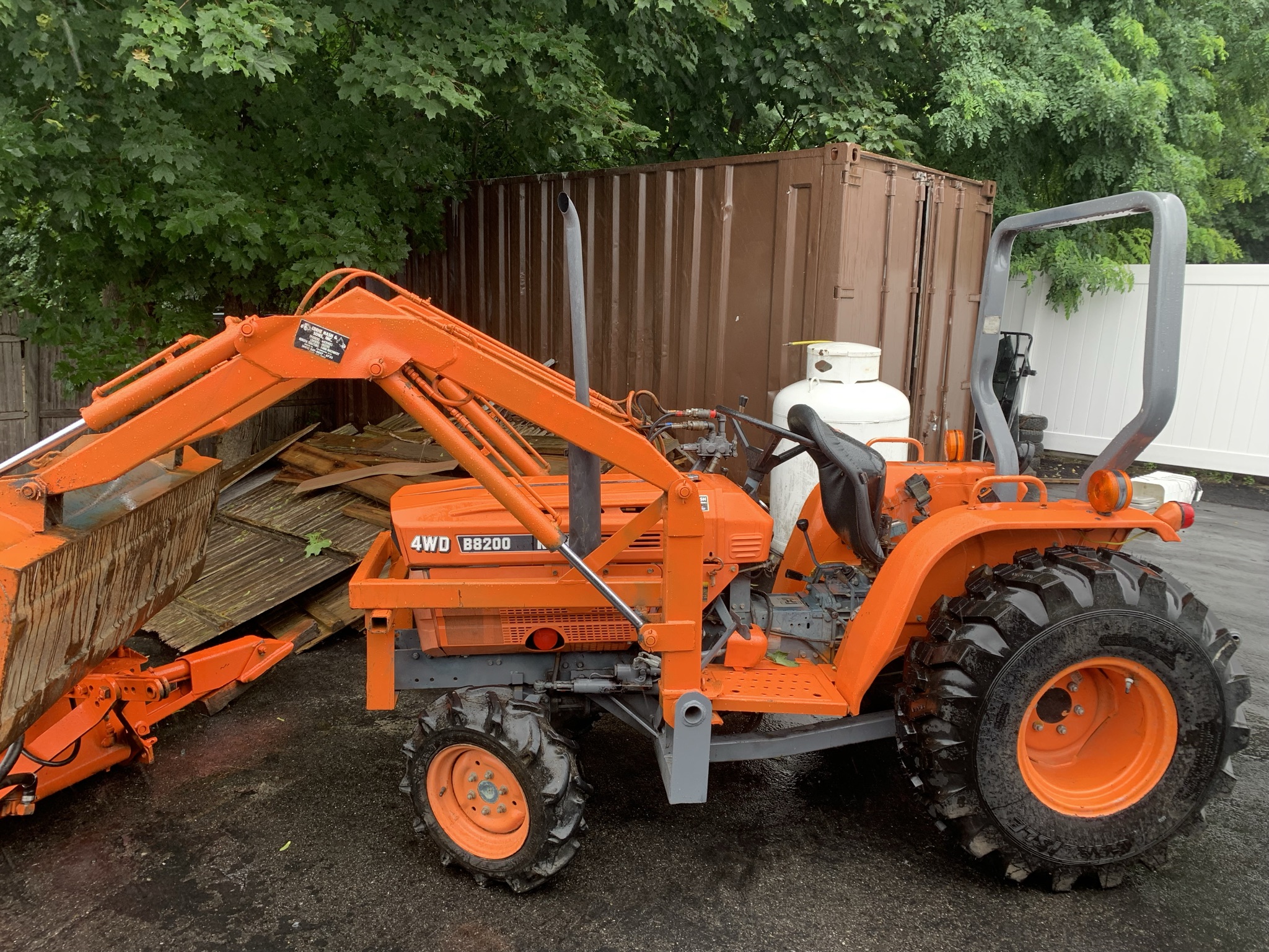

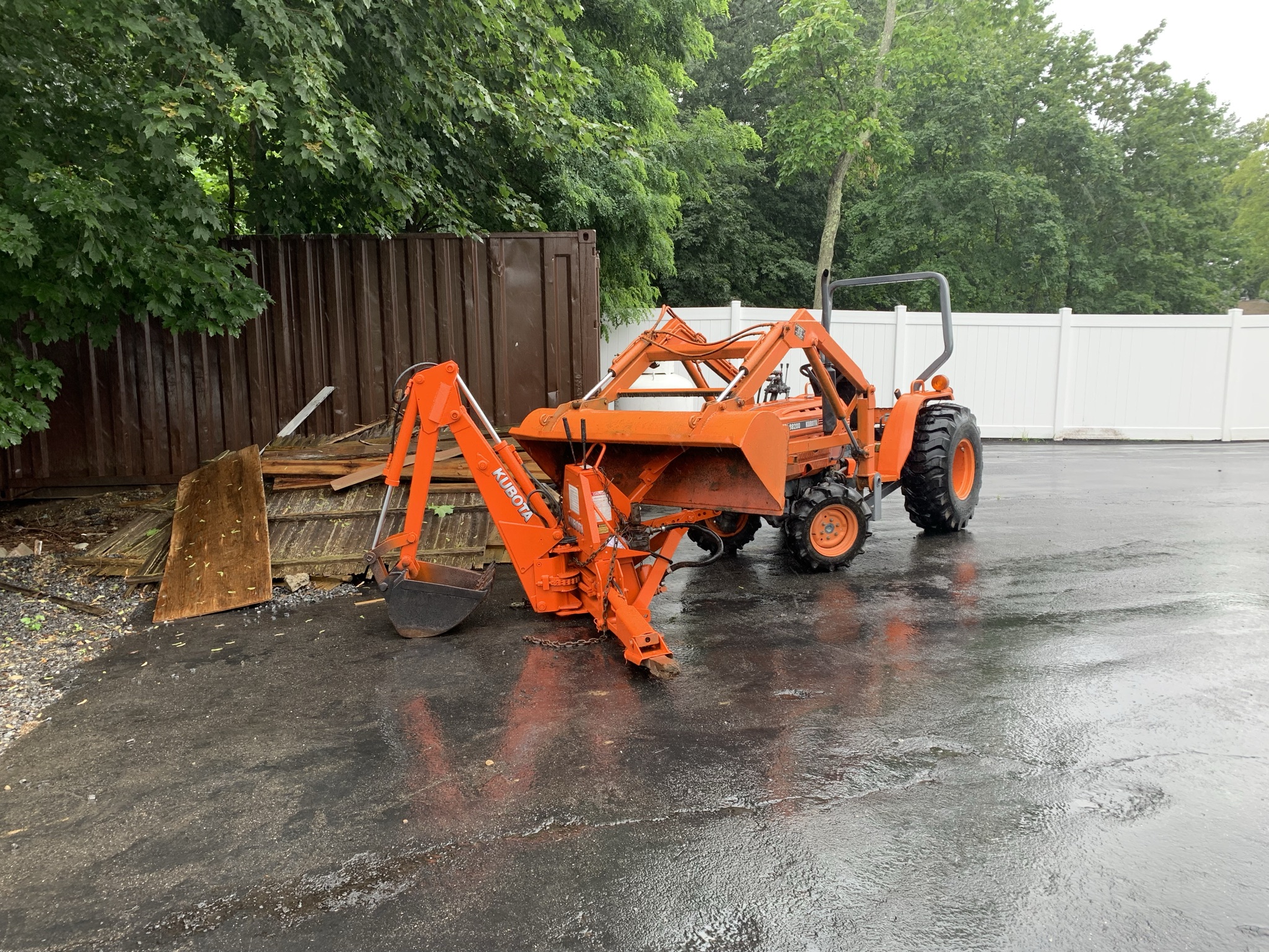

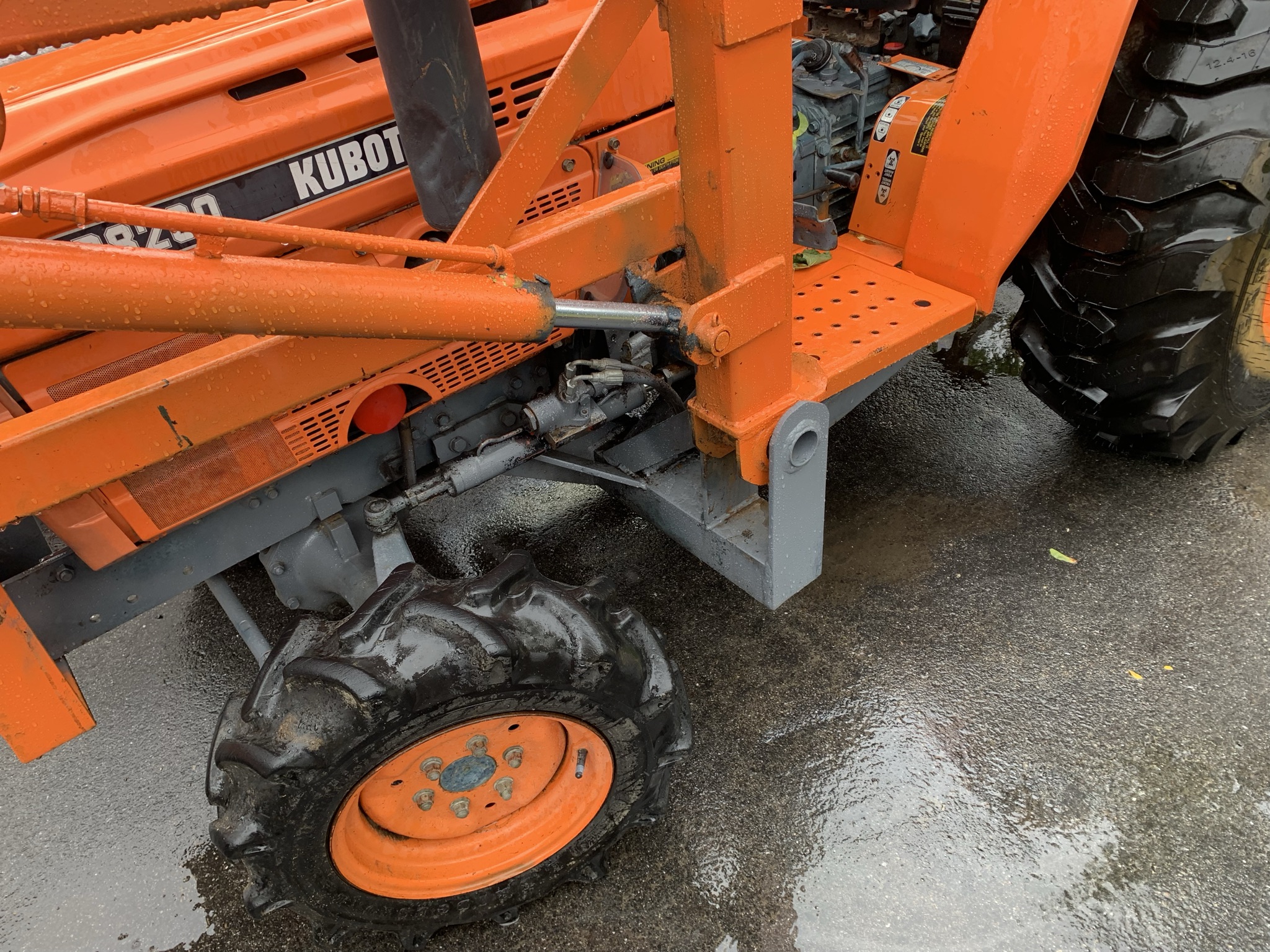

I am new to this. My question is I have a B8200 and it has this subframe from the roll bar to the front of the tractor. The 3 point hitch is anchored to it. I just picked up an L4520 backhoe which is the model the specs list as matchinijg the tractor. Is there a differant sub frame for the back hoe or is this reinforcement enough?

Looks like a 3PH BH, your sub frame won't be much help unless the BH mounts directly to the sub-frame. Enjoy your new toy, remember it's not a Case 580 TLB.

I have a B7200 with B1630 loader and a similar subframe. My subframe is clearly designed for mounting the loader.
The Kubota online parts site does not find anything for model number L4520 but does return a hit on L4530. which is a backhoe listed for use on a B9200. The parts diagrams for it show a L4531 "mounting kit". It consists of a long under tractor welded subframe and front and rear mounting brackets. Not at all clear it would work with the subframe you currently have on your tractor.
Looking at the picture of the hoe it does appear to be setup for mounting on the 3pt lift rather than a subframe. I think you need to find an operators manual for that hoe.

That looks very similar to the B4672A & B4690A mounting system. A picture of the backhoe from the mounting side would confirm it. If so, it's not a frame-mount, but it's not a pure 3ph mounting system either. It uses the 3ph components, but some added features lock it in, making it semi-rigid.
I see yours has a nearly identical mast ear that connects to the reinforced HD top link bracket (which your tractor does not yet have). Unless the backhoe was removed from another B8200, you may need to reconfigure or replace the mast to fit your tractor. There were two different mast ears for the B4672 -- one fit B series tractors but there was a different one for L series tractors. If at all possible, I would search out a copy of the manual for your specific model, but if you cannot find one, the B4672A manual can be downloaded from here and may be of some general guidance.
One thing I don't see is the 3ph limiter bar that locks the backhoe to the 3ph arms. It could be out of view, missing or maybe this backhoe doesn't come with one.
Your subframe looks very similar in principle to this one designed for other models that take a 3ph backhoe. The key factor is that the subframe should reinforce the joints were the tractor can be split -- between the engine and clutch and between clutch and transmission.

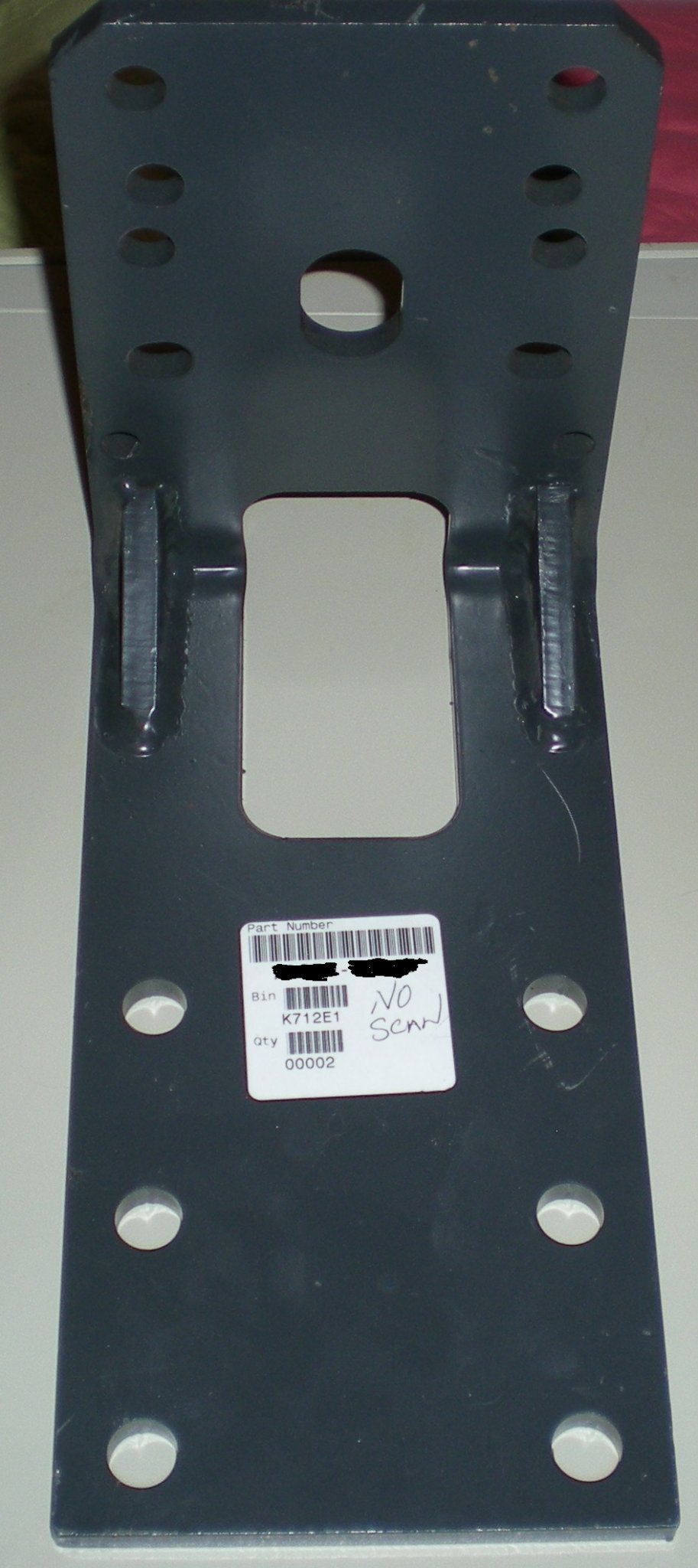

Your tractor absolutely needs the HD top link bracket (70050-93213 for the B8200) to receive the mast ear and ensure the backhoe doesn't crack the PTO housing. I made my own, as documented here, although doing so was the subject of some controversy :LOL:.

I came across some part diagrams for B/L4520 backhoe models on Kubota Books. It appears that your backhoe is not 3ph mounted, but uses an auxiliary mounting kit. Not sure which one you need though, you may have to consult the dealer on that.

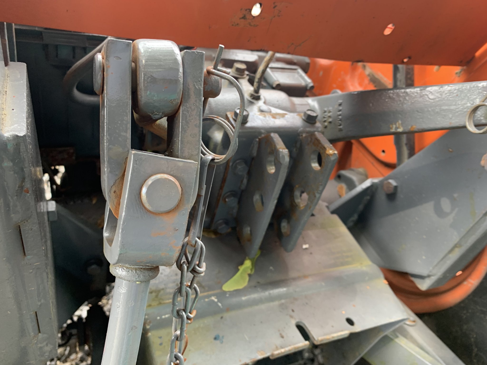

It looks like I have the top bracket. The back hoe has a very heavy arm in place of the top link that looks like it goes into that bracket. Is this correct?

I think I have the heavy duty t link bracket and the hoe has a very heavy attachment to use in place the top link
I sent the PDF I mentioned to the email address you PMed me.
The illustration for the B8200 looks different than what you have. The vertical pieces with the holes in them, turn horizontal, and the flat piece on the top is much longer, and secured with extra bolts.
My 3PH backhoe also has the heavy bar in place of the top link, that attaches to a pin in the bracket. Also, actually two pins are used. One for the bar to lower down over, and a second that uses a pin to go through the hole in the bar as well as a hole in the bracket, to hold the bar in place.

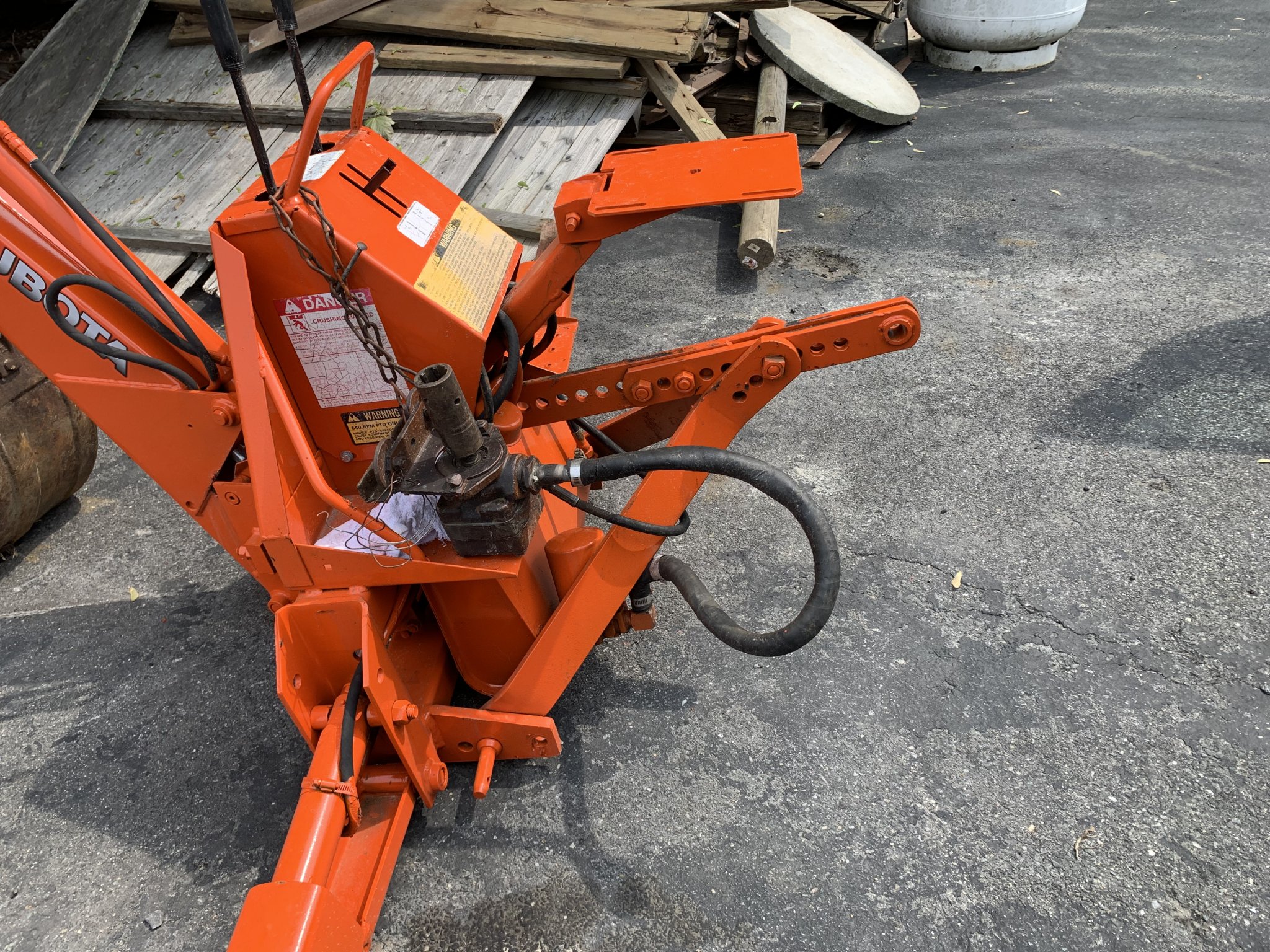

I agree with Henro. I do not think that is the heavy duty top link bracket. That backhoe was made by Woods equipment co . It is the same as a Woods BH750
I have one subframe mounted on a B7100. I can get you a PDF copy of the Woods manual if that would help..

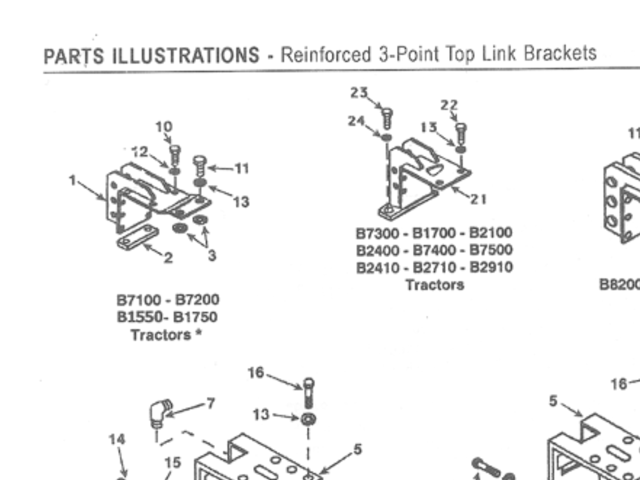

The B8200 heavy duty top link bracket is the top right one. You can see how it wraps around the 3ph lift cylinder casting and distributes the load better with extra meat and mounting bolts

I forgot to say---- That is one fine looking B8200 tractor!!
Obviously well taken care of. With the optional power steering.

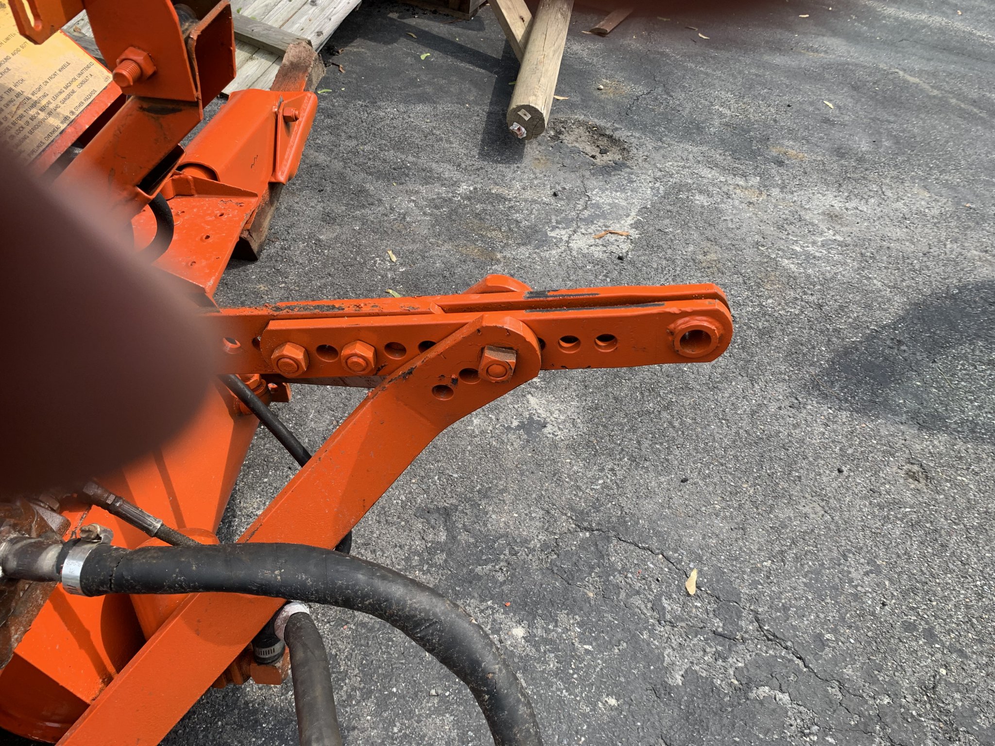

More pics, here is a better pic of the 3point arraignment currently on the backhoe
. View attachment 64193
Huh. Well that's definitely a 3PH mount. No sign of a limiter bar or provision for one. No sign of the mounting kits shown in the parts diagrams on kubotabooks. I agree with kubotasam -- that looks like a rebadged Woods BH750. His PDF of that manual is probably your best bet for information.
No sign of the seat, either! Is it included but just not in the picture?
