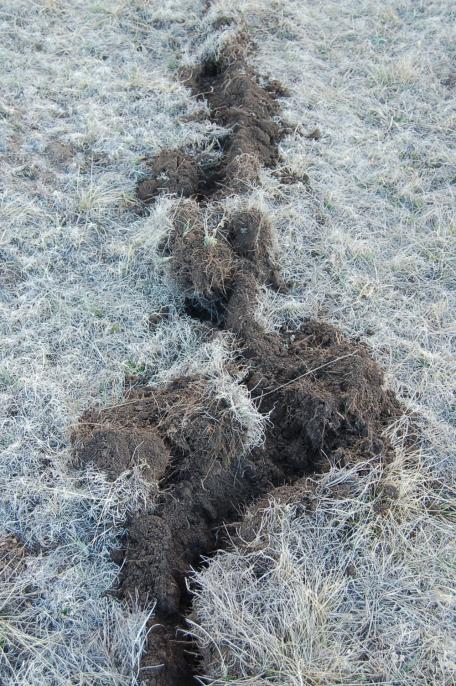

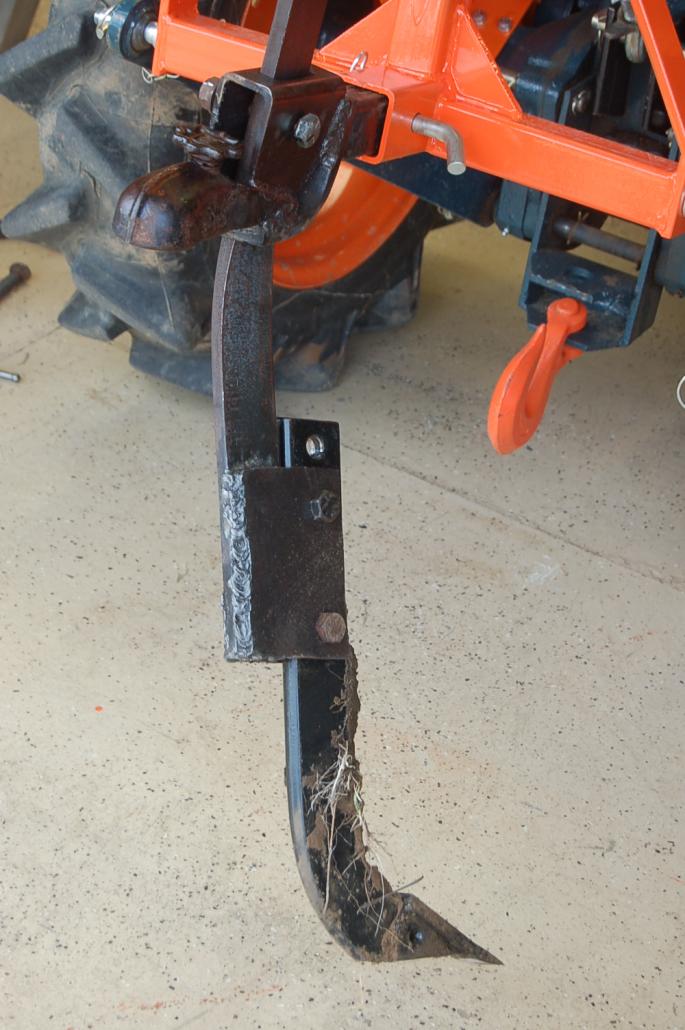

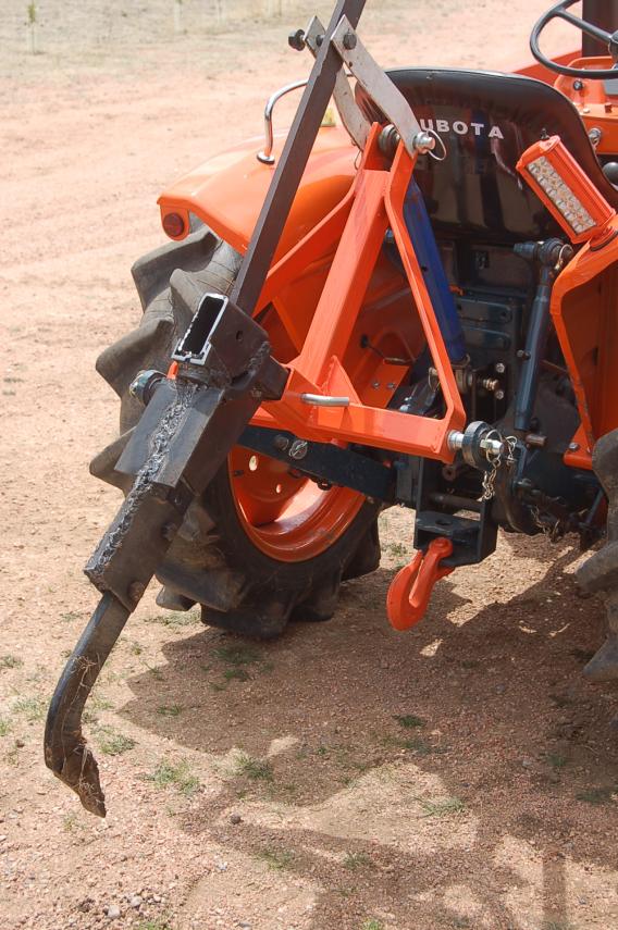

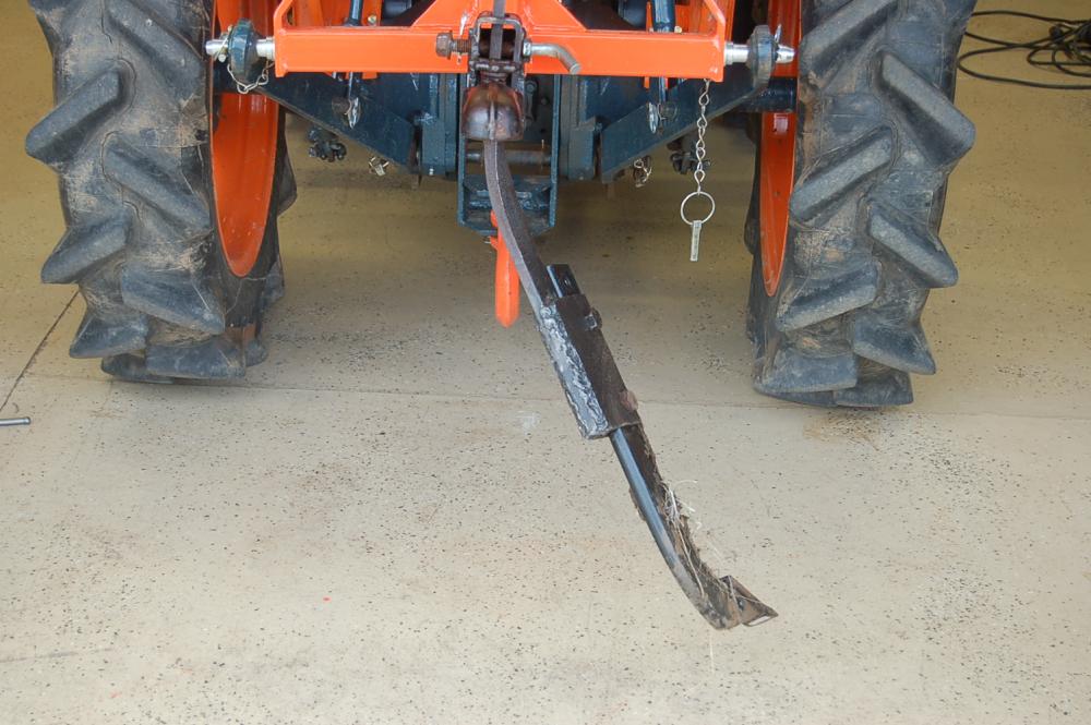

Did a test run and
1. Could not get it to pull down more than about 14"
2. Tried a couple of small turns and the bar folded over, was fine in a straight line
and this was in soft almost garden soil
I wanted the bar to be adjustable, so far only put one bolt hole,
but now I think... No adjustment and beef it up :confused:

The furtherdown it goes the more you need to increase angle? Unless you are hitting a hard clay that wont cut. Maybe some weight will help.
34,959
10,227
You need to shorten your top link, to get it to dig deeper. ;)

Be careful with this one. I bent it in the first 15 min of use on the back of an MX5100 a few summers ago. Took it back to TSC for a refund. Bought a Fred Cain. Built real tough. No problems now.

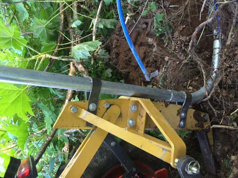

I bought a subsoiler and used a piece of 3" galvanized pipe with a 90 degree sweep at the bottom. This feeder tube was attached to the subsoiler with welded and bolted 1/2"
strapping.
I do several runs along the route to loosen up the ground then pull the wire through feeding down the tube.
Used this to bury 500' of pex and 150' of wire.
I have photos but can not post them ( need to learn how on this site)
