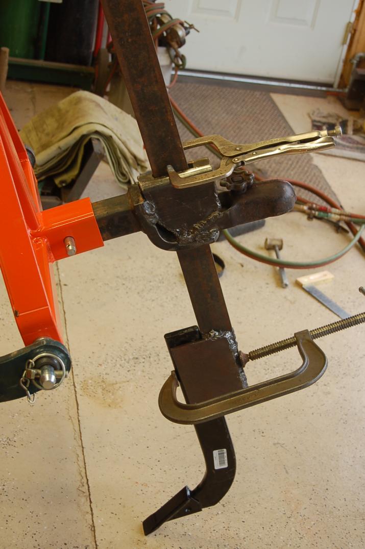

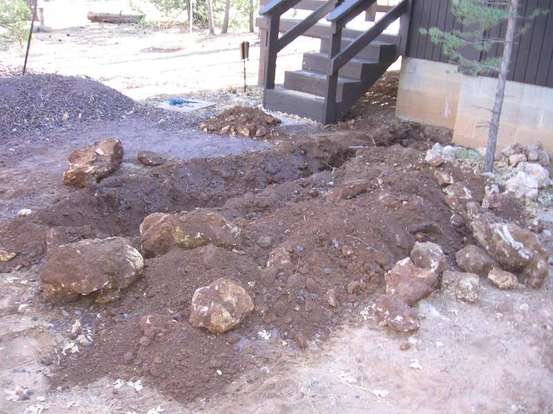

I was planning on running 220V to the shop and needed a trencher,
I have already hand dug around my well pump line so I am ready to go.

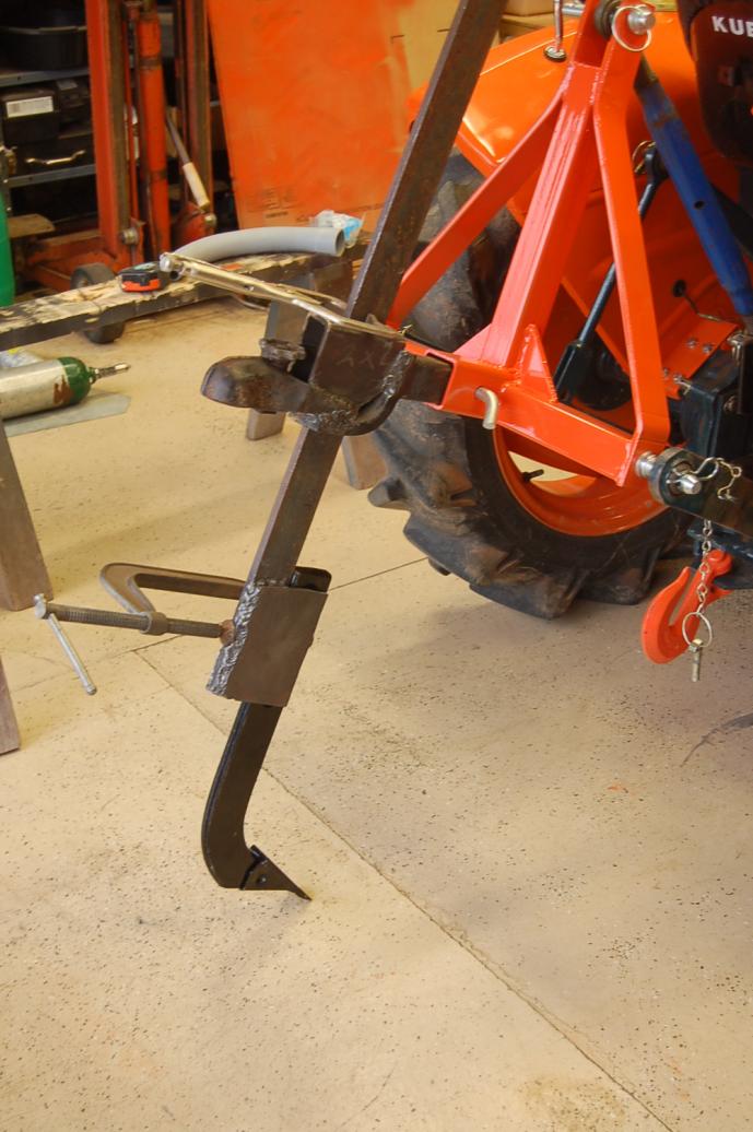

Looked around and found some metal lying around and got to work, I think this will work
It will hook to the FEL Bucket via the 2” ball hitch and have either solid or
chain upper supports going to the bolt on hooks.
I wish I had a back hoe to attach it to. :D
I will also add a pipe laying attachment to help drop the wire
to the bottom of the trench. (something like this)
Got two hours into it so far, I think I can beat the 2 weeks! :D
Comments / Suggestions?

Looking at that - the premise is fine.....I think I would use the three point rather than the FEL, you could end up bending that flat spot on the FEL, one large rock or root.....
The 3 point is built obviously with 3 points, all three have been built to take a little abuse. The bucket being forced up or down might bend that flat spot.
Like the idea a lot- just hope it will not hurt the bucket!:)
15,224
4,430
I have to go alone with brother Hokie on this one.. Just MHO
14,632
7,100
Bill, How deep you plowing the wire? Your beam might be too light weight! I would think, even with no codes, you'd want the line at least 18"-20" min. so you would drive a "T" post in it some time.
Concept is good, you just have to dig deeper into the bone pile!
I will look into the three point route, Possibly utilizing the 3-Point receiver...
was thinking I would get more down force with the FEL
Shooting for 24"

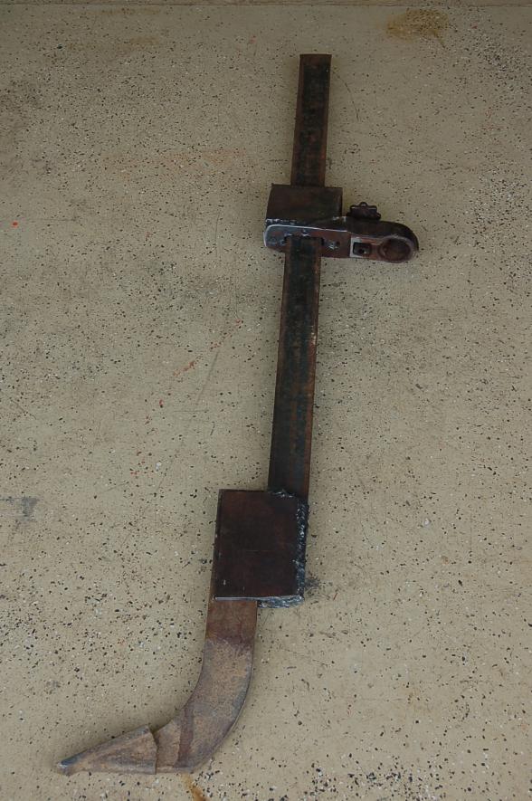

OK, I have made it to REV. 2
I left it so that it could still be FEL mounted
because it was easier than starting over :D
Still need to add a upper 3-Point attachment,
and I grabbed a new ripper shank,
so I do not have to rob the box blade when I need this.

I'm watching with interest to see if this works. I know it wouldn't work where I am, this is about the smallest setup that would work here.:D

Tip for teens .... Run 2 passes along your lay route before trying to run the wire. That way you find the big rock/root before you have wire in the ground. It also loosens the soil to make the going easier.
One more tip ... the subsoiler is designed to dig itself into the ground. When you set it up make sure you set your toplink so the top is just slightly tilted forward and it will bury itself to the limit of your 3pth.
We buried 200' of 1" field pipe in 30 minutes including coupling the 2 100' lengths together.

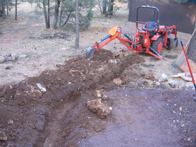

WOW, where do you live the Rocky Mountains? LOL :eek:
When I hand dug around my well pump power cable
12 inches deep close to the house WTF, :mad:
3.5 feet close to the wellhead the biggest rock I found
was about a half an inch.
And I'm staying away from the trees.
BTW, that looks like something they use up in the Fairplay area at about 12,000 feet in Park County

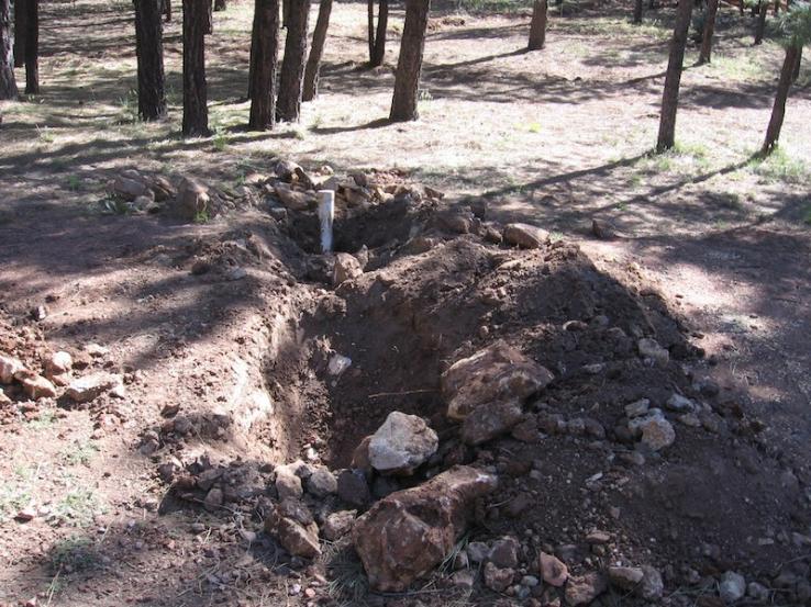

7,965
3,265
I live just outside Phoenix, but I have a place in the high country where the tractor lives. Sample pics:

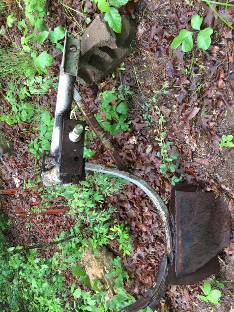

Yours is a lot prettier than mine. I use mine to pull up dead stumps sometimes. (The
gadget is flat on the ground - I rotated the picture )
