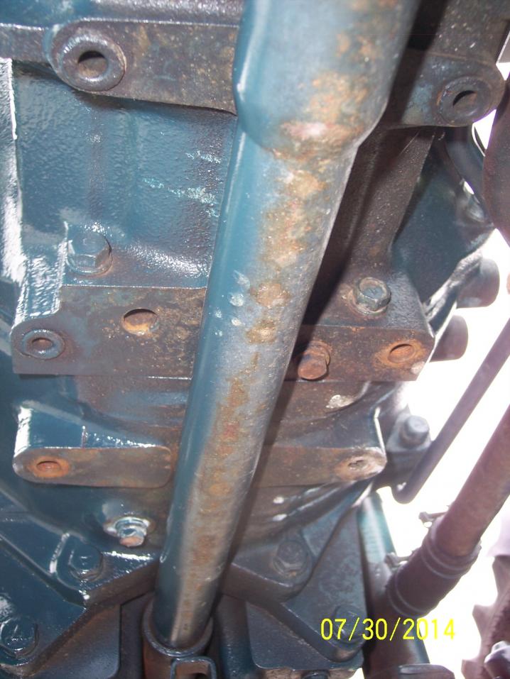

Bucktail, I have some pictures on my computer, and there may be some on the forum of the brackets I made for my L305. It has a Massey 1246 loader. I had to make the brackets that bolt to the side of the block, then cross under the engine to get to the other side. It's 4x4 so I had to have spacers to get it all below the drive shaft.
If you want, I'm sure I can come up with some pictures that may help you with some ideas.

Here's a few pictures for reference. I put a piece of square tubing parallal to the drive shaft to attach the bracket going under the tractor to.

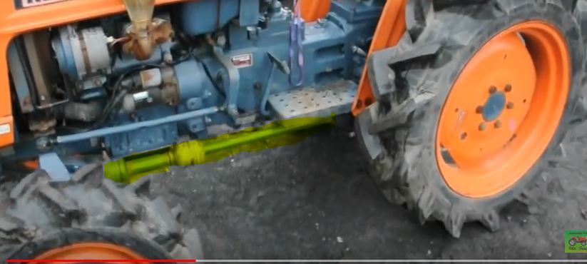

I know what your saying, your issue is because the front drive shaft runs down the side of the tractor and not the center.
Well you should still be able to attach axle bars outside of the shaft.
If not go down the center with them. ;)
Well dang, I was figuring it went down the center underneath like most other tractors. :rolleyes: I wonder if the engineer got fired after that mess, or worse :eek:

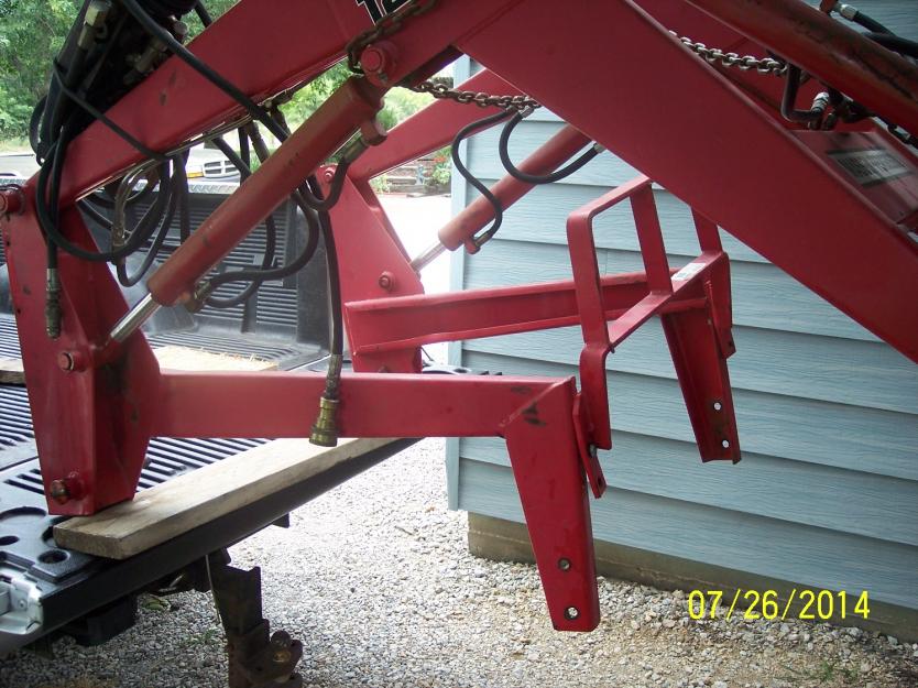

So the front bracket is just going to be a matter of unbolting the bumper and replacing it with the bracket. The back is going to suck. I need to figure out how to post pictures.

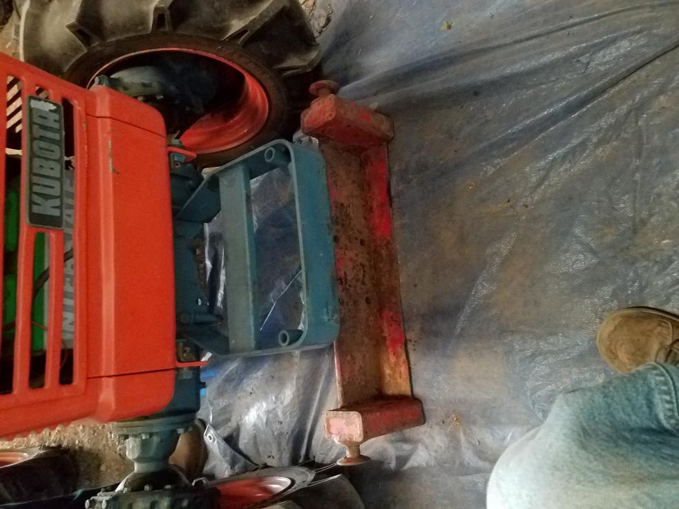

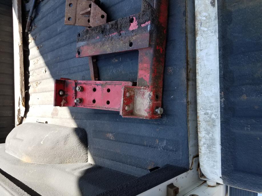

So if the attachment succeeded this is the loader I'm working with. The hooks on the front can slide back and forth on u bolts

How does the width fit your tractor? There can be some variance, but you tractor HAS to fit between the arms!:D:D
It's wide enough. The seller measured 28 inches between the booms . That might have made me move the muffler but I measured it over 30 so I should be okay

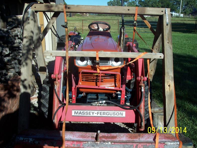

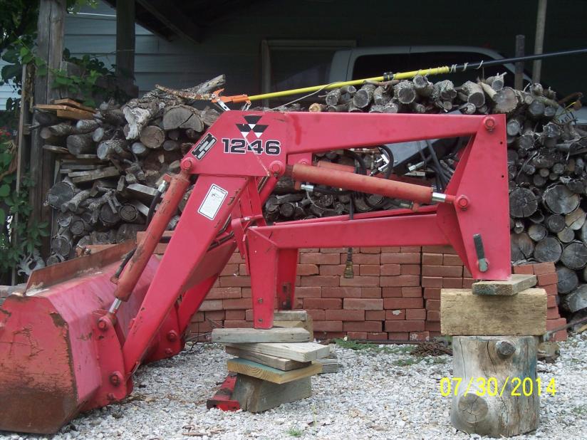

I got some cribbing and set the loader towers on that and then the front of the arms with the bucket flat on the ground. That was a starting point. I eventually built an A frame to hold it all while I could pull the tractor in and get measurements and ideas.
First two pictures are when I was unloading it from my trip to Beebe, Arkansas.
