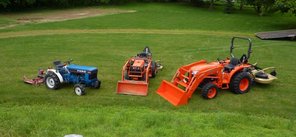

As mentioned, there's an increase in "beefyness" with each step. There are a couple pictures below to show that. The picture with three tractors shows the B7500 and L3200 sitting side by side when the L3200 was delivered. I recall thinking WOW, look how much bigger the tractor is. The front axle was huge in comparison.

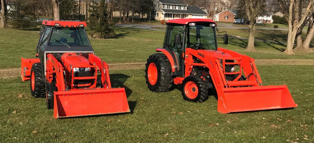

The left picture is of the L3200 with the home-brew cab beside the L4240. The L4240 made the L3200 look a little scrawny.
Loader capacities are roughly 600# on the B7500, 1/2 ton on the L3200 and a ton on the L4240. Remarkably, the L4240 turns a 17" smaller circle than the L3200.;
