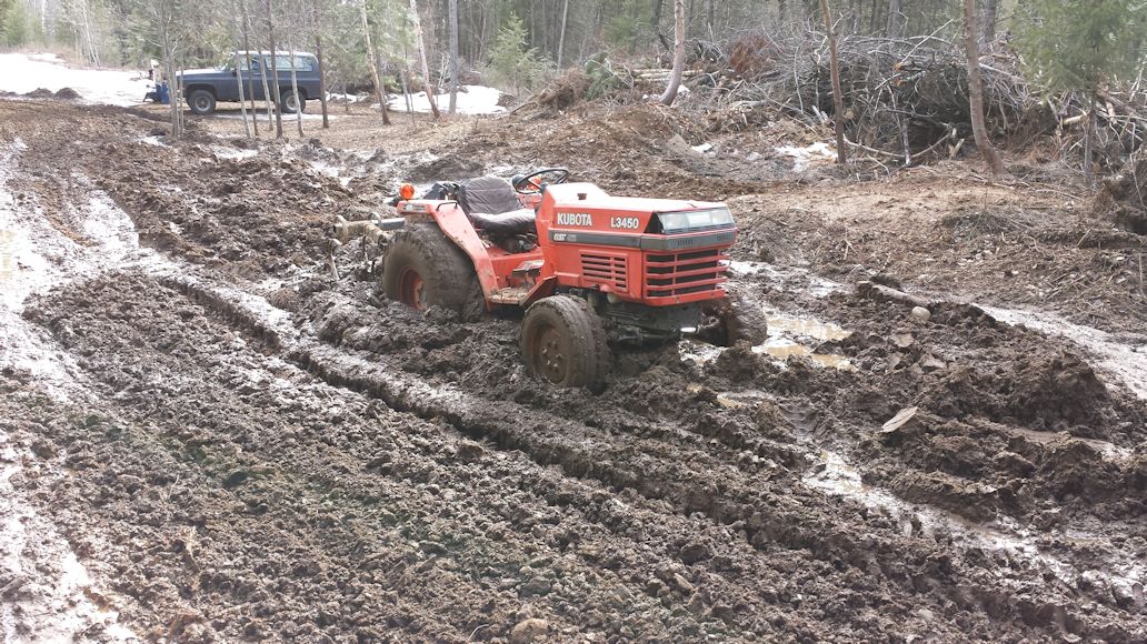

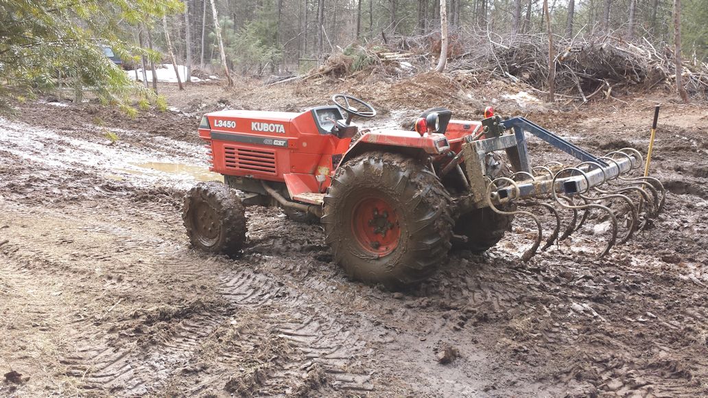

33,355
8,678
Been there done that, it did drive out under it's own power!
