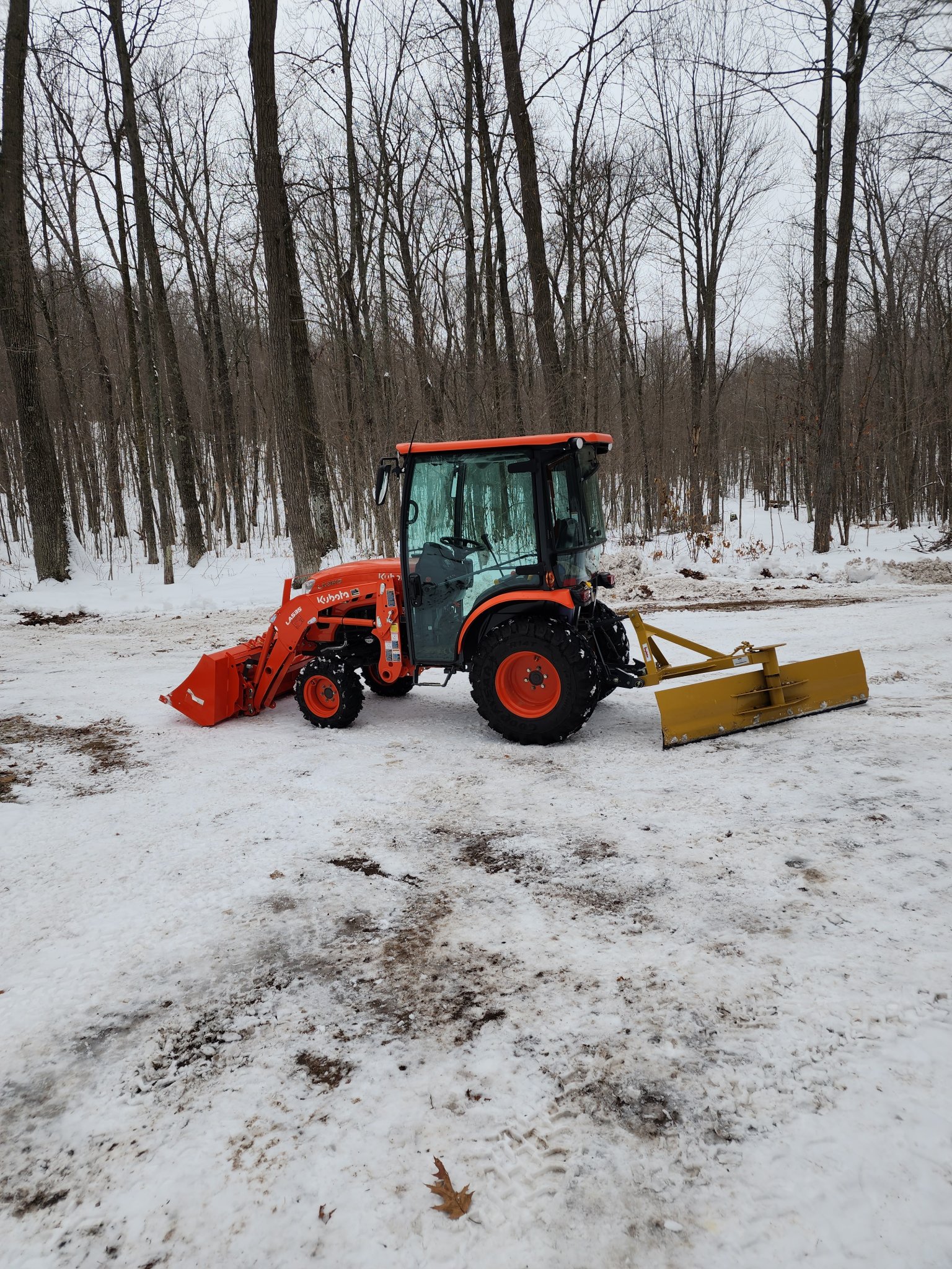

Last winter was really bad in NW Wisconsin. 5 and 6 foot drifts over my driveway in places. I also used the loader with bucket. And a 72" rear blade. I too wished that I had a rear mount, rear facing snow blower. I will be ordering one soon. No chains. Rear tires not filled. R14's worked excellent. Got her stuck twice last year. Winched her out.

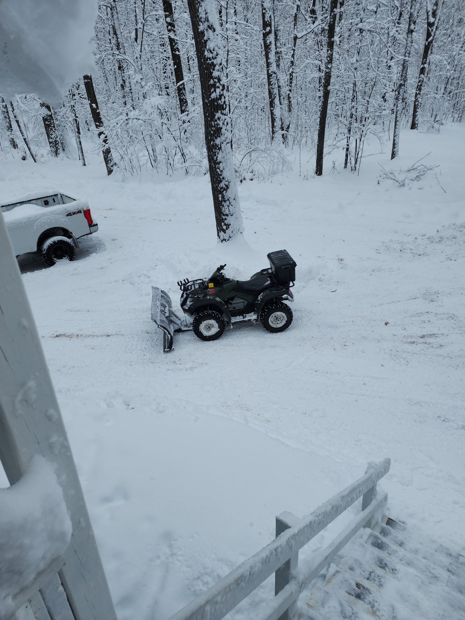

I also prefer
to use my ATV w / plow under about 8" of snow. It's super fast.

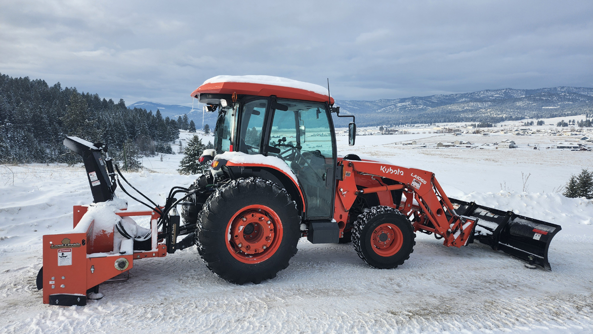

I feel your pain @Foxrunfarms. Having the right equipment really helps, along with living at the top of hill. I always push snow downhill, but blowers are amazing and I would pick a blower over a blade if I had to choose.
Blowers and blades are expensive, and it's hard to justify the investment unless they're used a lot. I use the set up shown below regularly between October and April, so it was certainly worth the price of admission. There isn't any kind of snow event I couldn't handle with what I have.

I also prefer View attachment 120773 to use my ATV w / plow under about 8" of snow. It's super fast.
Nice to see another Wisconsiner.......I'm SE though. Just near the IL boarder. My inlaws have a cabin " up north" in Mercer though. Glad I'm in the same boat. I'm not on here much but see you respond/give very good accurate advice.
The four wheeler is fast, and doesn't seem as much as a chore using it.

@Foxrunfarms , Thank you for the kind words. We could do a fish fry friday if you were closer. And, yeah, I agree. An ATV plow angled just right will not just push, but actually throw snow at speed. Depending on how wet it is.
The King Kutter blade I got at Farm Fleet, and it was inexpensive. It's been good so far with no complaints or breakage. 2 years. It is difficult to adjust the angle sometimes as the angle pin gets frozen solid and wedged in. Poor pin design.
But considering it's price, it been worth it so far. I did scrape a tree with it hard last year and thought I bent it, or my 3 point. But after checking, the only damage was to the tree bark.

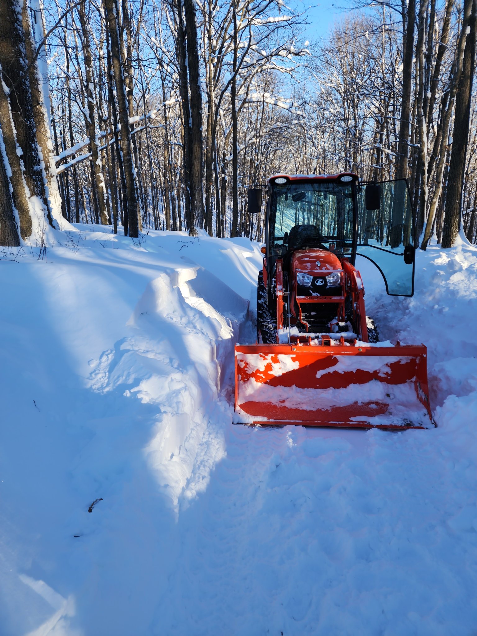

We've had barely any snow this year, but we did have 2 ft drifts in the driveway. I moved those with the loader and rear blade. Usually, I just use the Polaris Ranger.
A few years ago we had a total of 3 ft at once. 12-14 inches and then 2 ft more in 24 hours. I had cleared the 12-14 for the most part before the 24 inches came. My strategy to deal with that 24 inches was to keep up with it. I only had the Ranger since I hadn't bought the tractor yet.
I put my rear chains on a few weeks ago just in case. That's probably the reason we haven't had much snow. :D

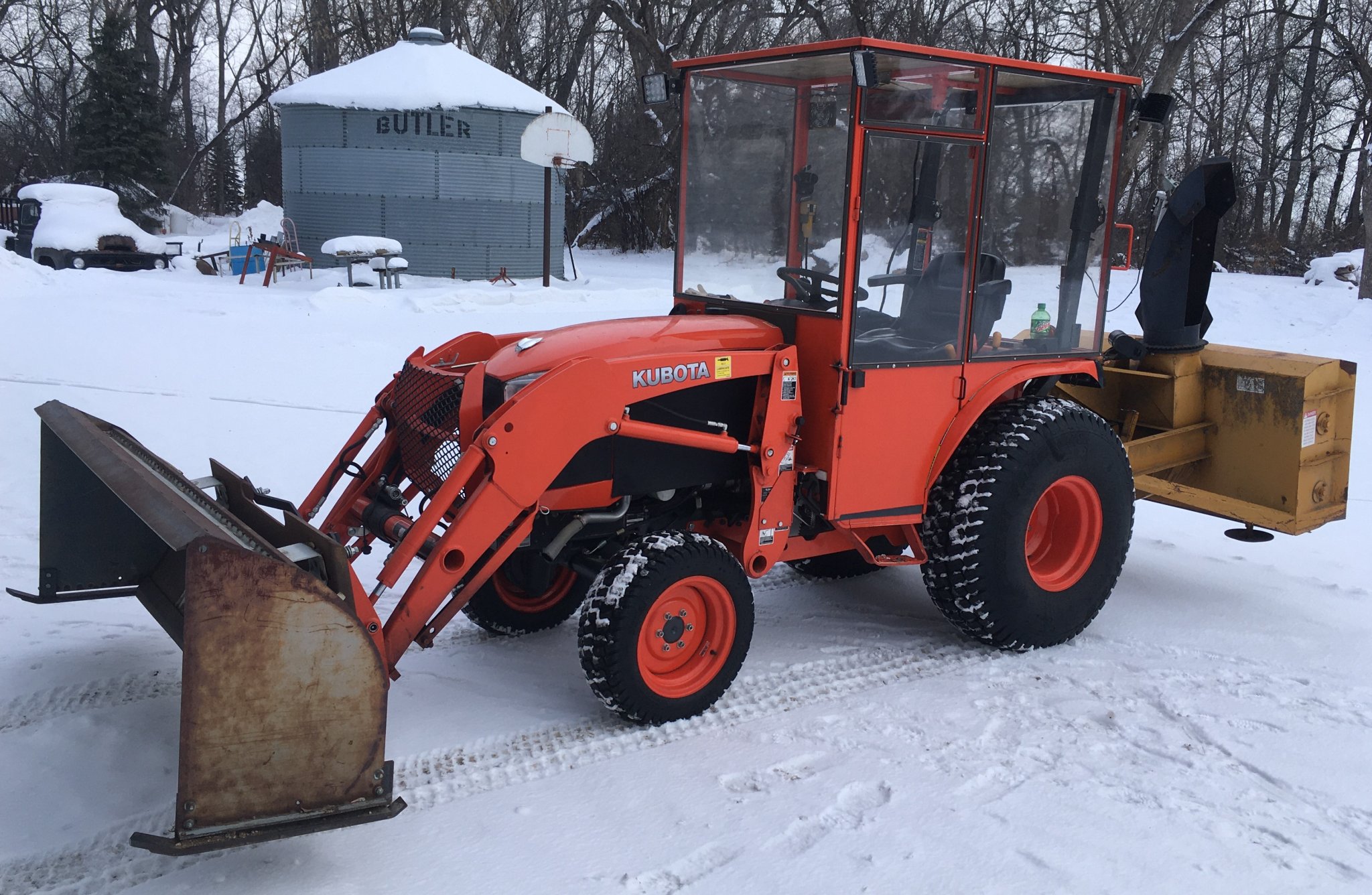

Here's my snow removal beast! :ROFLMAO: Complete with homemade pusher blade and removeable heated cab just for winter duties. My snow blower is now about 30 years old and on its 2nd tractor. That's one big advantage to the 3 pt blower in that they're not tractor specific for the most part. This blower has been trouble free now for all of those years, but I'm going to start replacing a few bearings as I can tell they're getting a little dry. (greaseless bearings) so even what might be considered expensive up front....over the long term this blower has paid for itself many times over.
The pusher blade is no beauty, but was made from some scraps attached to a blank quick tach plate. If we have light snows, the pusher does all the work quickly with the blower providing ballast for traction. I use the standard turf tires (no fluid within) and am impressed with the traction in snow. Glare ice is more of a problem, but would be no matter what the tire unless you have chains.
The large horizontal mirror makes blowing in reverse a piece of cake. You can see it up high in the middle of the cab. If you can back your car/pickup using its mirror, you can easily blow snow in reverse using this setup.
I agree with the others that a blade, especially a front pusher blade, makes short work of clearing snow most of the time. But when you need to break through drifts or deep, heavy snow.....nothing beats a snowblower. Most of the time it might be just ballast for traction. the other times, it's worth its weight in gold when your blade won't suffice.
The canted "paddles" on the double augers on this Lorenz blower will chop through the hardest packed, wind driven snow one can find. You probably won't see that much in your area though.
If you'd be interested in fabbing up a cheap removeable cab for winter duties...message me.
