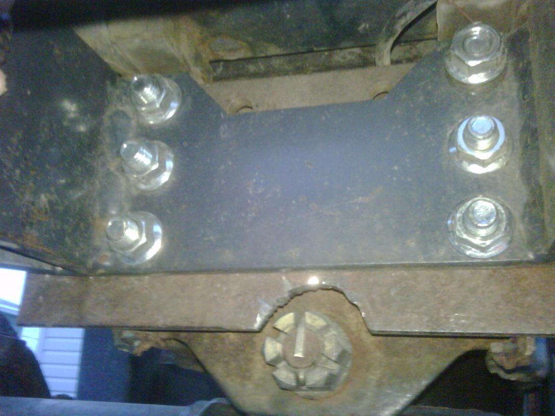

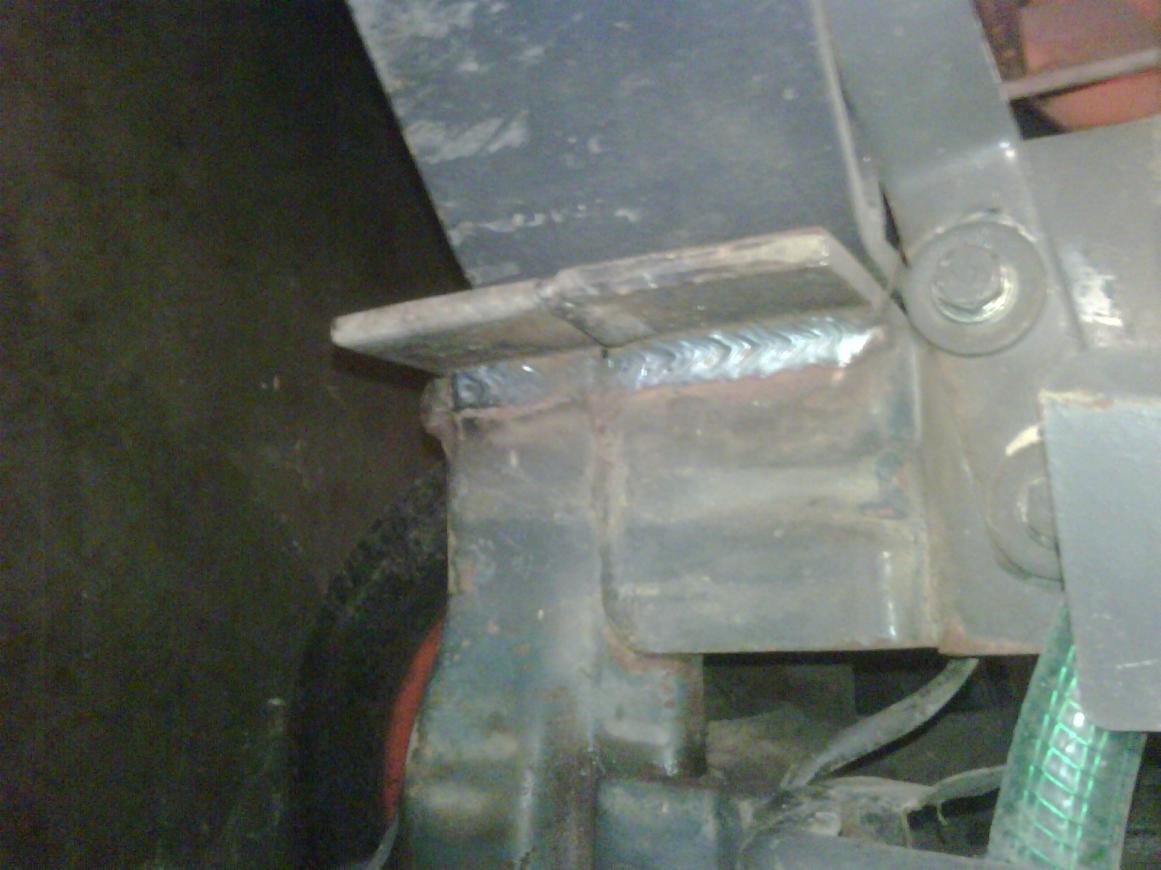

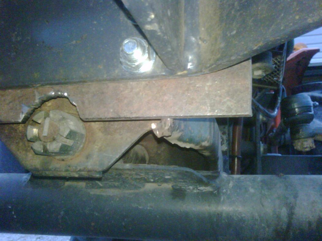

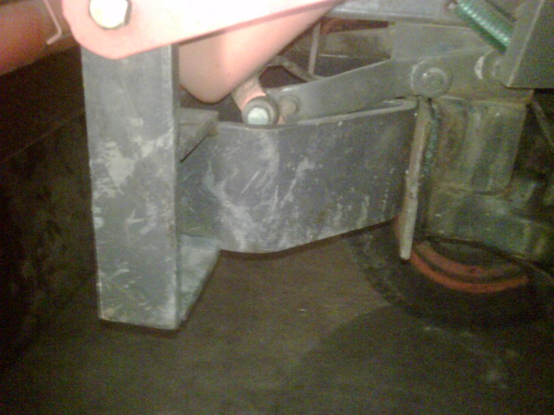

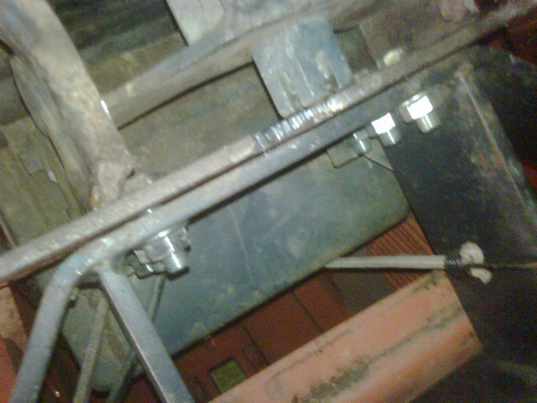

I bought my tractor for a deal bc it had this similar problem.
We fabricated a brace out of 1/4 inch plate steel and welded it on to the frame.
Drilled the holes and spot welded nuts on the back side.
I will post pics tomorrow.
