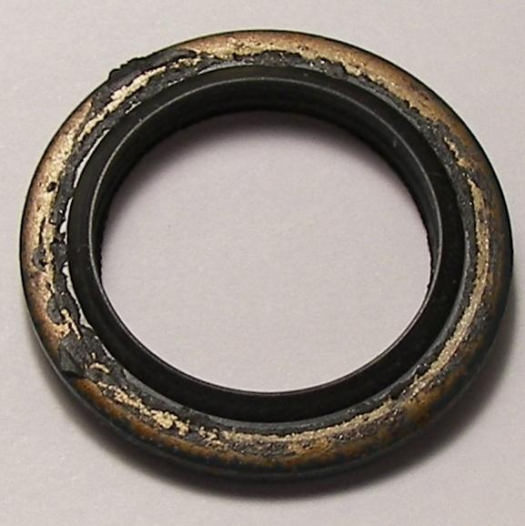

Ok guys, this is my latest update on my 245DT tractor issues,
1. drained the fluid from transmission, all 4 places too.
2. Found very little metal shavings after I ran a magnet through it, no more than I would think that would be normal anyway.
3 After draining the final place which was the one under the bottom of the tractor under the seat, this little gadget was in the oil from that section. It round 1-1/4" overall dimension with a 3/4" hole in the center, it had a rubber seal around the center also. Any ideas what it came off of and where it goes, I guess it related to my problems, but still puzzles me with so little metal shavings, thought there would be more.
Help Guys, I'm at a lose to figure where it goes, going to remove the speed change cover under the gear shift lever and POT lever, trying to leave as much in tack as possible. Hope fully I will be able to see better down inside the transmission that way.
Thanks, I appreciate the help.

Looks like sealing washer off the drain plug. That will not fit through the drain hole will it?
Lance

Looks like an oil seal, meaning a shaft seal, are you sure it wasn't in the drum you used to drain the oil into? Otherwise have a look underneath at every shaft and work out where it has come from, does your tractor have a mid pto with a shaft that size?
6,139
1,879
I think there may be a way to determine if it is a seal or a sealing washer. I think if it is a sealing washer it will look very similar on both sides. It looks like the side shown has a protrusion at the inner diameter. What does the other side look like?
Search for “dowty washer” and see if that is what you have. That is another name for the sealing washers
I think you're on the money Russell, I should have clarified my thoughts, as I was meaning a dust seal, which sits in front of an oil seal, but still think you're likely spot on.
