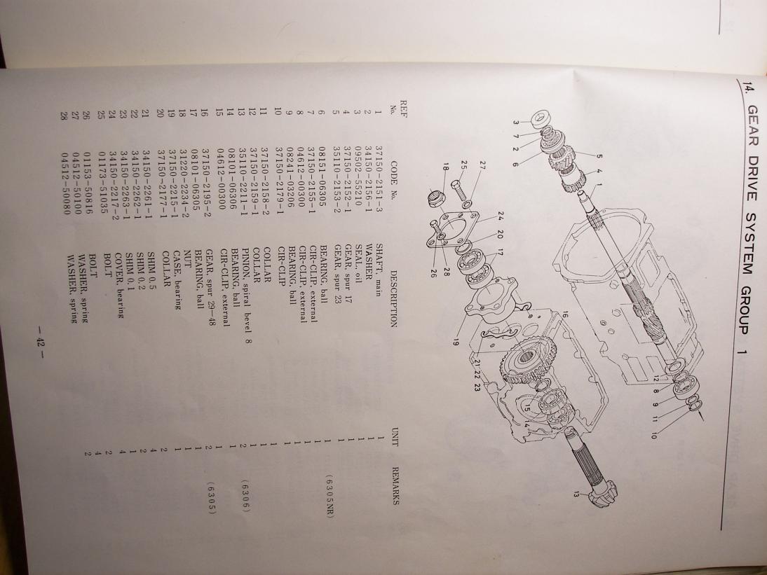

Russell King, there is nothing listed as a “dowty washer or seal” in my book, I’m sending pictures of the Gear Drive System Groups 1, 2 and 3 for yawl to check out, this is from my original manual from 1977 when I purchased the tractor; they show everything and list name and part numbers. This tractor was made in Japan; just about everything I need when I have needed something has to be ordered if available. Both sides look the same and the rubber on the inner diameter does stick out about a 1/32” on both sides also. In my opinion it had to come from one end of a shaft, which one is anyone’s guess.

I’ll attach pictures of my book, maybe you guys can figure it out better than I can as I’m at a lost.
Page 42 is Gear Drive System Group 1; Page 43 is GDS Group 2 and Page 44/45 is GDS Group 3, to me it seems there must be something more that has come off for that washer to come off, just where is it. Do you know of any way to look inside without taking the shifting levers off? On another page it shows a cover plate on the bottom in front of the rear wheels and oil filter that looks to be about 4” X 6”, think I could see anything from removing it? It about a foot or so in front of the rear plug also.
Sorry about the pictures turned sideways, but only way I could get the whole page into the picture. I appreciate all the help, guys. Thank you.

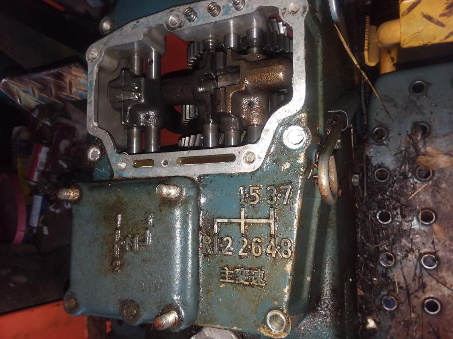

Lance I took a picture of the transmission cover, the 3 bolts on what is the front are out but only got one in the picture, removed 2 from the bottom and one on the top also. I'll put the bolts back on the PTO shift pattern except for the one on the top left that holds the transmission cover on.
Unless I missed something they are all out, but it will not move at all, 40 years is a long time to be bolted down.

Lance, there are 3 across the front,3 across the bottom and one on each side as shown in my picture, except the 2 missing on the top. I have removed all 8 bolts and it still doesn't move even with tapping it with a hammer. I'll put the 3 nuts back on in the morning off the other cover. I just can't figure out why it isn't moving at all seems to be frozen. I even used a block of wood on the sides so it would cover more area when I hit it, can't hit it from the from but I did get a few good licks on the other 3 sides with the wood in place. But I am leery of breaking it as it seems to be case iron, but I'm just guessing.
Not sure if heating it would help or not, thinking it probably would just transfer to the other piece is my guess unless I used a spray bottle with water to cool the lower unit might work. I have done that before but with things that were steel, not case or aluminum.
Like I said, I soaked it with Liquid Wrench, even filled the bolt holes and plan to go down there and soak it again before I go to bed, worth a try.
I'm sure you probably run across this before on old tractors, maybe not 40 year old one though. any ideas?

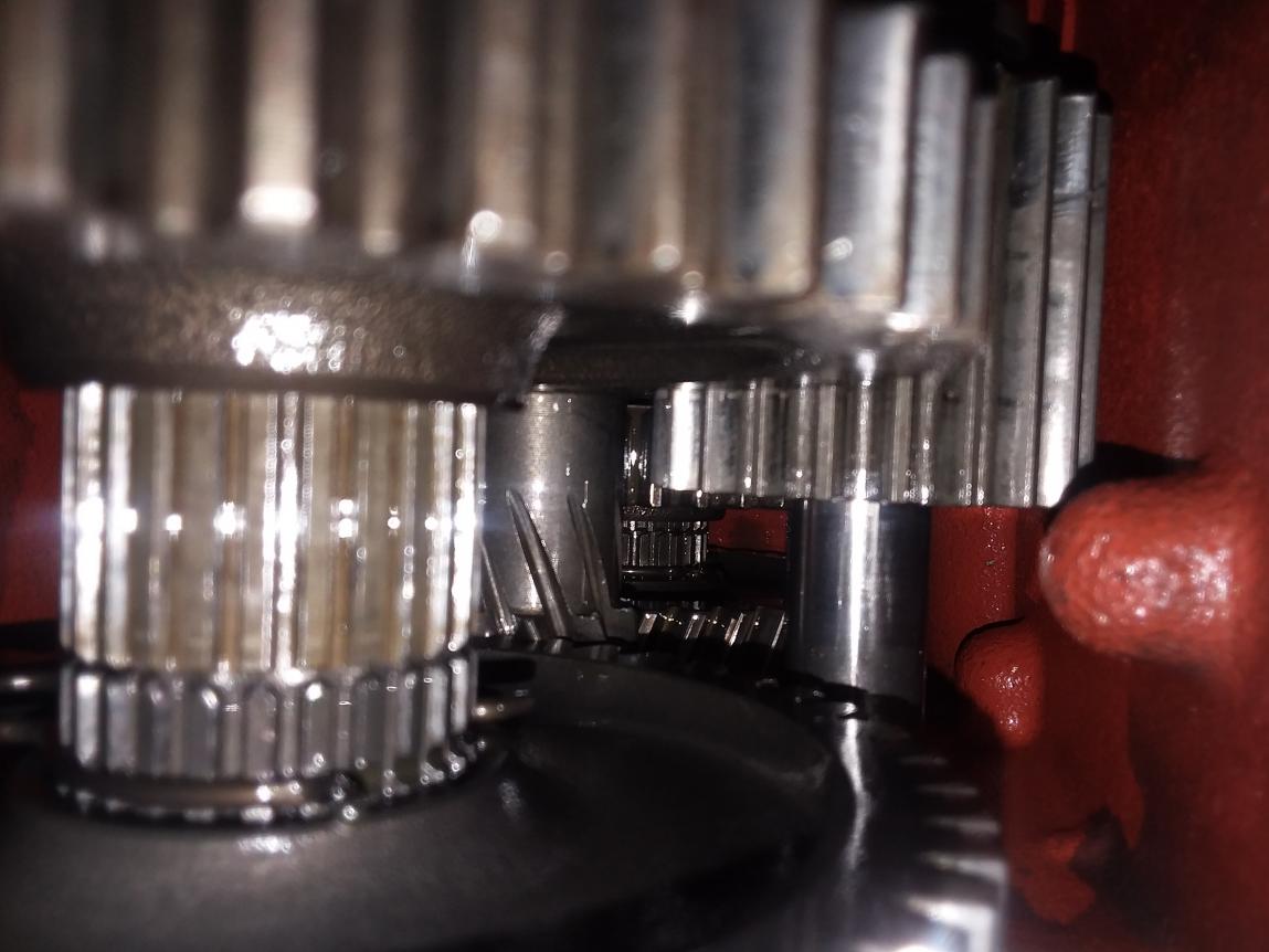

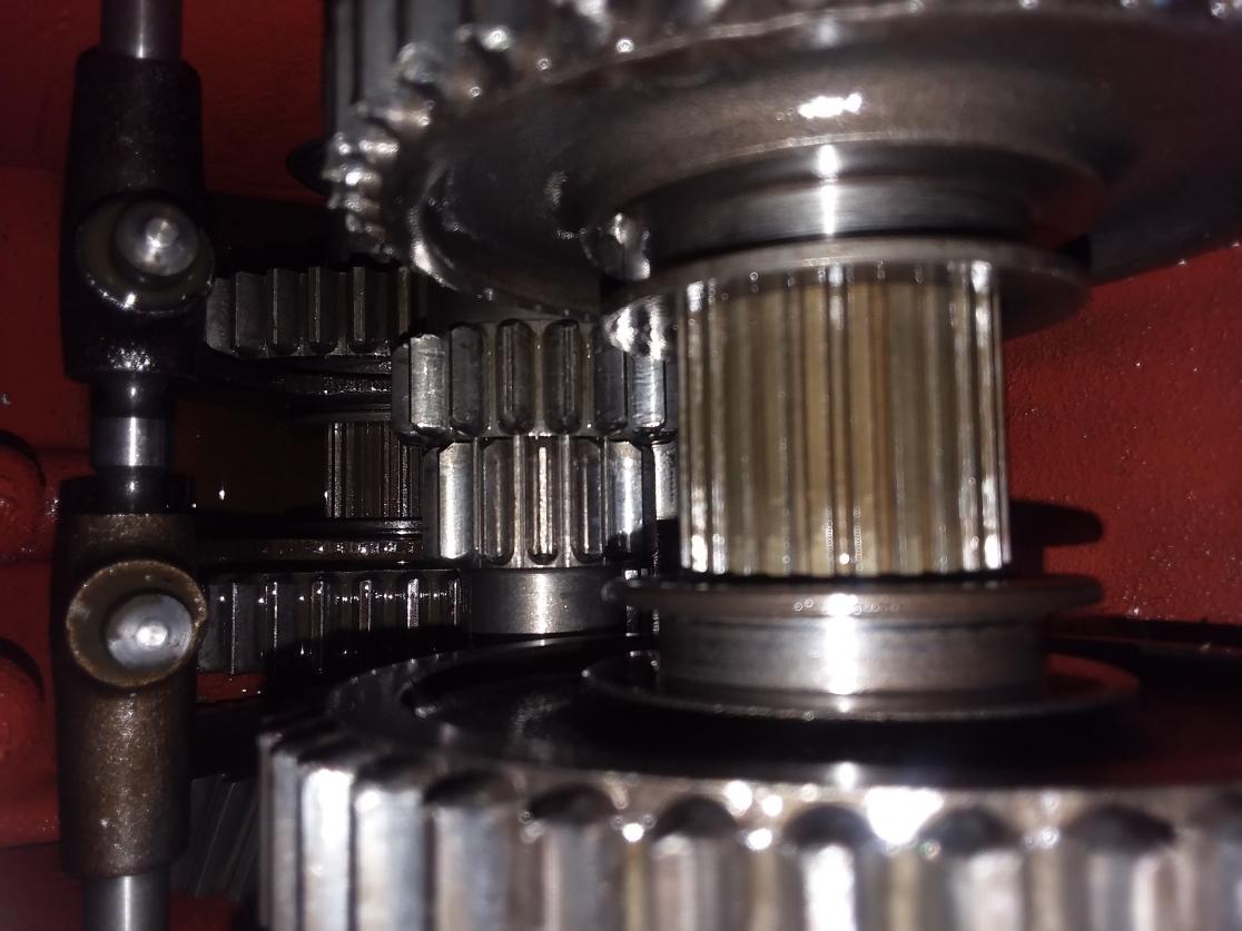

Went down to spray it one more time, I sprayed it with Liquid Wrench earlier today, then right before I came home I used PB Blaster on it When I got down at my shop which is about 250 feet from my house, I thought I give it another lick or two using the wood and a 5 pound hammer, two lick later it popped up and I removed it.

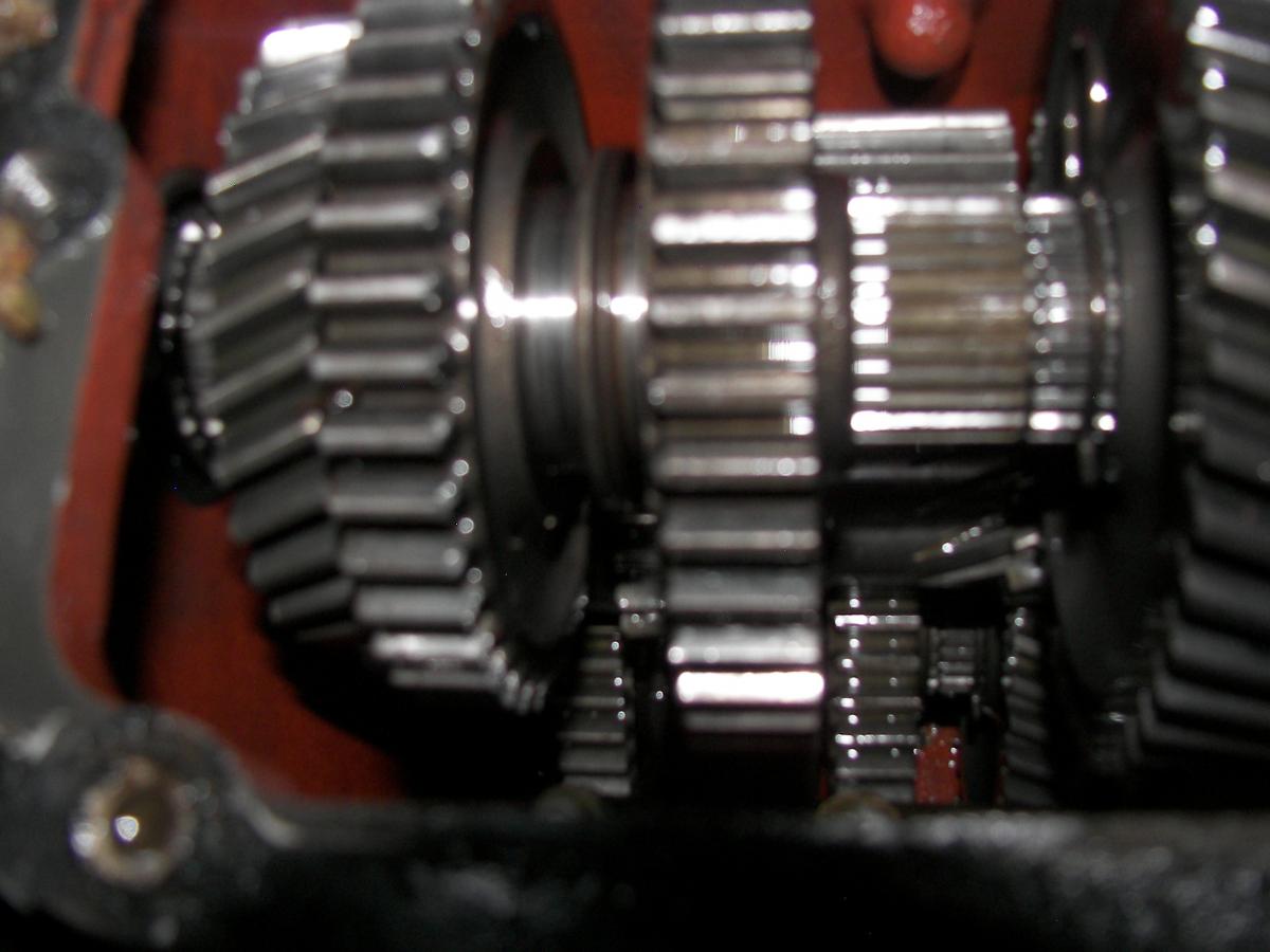

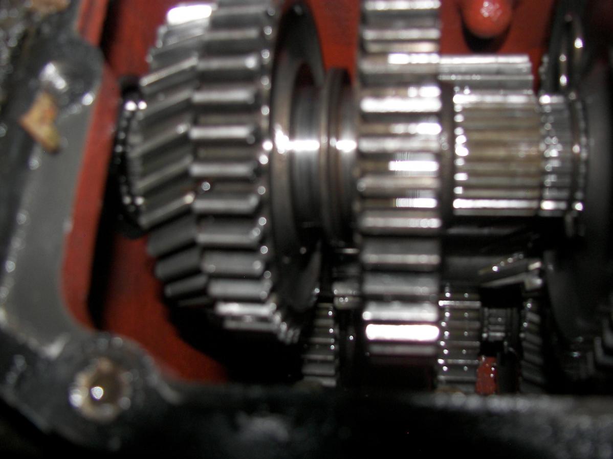

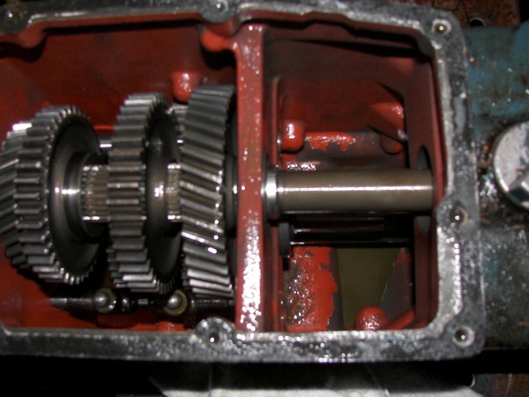

I took some pictures of the inside of the transmission so you could take a look at it. There are 3 rows of gear in a line then one row off to the right side with only one gear on it. It will slide back and forth without any trouble almost, I can move it with my fingers, the top one they have some play back and forth but only a small amount, couldn't reach the other two without using something so I decided to wait till morning when I have more time. I'll post some more right behind this post.
Here are the pictures.
100 td
B21TLB (B21, TL421 & BT751) Toyota SDK4 T116 Bobcat
Aug 29, 2015
1,776
9
38
ɹǝpunuʍop
That 2nd gear from top in 2nd pic, (chewed up gear), that's probably on a lay shaft, you can regrind the gear lead-in on it to repair it, of course you'll need to check the gear that it meshes with to see if it can be ground back or needs replacing. Everything else looks good, but can't see down in box to next shaft/s & gears.

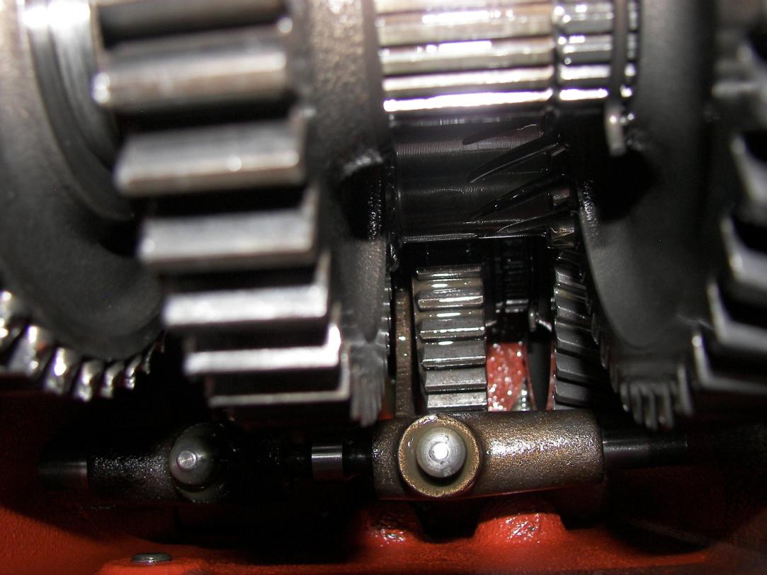

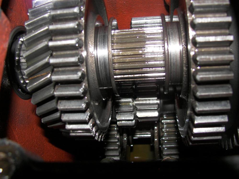

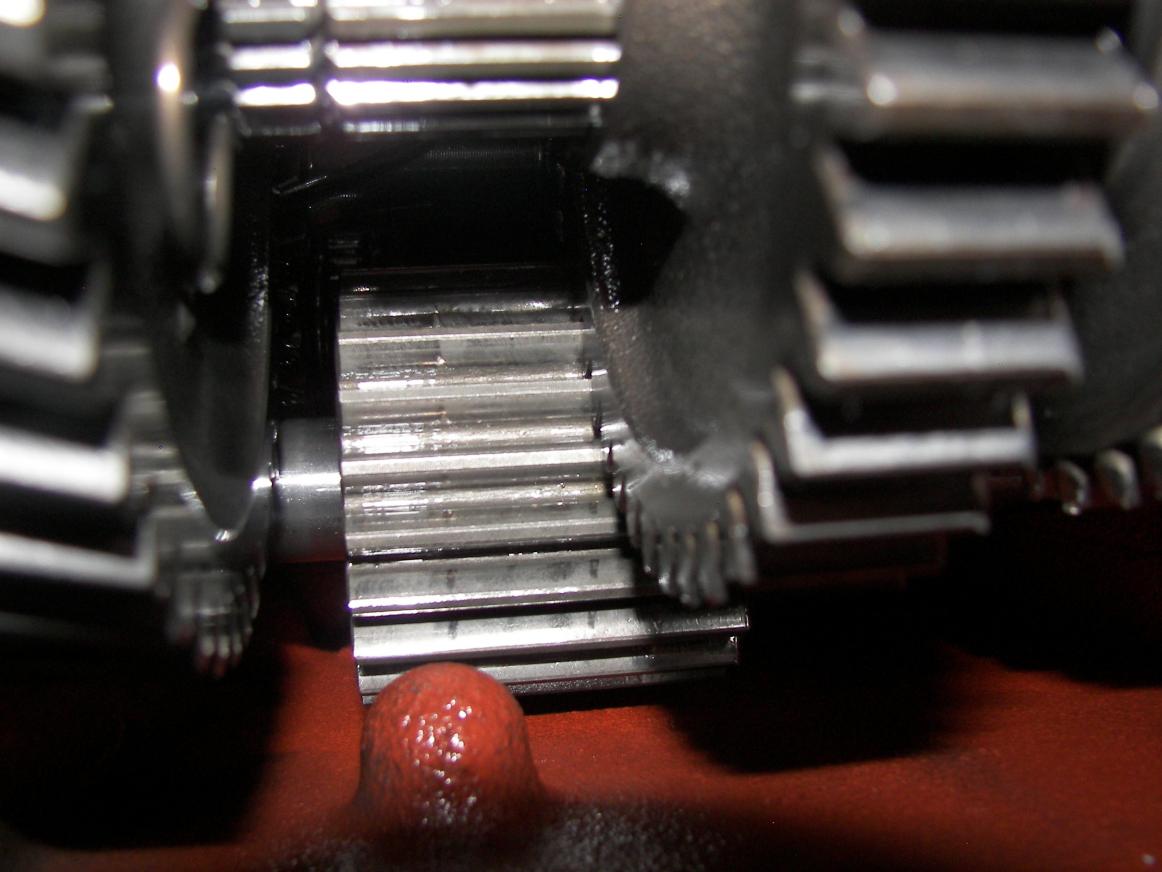

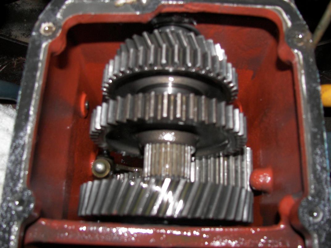

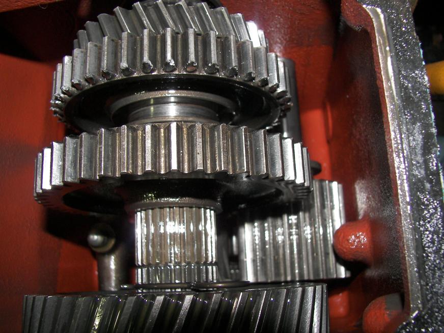

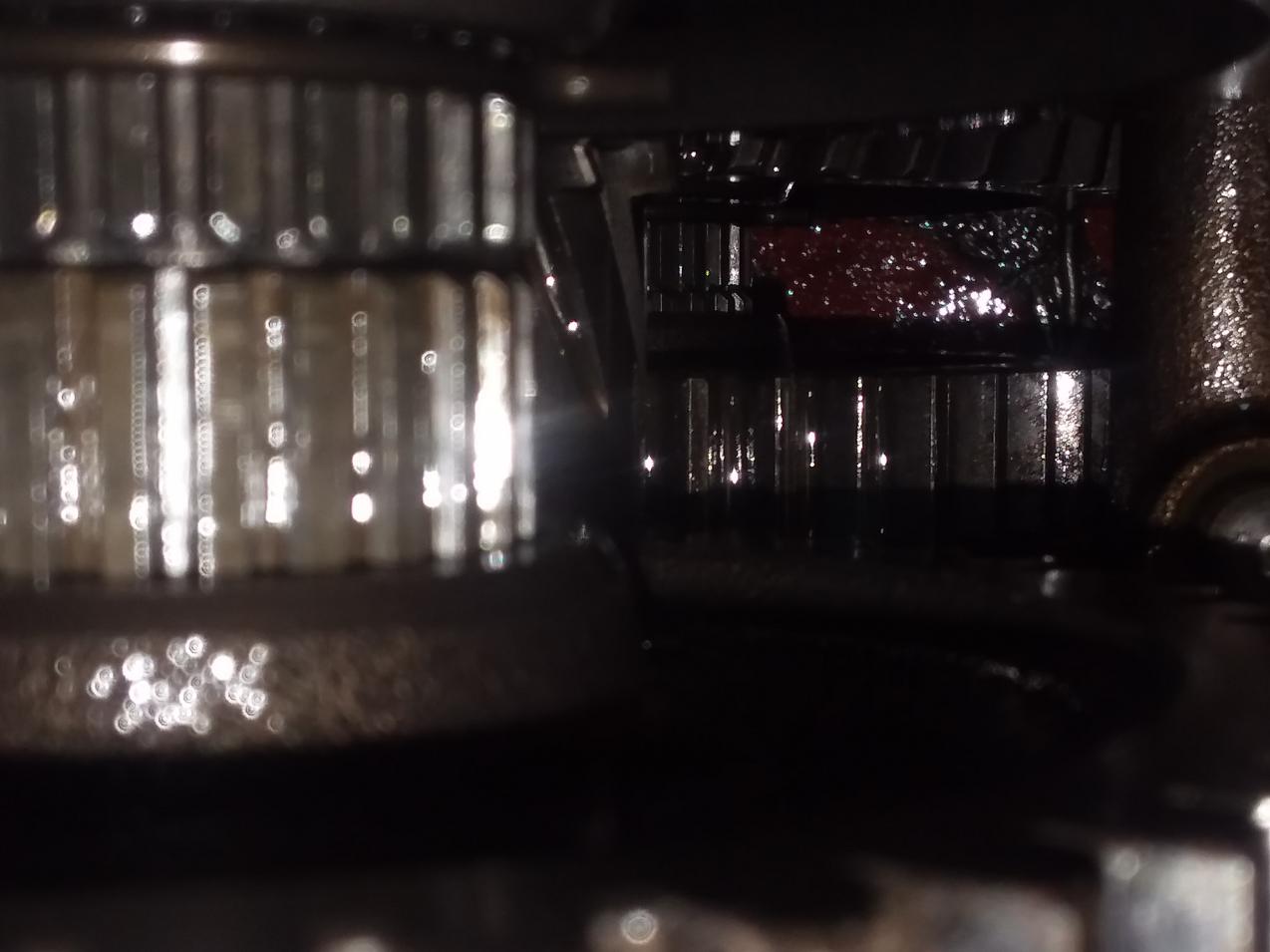

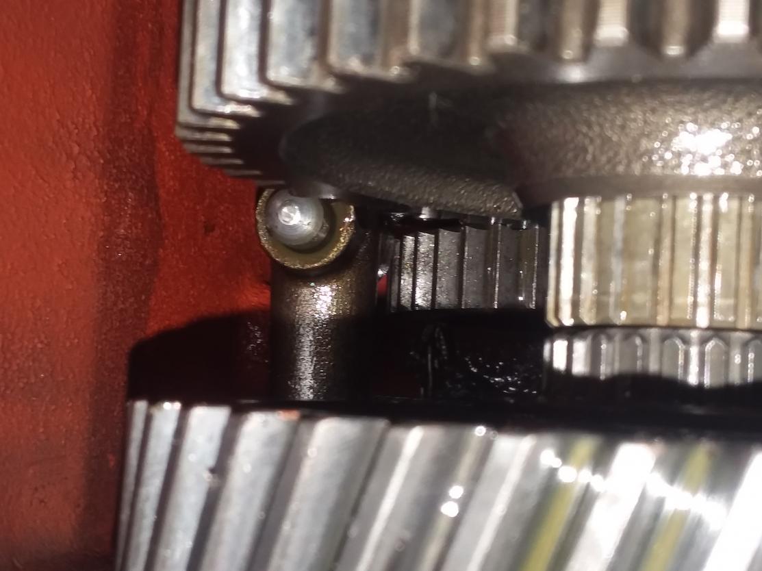

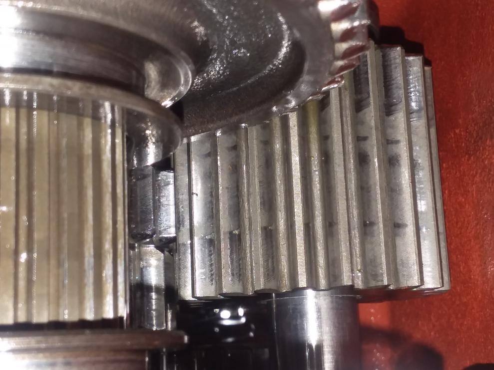

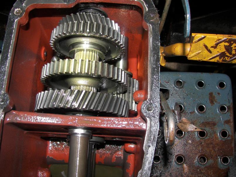

After getting the gear shifter cover off, I started taking some pictures as best I could so I could see better down inside the transmission case. I must have taken over 100 of them, trying to get a better understanding of how this all fits together, first time inside any type of transmission too, so please bare with me if my questions sound stupid to yawl.
I wanted to get a better look at the gears deeper inside to check for wear like 007 td mentioned in his last post. I figure that the worn gear he mentioned is from us grinding gears over the years, maybe or maybe not, yawl know more about wear on gears than I do, but I can grind it I think to make it work or replace it if needed.
1. In picture 4 I noticed something stuck between the gears, with a hook on it, top back of picture. Is that one of the “Cir-Clip” that you are talking about needs replacing, Lance?
2. After moving the gears around it seemed to have fallen down to the bottom of the transmission case as in picture # 8 you see it again on the bottom toward the side between gears. In picture #9 you see it on the bottom and it either broke in half or it’s another one at the bottom and about an inch above it is the other half or one.
3. My question is which one of the 4 shafts did it or they come from? I got 3 shafts lined up one above the other and one off to the right side of them. Maybe you can help me figure out which shaft does what, as looking at pages 42 group 1, 43 group 2, and 44 & 45 group 3, that I included earlier, makes no sense to me as it doesn’t tell you which one is which or what they do. I assume the bottom one is my PTO shaft, top one is 1 & 2 gear and middle one is 3 & 4 gear, the one off to the side shifts between them, I hope I am making sense so you understand what I saying.
4. Lance, do I need to break the tractor in half to install the kit you mentioned? I know you said you do one in 1 ½ hours so I’m assuming you didn’t do that, course we all know what assume means too. Please, tell me which shaft you are referring to also the kit goes on and excuse my stupidity, is it 1, 2, 3 or the one on the side? In the book it seems every shaft has “Cir-Clips” on them.
5. If you need more pictures just say so and tell me what you want, I’ll do my best to get them. Just ask my wife, I follow instruction real well, she is a good trainer. LOL
