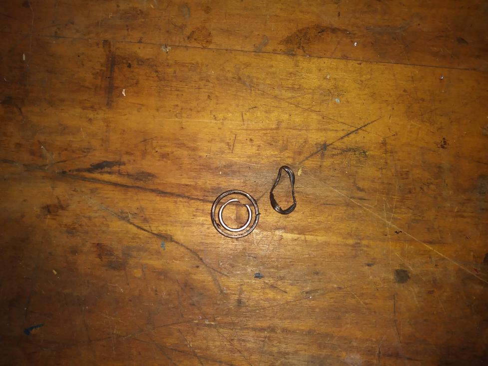

My HSD fwd/rev pedal was sluggish/sticky and would not return 100% to neutral position when released. It ended up being a $20 bearing the diameter size of a quarter and the thickness of three quarters stacked...
See the pics... I have almost 2000 hours on my tractor... pedal works like brand new.... Let me know if this works... Butch:D
One more thing... normally you'd have to split the tractor to get to it... see my thread... a McGiver fix... no split... just 8 hours of my slow labor and the bearing.

I just replaced that bearing... no tractor split and you'll always be able to get to it again from the outside just behind the forward end of the damper.... I will bet that is why the previous owner had the damper loose...

Yes. WSM entails it in depth.
My WSM showed the peep hole where you can see the little bearing inside and towards the rear of the tractor... Based on experience I'd had cut my new access hole to at least 1". and have a Hobby Dremal Tool with a 3/4 dia grinding wheel to cut the inner race (actually split the ring) it will just pop of with a nudge if a screw driver.
I would bet one of my appendages this is your ONLY issue.... had exactly the SAME issue... if you pull up the picture of my tractor torn down... look under the water bottle down and a smidge to the right.... that is where the bearing goes...
