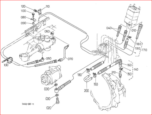

I have a Kubota L3010 HST. I had a steering line rupture. I replaced the line then topped off the hydraulic fluid. Now the steering operates backwards/reversed. IOW when I turn the steering wheel left the front tires turn right and vice versa. Any help would be greatly appreciated.

Did two lines get switched when line was replaced?
Did steering position move when line was replaced?

The only way that could happen is if the lines got swapped.

Like Wolfman said, you crisscrossed the lines when you hooked them back up. Swap ‘em and you’re good to go.

I have done this
Tech got mad and left for a several day vacation, leaving an L3300 sitting in the bay. Boss wanted me to make it driveable so that it could be moved, but said tech was going to have to finish it when he got back. Didn't label the hoses so I just stuck em on where they "wanted" to live. Backwards. Steer right, wheels turn left. Oh boy...the tech is gonna be THRILLED about this. Drove it out and parked it. And trust me here, driving with backwards steering is WEIRD!! Had to go really really slow, even as far as tractors speeds are concerned. Tech got back from his "vacation", got a butt chewing, and then went to pull the tractor in. Boy was that fun to see/watch/hear. The words that came out of his mouth were nothing I've ever heard prior or since--I think they were invented at that moment.

Thanks much for the replies!
No mechanical connection between the steering wheel and the steering assembly.
The steering wheel position WAS moved prior to the line being replaced.
Im pretty sure the lines were NOT swapped during replacement. I say this because only one of the two lines ruptured. So I only replaced one line. Because of the setup it would be very difficult to confuse the lines but not impossible. That said, they only could have been swapped on the steering wheel end (not assembly), which I guess makes sense, because if they were completely swapped then it shouldnt affect the control (right?).
Griz, the rubber stayed down (thankfully! Lol). Though, were it up, only I would be confused...right now both the tractor and I are confused (very weird to operate currently)...but the tractor started it!
May be worth mentioning...but the line that was replaced I had built at a local shop as there was nowhere for me to obtain an OEM line on a Saturday. I cant say for sure but I wondered if the inner diameter of the lines could be different. Not sure what the impact would be other than flow rate.

Well Im on my way to (re)swap the lines and see if it does any good. Ill let you all know.

Lots of fun replies to this. You either reversed the lines or an electrical connection was reversed, and the steering actuator is running backwards, off 180 degreees.

really it's a manufacturing defect....down to some lazy 'engineer' who didn't design it proper.
those hoses (and similar ) should NOT be able to be put on backwards or reversed.

So the OP states he only removed and replaced one hose. Then the steering suddenly reversed.
Either the OP is misleading us, or this is actually the situation.

The steering wheel being moved would not effect operations one bit.
