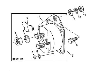

Here's a relay kit JD has utilized on utility tractors for years. In essence it routes a larger wire to the "S" terminal than factory wiring so that the starter solenoid exciter "S" wire gets more amps. The reason I'm mentioning this kit is because the schematic is more explicit than the lawn mower relay kit. All one needs is a relay for older Ford auto starter & some wire. Here's just the relay from JD. RE164448 Starter Relay ADD 25.37 USD

Sounds to me more like the classic headlight upgrade.
Basically, DC voltage drops fairly rapidly over distance in a wire, more so if the wire is smaller gauge. To save money, wires are engineered to be the smallest to do the job, putting voltage at the end within a specified acceptable range, and heavy enough to prevent amperage from burning it out. For headlights, that means that they get say 11V instead of 12V. But they are actually built to provide the specified lumen output at 12V. After decades of use, and corroding connectors (less an issue now than in the past), voltage may only be 10.5V, so headlights aren't as bright.
So folks use the stock harness to trigger a solenoid near the headlights. Then they run a dedicated larger gauge line directly from battery hot (some include dedicated ground too, but that's another topic) to guarantee 12V (or 13+ when charging) at the light for noticeable improvement in light output (and shorter life span).
This seems to be the same thing, except giving more power to the starter solenoid. Heh, a solenoid to drive a solenoid...
