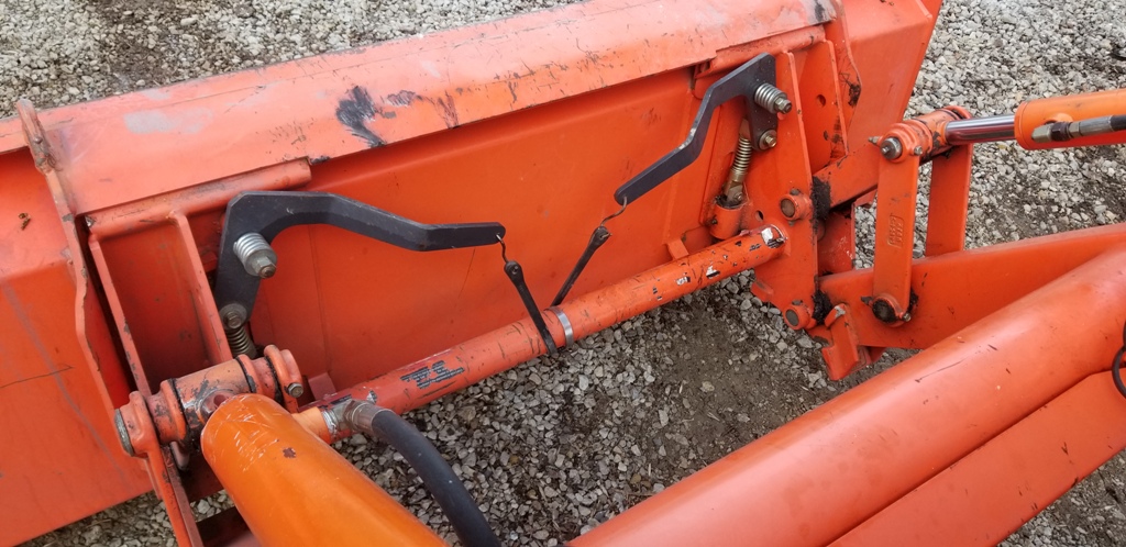

I dont know about that... the wedge pins have a spring between them and the handle. I think at any time you hit the bottom of those wedge pins hard enough and force them upward, i still think they can be popped out of their hole even if the handles are locked into their home position with anything. Or maybe i`m not seeing this as others are. I would think you would want a way to actually lock the wedge pins in place instead of the release handles.
EDIT:
Ok, so i went out to my shop, grabbed a prybar, and YES, you can still push those wedge pins upward even with the arms locked/chained/roped/bungee`d in the home position. So, my theory is, you will not stop the problem by just locking/securing the arms down with a chain or any other form or method to secure the handles. If the wedge pins get hit, they will not keep the bucket/grapple safely on the loader framework.
Until you find a way to lock the wedge pins from being able to move up, other than by its own spring pressure, you havent really fixed anything to actually resolve your problem.

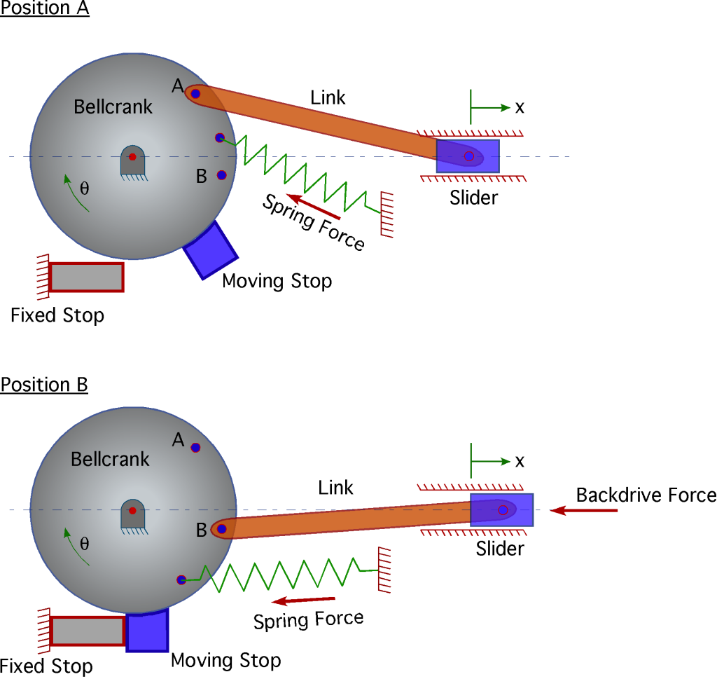

Please forgive my "tractor" ignorance. I got my first tractor just over a year ago at my tender age of 66 and I do not have the SSQA but the pin on bucket. A choice made based on the limited FEL capacity of the BX1880 (plus it was cheaper). ;)
But what I just learned about the overcenter mechanism of the SSQA latches scare the hell out me. I am familiar with plenty of overcenter mechanisms from my years working for NASA and I understand that a tractor is not "critical flight hardware" but still, that an attachment remains firmly attached to the FEL during operation seems critical to me too. I have never seen an overcenter mechanism where one of the linkages was not rigid. In every case the linkages are rigid and the spring (if any) was in parallel with a link but not in series like in the SSQA.
When you look at the diagram below, you can see that the spring is (sort of) parallel to the link and not part of the link. The spring pushes to rotate the bellcrank to make the link go to either side of the of the on-center position (horizontal position).
When you look at Position B, the bellcrank stop has rotated to the the fixed stop and the linkage is overcenter, past the horizontal position. At that point, you can push on the slider (pin) all you want in the direction labeled as "Backdrive Force" and it is not going to budge unless something bends or breaks. In addition, if the pins on the SSQA worked that way, the hand lever could not be moved all the way if the SSQA pin was not properly aligned with the hole that it is supposed to go into.
Am I missing something on why this SSQA attachment scheme appears to be the industry standard but does not follow the conventional design for overcenter mechanisms? My inquiring mind would like to know.
For the explanation how the mechanism works see:
But your SSQA spring is installed over the wedge pin rod, not the "bell crank". Your picture example isnt how these SSQA`s are designed. Similar concept, but not built the same in relation to where the springs are located.
You can still push those wedge pins up out of their hole even with the handle not moving and locked down. I just tried it with mine, and i can (with enough force) pry the wedge pins upward and the handles stayed put.
Anybody can hit one of these wedge pins just right, and with enough force, that attachment CAN come off, even with locking the handles down. I do understand what everybody`s theory is when they try to tie down the handles, but that`s not going to solve the whole problem. It may help in the short run, but it wont completely fix the problem.

That is exactly what I was pointing out. If the SSQA mechanism were built like the diagram I posted, it would not be possible to engage the pin and rotate the handle all the way if there anything preventing the pin from engaging. I addition, once the pin is properly engaged, nothing could push the pin back to disengage unless something broke. So that is my question, why is the SSQA built in such an unconventional way that ends up having those two failure modes? It does not make sense to me.
You an i are both on the same page about this. I would feel alot better if there were a way to LOCK the wedge pin in place once it reaches its home position. Locking/securing the handle itself dosent fix the main problem.
I dont know any other method to their madness on the design of why its like it is, other than what @rugar1980 describes. Seems logical anyway. I would think if it were a really big widespread problem, we would see a design change pretty quick. But this system has been around awhile, alot of companies use it. But is it dummie proof? Nope! Not until they design an actual locking mechanism for the wedge pins.
In the mean time, its best to always re-check everything to make sure its right before using the equipment.
