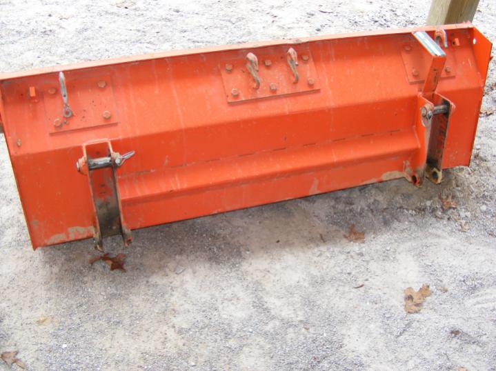

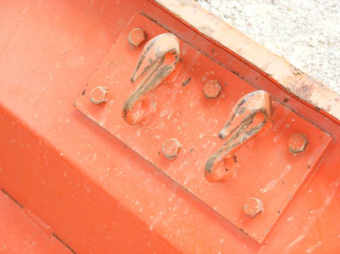

I made these hook plates and bolted them to my bucket in 2000 when I bought the tractor. These pics are not but a couple of years old and you can see how well the paint still looks compaired to the factory color on the bucket.
