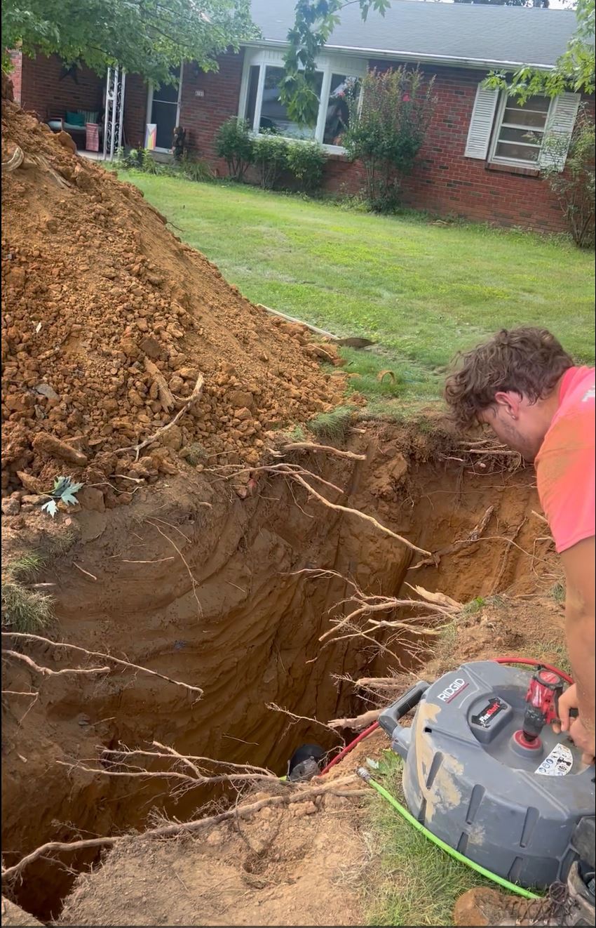

Plumbing co owner just sent me this. He was out marking a one call request for a job that we have to do just down the street from this location. We bid this job as well, but didn't get it (we were about $1,800 more).
He sent me a video. This hole is 9 plus feet. You can see the guy in the hole wearing a black baseball hat (not a hard hat). There is no trench box or shoring, no ladder, spoils pile right on the edge of the hole. They had plenty of room to bench the trench with reasonably stable soil. he told me that they were lowering the guys into the hole using the excavator.
I encouraged him to do the right thing. He placed a call into the municipal authority, fire department and the local OSHA office located about 15 mins away. Nothing. Is that what's to be expected on a friday at 3:30 pm? I hope these employees have life insurance.
To reiterate. THIS IS NOT THE COMPANY THAT I DO WORK FOR.
Looks like digging in clay.......but......NO EXCUSE!
Disappointing, that at least fire dept. did not show up to put a stop to that.
You really need to fwd that picture to OSHA.
It will not be "ratting".
I will be saving a life for next time!

There is nothing about this job that looks fine. You can see crumbs from the soil pile literally hanging on the edge. Unreal.
I realize it's not fine. My point was it looks fine to someone (the low bidder) because they made short cuts to get the job and think they can get a way with it..
10,158
7,015
@dirtydeed - I know too many people that have been hurt badly by situations just like that. At least it looks dry, if it’s any saving Grace….
Of course fatalities can happen just as easily too. Looks like that guy is all crouched down - he’s a goner if that collapses on his back….
Like you said, at the VERY least, that should have been benched and spoils further away.

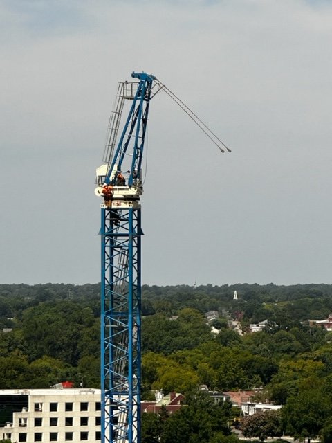

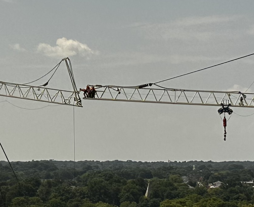

Speaking of risk...I was watching these guys assembling a tower crane across the street today. They are about 200' off the ground here...The crane will grow as the building goes up supposed to be the tallest building in our area when done. I zoomed in on the last pic, see the guy reaching out to help guide the new section of the boom to connect it where they are standing. All I can say is NOPE!

When you contact OSHA, a response for a normal call is about a week. For an immediate danger to life and health, OSHA will typically respond in 24 hours (realize a response may be a phone call, doesn't mean that an officer will show up). Even with the OSHA office being right there, most offices are already overloaded and you will be placed in a que based on severity of the incident and impact to the community. Realizing that OSHA will receive non-valid complaints from disgruntled employees , from individuals that are mad because a contractor that is working in their neighborhood so the person files an invalid complaint to try to get at the contractor, and then you have actual complaints that truly need to be investigated. The burn out for compliance officers are high and many move on to more lucrative private industry jobs.
IN our area, the fire department would not have the authority to do anything. Calling them would get no response.
As far as local authority, they do not have the authority to enforce Federal Regulations. Most would refer you to OSHA to have a private company taken care of the issue.
In our State, we have both Federal and State OSHA, but State OSHA only deals with government entities.
Does it make it right that the contractor placed the employee at risk? No.

If the guy in the hole is the owner of the company, OSHA rules dont apply, he can be as dumb as he wants. If he puts an employee at risk thats a different story.

Wow! Really? I never heard that before. I do think that the guy in the hole was the owner of the company. If he keeps this up, he won't be around for much longer.

Y. he got the run around from the two local FD's that he called. They said to call OSHA (which he did and got a recorded message). It's a shame that an accident/fatality needs to happen first.

IF the gentleman left his name and contact info, they will most likely get back with him. Depending on what the gentleman tells OSHA and if he has pictures, they will most likely open an investigation. Depending on the company and the history, it could be no more than a phone interview to a full blown knock on the door lets see records.
The phone call isn't a waste, especially if has pictures and is willing to take the time to testify. Yet, most people don't want to get involved and once they hear that they could be used as witnesses to make the case, many decide they don't want to get involved. OSHA gets lots of anonymous phone calls with complaints, most of those go no where.

Sounds like he operates based on hope. Probably had a couple of pails full of it in the home with him. He’s certainly not operating based on knowing. More than likely a shorter tater than a longer career.
I suppose the undertaker needs work too. And the hole’s already dug and maybe even partially backfill by the time that fellow gets the call. Can’t fix stupid.
