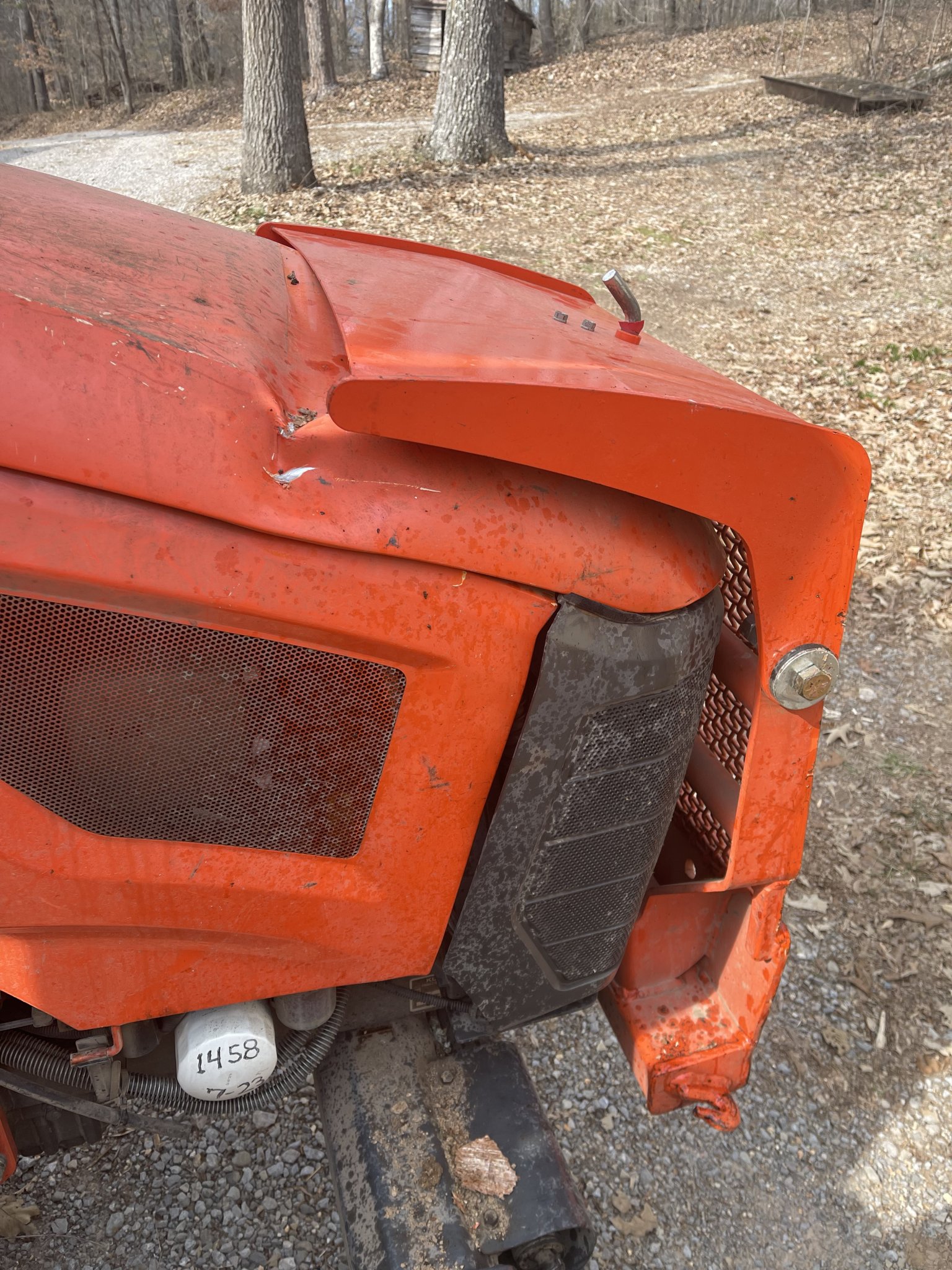

Been nice spring like weather for several days and really catching up on some outdoor projects including some that included clearing trees. Rain expected to start in a few hours so time to deal with a big stump from a large oak that fell last spring beside an animal shed. Have worked off and on clearing tree, sold saw logs, digging stump and whittling it down to size. Much too big for the M59 to lift. 8-9’ diameter with a 40”+ butt cut. Plan was to roll it about a 100 yards into the tree line for a final resting place. Got to 10 yard line and had it roll back.
Crunched my hood in spite of a bonnet protector. Ouch!

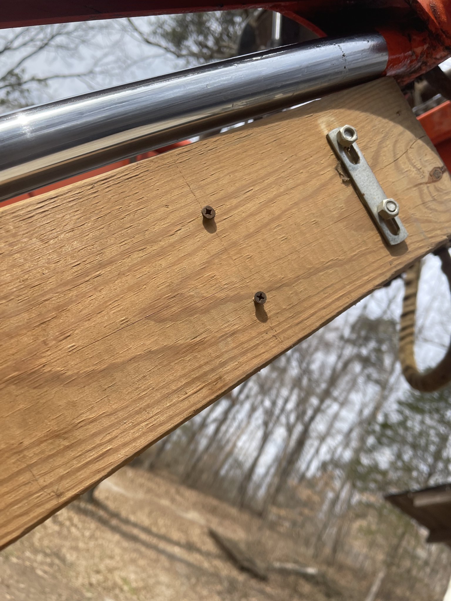

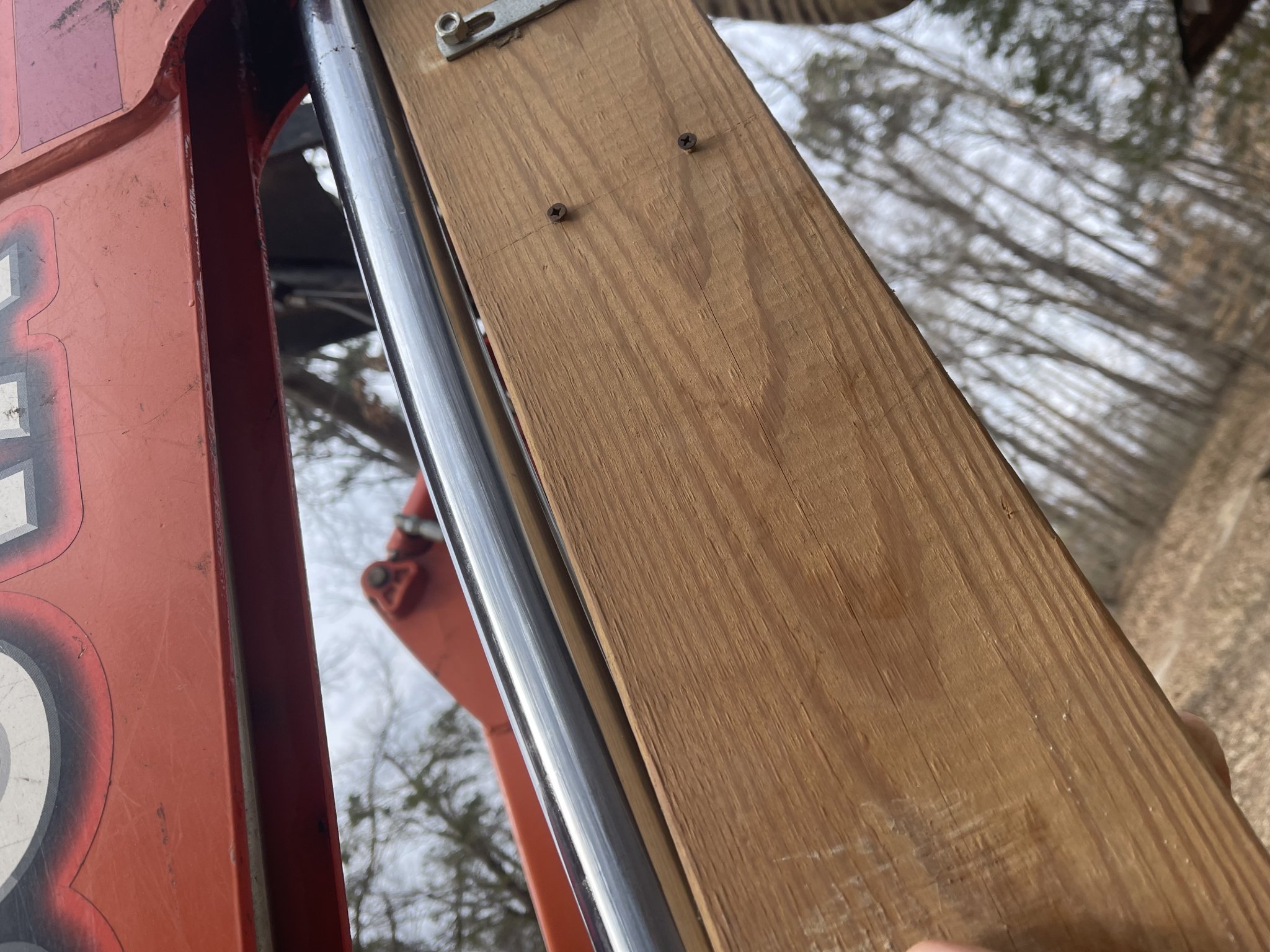

Tried for the last push and oil began squirting from the right cylinder gland. Cylinder rod has new bend about a 1/2”.
That stopped me.
Rod chrome looks good and bend uniform. Little hard to photo till I bring it to the shop.
Have to think wether I can straighten or send it to hydraulic shop. No leaks with no load. Never have straightened a cylinder rod but do have a 50ton press and tooling. Enough plastic bits to cushion the chrome. Advice would be welcome.
The bonnet I can beat back into shape. Be good time to paint it too. Sun damage Mary Kay pink.

I have never attempted to straighten a cylinder, but IF I was gonna try (and I would try at least)
I would probably find a 6 inch or so, piece of pipe that has an ID, the same as your cylinder OD and cut it in half to try and "spread out" the contact area when in the press, and maybe line it with some thin copper (any soft metal) sheeting to prevent scratching.
Just a suggestion, good luck.

I’d do what RWS suggested, if I were going to try to straighten the rod. Maybe several thin copper/brass (10, 20 thousands) shims in the half pipe to help spread the load onto the rod given it has a slight radius in it currently.

I didn't do the straightening myself, but I took the cylinder to machine shop and stood there visiting and watching. He used brass pieces to put under the ram at both ends and then on the top where he applied the pressure from his press. Gently and slowly and in a few minutes he had it to where you couldn't tell it ever was bent.
In actuality a slight bend like you show there would probably work just fine for as long as it would without the bend, as long as there are no nick in the shaft that would tear up the seals !!

I'd straighten that in a heartbeat in the press. You need a press with a wide enough arch that you can get the underside supports wide out as possible towards the ends of the rod then a scrap hunk of pipe cut in half with something to prevent scratches. Just go slow. Check it with an indicator or straight edge as you go. It won't bend all that hard. Watch you don't get carried away and put any extra dog leg in it.

Need a hydraulic press / Need to disassemble cylinder so you damage end cap or packing gland assembly / a 20 ton should be enough / also need "V" blocks to hold / also when pressing shaft need to go past straight a little bit / also use a good steel yard stick to check

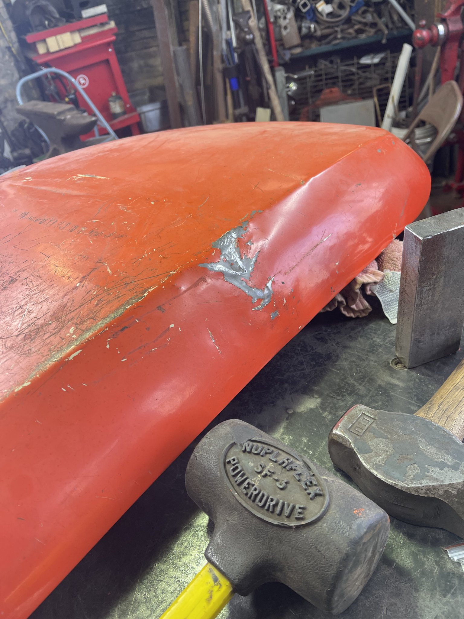

Decided to get professional help on cylinder. Maybe able to straighten. Head/gland nut cracked. Ordered new and seal kit from Messicks.
After 30 minutes beating on the bonnet.
