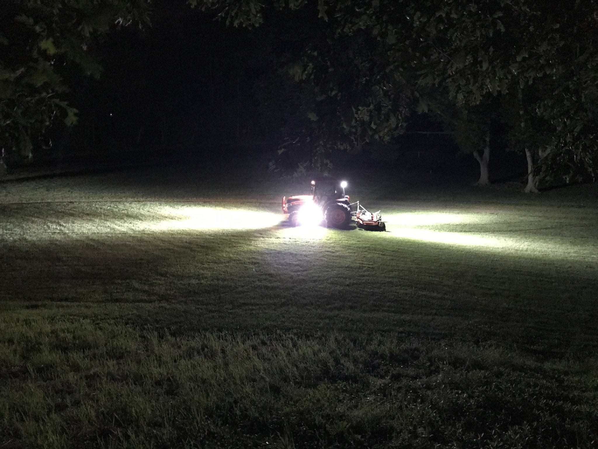

General non-tractor specific experiences using both halogen and LED:
Factory headlights are poor for any application. Mine only get used for driving on the roads so I don't irritate people with the LED's.
Floods work much better than spots. At 18MPH max you don't need to see 1/4 mile in front of the tractor. You need bright light near it.
Lights on ROPS attract bugs in Summer and create glare for me (eyeglass wearer).
Lights on ROPS and top of cab light up the hood very well, but don't provide good light for mowing. I usually have them on for general work and plowing snow, but turn off for mowing.
Lights mounted low on front work great for mowing by "raking" across the cut/uncut junction of the grass at a sharp angle. Lights shining down at the grass don't work as well. Usually turn these low mount lights off when using the loader or snow plow.
Side lights help a lot when watching turns at night.
A switch for each lighting position is handy to get the optimum benefit. "All on" isn't always the best.
