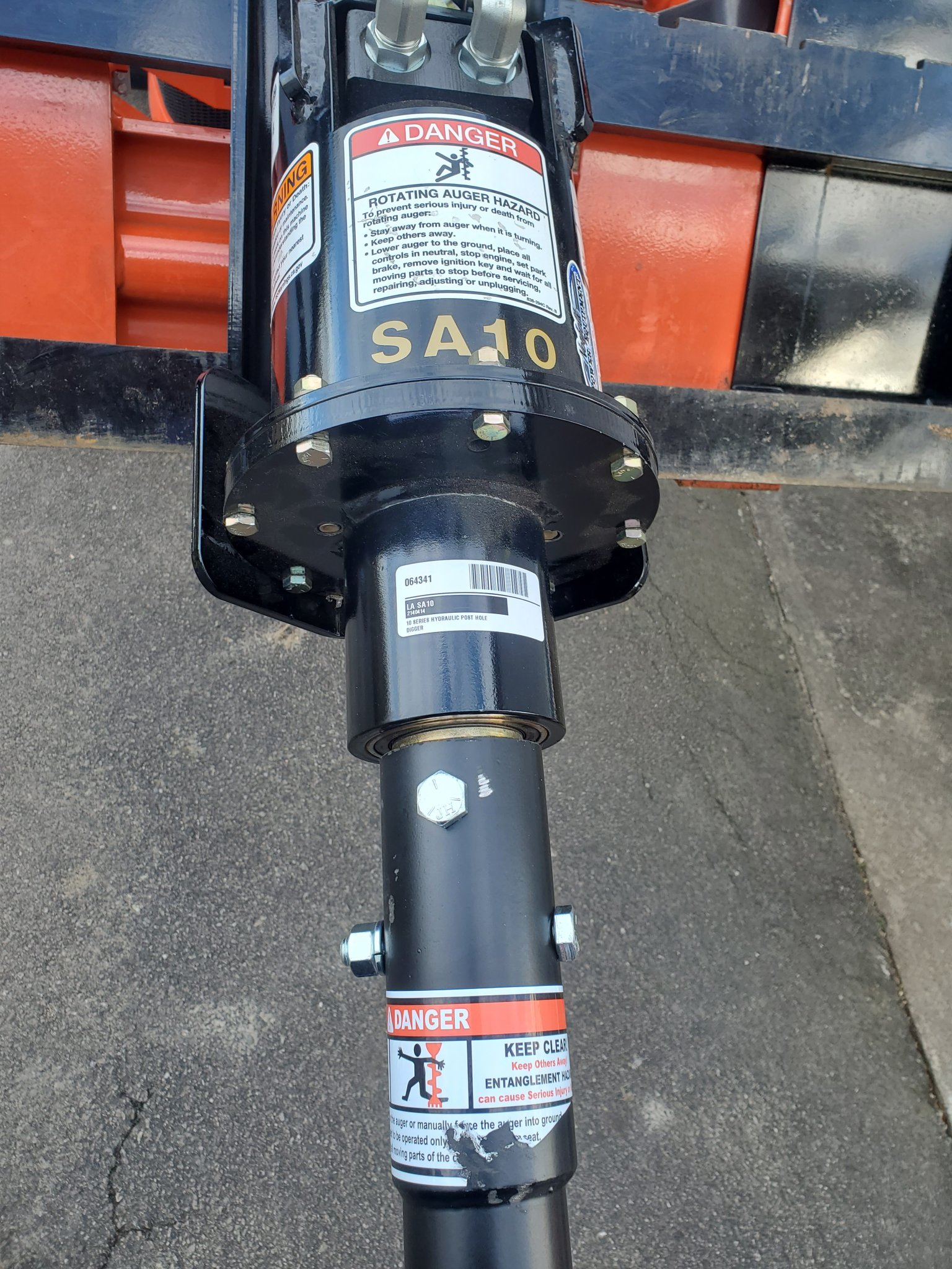

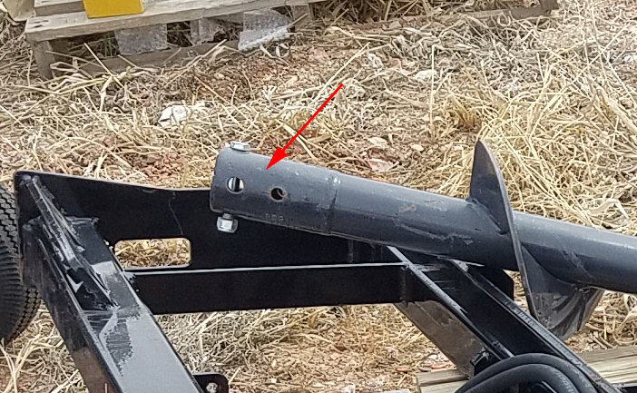

On one of the augers the collar is slightly too long, maybe due to the weld. So the auger won't slide far enough up the shaft of the driver to attach the shear bolts.
The holes won't line up.

Wow! Drilling and welding seems like more work than necessary. I'd grind or cut the excess off the end. The op mentions "on one of the augers" so that means one is good to go so he has something to measure and replicate.

The collar is on the auger so he'd cut/grind the auger and not the output shaft of the motor. I have a Land Pride HD25 PHD and this is one of the augers.
28,929
5,288
Your right I was reading it wrong.
My thinking was backwards as I thought it was the driven shaft was hitting the bottom before the shear pin hole would line up.
Hitting the top of the collar is an easy wack off of the top of the collar!

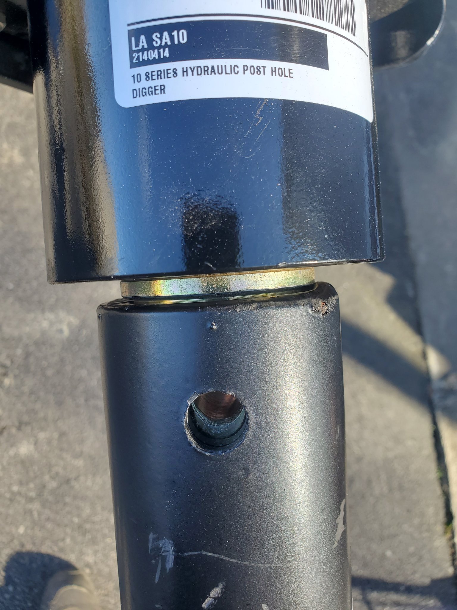

You can see the mismatch in the first 2 pictures.
It wasn't quite as bad as it looks, there's a small amount of slop in the fitment, and the weight of the auger pulls it down and "off".
Ground a little off the top and a small bevel and it's all set.

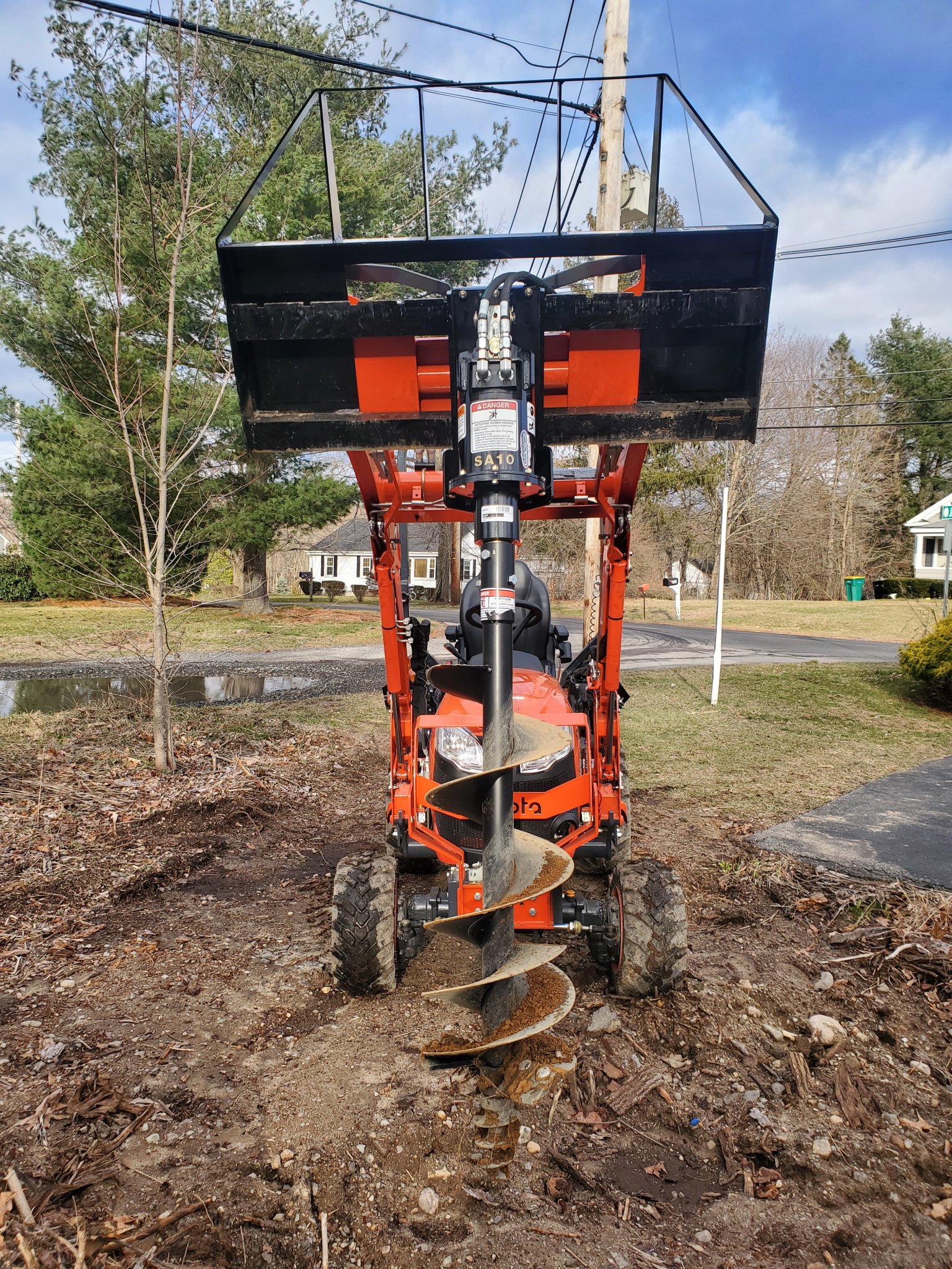

I ran the driver (Land Pride SA10) early this winter with the 6 inch auger but didn't get a chance to test the 12 inch. Ran like a champ!
Land Pride says it can only handle up to a 12 inch auger, I'm tempted to try larger.
The only real difficulty is drilling straight. Because the loader travels down on a curve it wants to pull the auger off perfectly vertical as it goes down.

It only looks that way. We've had a LOT of rain lately. The ground is soaked.
I haven't found many large rocks, but lots of smaller ones (fist size down), and sand/gravel/clay.
The picture where the auger is full of dirt, and the 2 of the tractor; to dig there by hand you need a pickaxe normally. There's probably a foot of loosened soil on top at this point (I loosened and dug/sorted a mess of root thatch by hand, that's what's left of the spoil pile.). It's a mess I've been slowly dealing with for years.
It may even be old driveway underlayment. Directly to the right of the hole I dug is a sheet of old pavement 6 or so inches down. Runs over 100 feet as far as I can tell. It's one of the jobs I got the BX for.
The 3 hole spot I don't know as much about. I tore out a dogwood stump from there yesterday, I figured it would be a good spot to start testing the larger auger.
This winter I ran the 6 inch auger about 10 feet from a spreading Norway Maple, it had no problem burying itself.
I've got other parts of the yard that are rougher, I'll get a chance to test it there eventually.

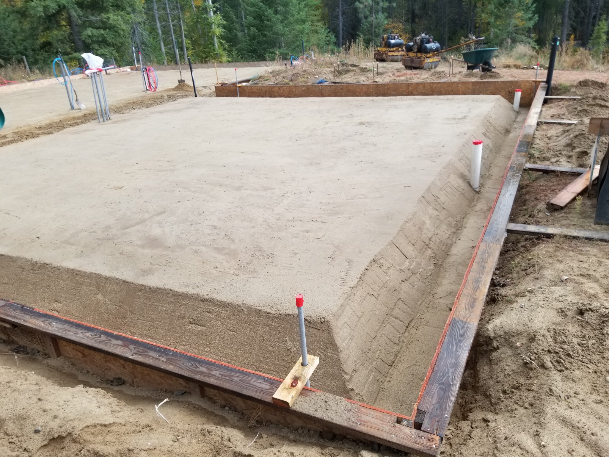

Come dig on my place, I've been 16 foot down and pure sand!
Couldn't have sculpted my foundation like this if it wasn't.
