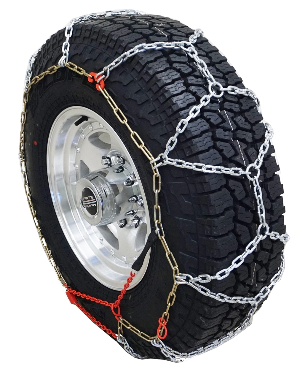

Has anybody used a set like these? The price is very attractive and I can see situations where the diamond pattern might be advantageous.

I don't have any experience with those kind of chains, but would be very concerned about how long they'll last. Guessing they're intended for intermittent use, or lighter vehicles.
Look pretty light-duty to me.

I have the same reservations, but may gamble on a set if I don't find anything better. If they don't work out I'm not out too much and you have to consider that you could replace them like 3 or 4 times before you equaled the cost of a set of "real" chains.

I decided to see how they would work and bought a set of the diamond pattern chains linked above. Got them on... Cyber Monday, I think, so a little less $ on sale. They came packed in a plastic carrying case and included some repair links.
First try on installing them was a fail. Instructions were slightly misleading and it began raining while I was trying to put them on, so I was in a somewhat foul mood to begin with. It didn't get any better. Finally gave up and waited for a better day - with snow coming tomorrow and reasonably warm temps, today was that day.
I had a lot of problems getting them around the tires the first time, so I tried adding one link to the outside chain. This brings up a good point that I hadn't caught on to when I ordered them, and that is that the inside uses a heavy cable to anchor the cross links, rather than a chain. That means you can't alter the length. Just one extra link on the outside allowed me to stretch them over the tires, though.
I am not too happy with the fit. I think they are sized for a truck tire that has a narrower tread, or maybe the turfs on the tractor measure a very generous 33" around or 12.5" wide. Or both. Whatever the case, the cross links end almost before the sidewall begins. I think they will stay put, but I will be keeping a close eye on them.
Drove around the yard some after mounting up the chains to see if they would settle in. Our driveway is glare ice in most spots but I could drive around in 2wd just fine and they seemed to really bite in.
Time will tell if I made a good choice or not.
Last thing I'll add is that I somehow got one of the chains all twisted up and I was about ready to toss it in the trash until my wife gave me a hand and she figured out how to untwist them. The moral of the story is to try and keep them nice and neat when you are storing them and be careful of twisting them up when you are installing them...
