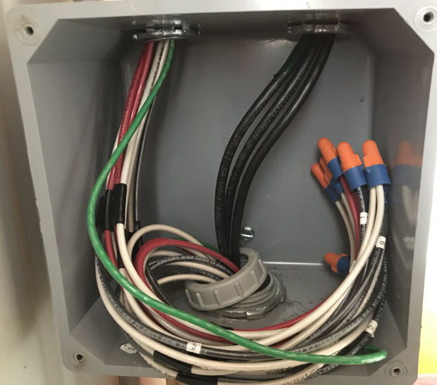

The assistant is coming out Thursday, so you can bet I'll be breathing down his neck so I can learn some more first hand. Assuming there is at least one wire per circuit breaker there should be 6 or 7. There is a box in pole barn. Can you tell gauge by looking without touching them? Thanks!
torch
Jun 10, 2016
2,907
1,170
Muskoka, Ont.

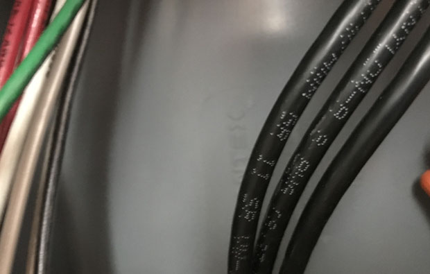

Ok, this does make some sense now. If you bundle more than 3 conductors in close proximity for more than 24", then they are supposed to be derated. The exact % depends on the wire insulation temperature rating and the number of wires in the conduit. If you have 6 wires in there and if the wire gauges were not adjusted as required when initially installed, then perhaps the rewiring is warranted. But I personally would have installed heavier gauge wires in the first place.
Usually the wire insulation will be marked to indicate characteristics such as temperature rating. It will also often be marked with the AWG size, but your electrician can probably identify that by sight.

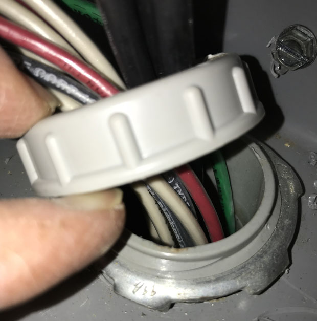

Ok, here's what's happened in the meantime: I got brave (?) turned off all the circuit breakers in the panel and opened the junction box in the pole barn. Photographed the wires, and the conduit, and with help from NIW concluded that the 50 amp welder circuit only has 8 gauge wires supplying it. 8 is marginal for welder, but totally inadequate for a heater which unlike a welder is pulling current constantly. I f you squint at the teeny tiny dot pattern on the wire it says 8 AWG/
Wasn't sure if that conduit was packed tightly, but if I don't plug anything too hefty into the 110 wall sockets it should be ok. Distance is less than 24 feet to panel.
So new 6 gauge wires were needed.

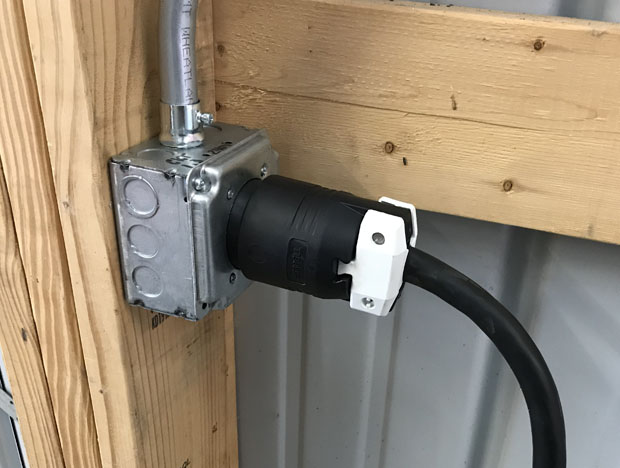

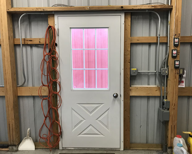

Electrician came yesterday and here is what he did. They stuck to their guns that the plug etc. had to be multiplied by 1.25 requiring a 60 amp plug for a heater using 42 amp. Since I am building for the future, including the possibility of someone using this plug for something else, I didn't argue about paying for more expensive plug and receptacle. The good news about the 60 amp plug is that it is easy for me to attach and detach from the wall outlet; it can be grasped with two hands with no danger of getting a finger near the prongs. I liked the idea of the Twist locks better, but they had already bought these, and they will work ok.
So he pulled two new 6 gauge wires and a new 8 for a ground from the panel next door, into the box and then on into a smaller conduit over the door, and ended in a more convenient location to hang up the cord and park the heater. A 50 ft 6 gauge SO cord was attached to a 60 amp plug at one end, and the other end directly to the heater via a strain relief gadget as described by Torch. I had said 35 feet of cord would do, but the electrician pointed out I was going to pay for 50, may as well use it. My thought was you can always shorten it, but you can't make it longer.

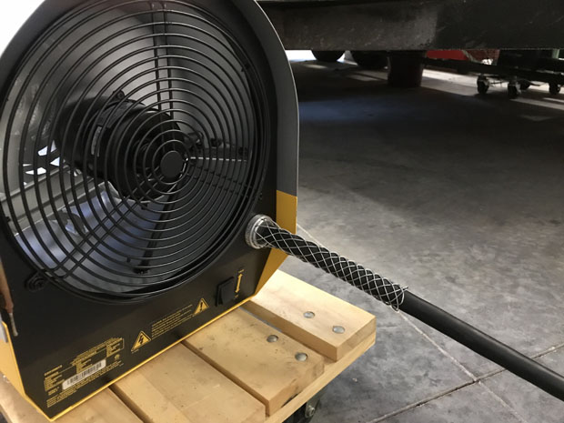

Spent some time today trying out the deWalt heater. On the one hand the heat output is underwhelming considering all the wiring to get it to run, on the other hand it appears safe. It is quiet, the airflow goes about 6 feet, and is fairly linear. It doesn't blow loose objects around. The case does not get hot. You can run it on the high or low settings by flipping a switch, but I didn't see a huge difference between the two. You can run the fan without heat by turning the thermostat down all the way, and this should be done to cool it off before shut down.
I suspect it will be useful for warming a small area where I am working, and it warms the general area of the tractor engine from a reasonable distance. I got down on my knees and pretended to grease zerks, and it was a much more agreeable temperature near the heater. I am not sure it will melt off much snow, I think Dave will prove correct on that score. I also think Eipo and several other folks that suggested making a smaller enclosure for the snowblower will be correct. The good news is that this heater could be aimed at a 3 sided enclosure without melting the hydraulic hoses.

On the rolling platform is brilliant,easy to move and up off the floor to keep it out of the water.
The expense of wiring is done,its safe and done well. Just need snow.
