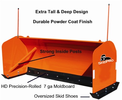

Has anyone created a snow pusher for a B7100 ?
I'm wondering what the results would be like. Thinking about making something up for next winter. Getting tired of moving the snow with the FEL bucket. Looking for a better way of covering more area, more quickly, and not carrying around a bucket full of snow.
Not sure what dimensions I should build it to, based on B7100 bucket size. Thinking of something like this:

Those are basically just a blade with box ends for collection. I'd say if you do decide to build one, maybe not go any wider or a tad bit wider then the wheel stance on the back of the tractor for traction sake.

I started to make one for my B7100, backed of off it this year because of time constraints.
They are great if you have a long straight runs, if you need to do curves they are going to work you to death.
Make it as light as possible and at least a foot wider than you wheels. ;)
