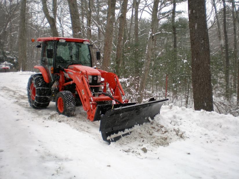

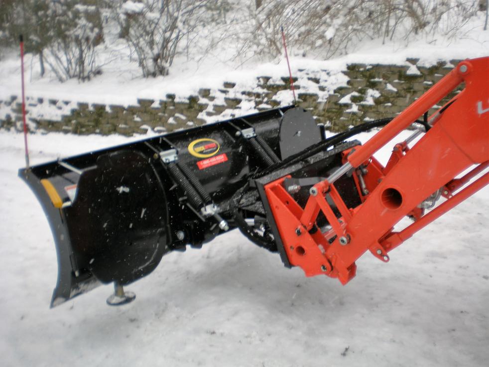

B2650HSDC with SSQA and R4 tires, B2673 72" snow blade, manual adjust. Used it first time for snow this morning, by the way those front and rear work lights are great. When I angled the blade one side is lower than the other, is there any way to adjust that? The feet dug into the gravel/roadbase so I had to feather the blade up. Am I doing something wrong? Truthfully I have never had good luck with feet on snow plows.
I could tell the difference in starting tractor at lower temps but it smoothed out quick and ran great. May have to go with chains, have a curve with an incline that taxed the 4wd, slipped and steering was not positive.

You are gonna have to get those "feet" right....they are the key, unless of course it is just flat concrete or asphalt.
Might need to change out the feet to something else, like a ski or something that will ride on rather than dig in.
Should be a way to get the angle parallel to ground and then angled correctly.

We're a ways off from plowing this year, I hope. I'm also going to have to learn to use the plow vrs the bucket like last year. I'm thinking you just need to roll the ssqa forward or back.
Angle the plow to one side, lift it about 2 feet off the ground, then roll forward and back. That's the easiest way I could think to exaggerate the slope you're describing. You just need to play with the roll to find the sweet spot. I'm thinking that could work to your advantage in times also.
I've seen some plow mounts that have a third skid shoe in the middle near the ssqa. My guess is that one would be adjusted to the sweet spot.

With regard to the plow digging in, it should be a matter of adjusting the hardware that connects the blade to the tractor parallel with the ground. That could be raising / lowering / curling / dumping if your blade is on the SSQA. The bottom edge of the blade needs to be flat on the ground at all positions of rotation.
Looking at it from the tractor seat with the blade angled to throw snow to the right - If the connection tilts up at the front, the tip of the blade nearest the tractor will dig in.
If the hardware is tilted down, the tip of the blade farthest from the tractor will dig in.
