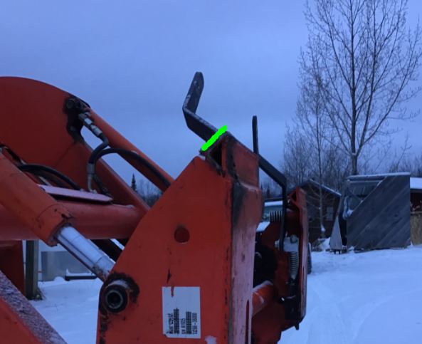

Would someone please post a picture of a "properly fitting SSQA pin" when its engaged.
I will check this weekend, but I am quite sure mine is like the OP's.
I am almost 100% sure that when engaged, my pin hits about 5/8 of the way up (from the tip of the pin.)
Having a properly fitting reference would help a lot....(at least for me).

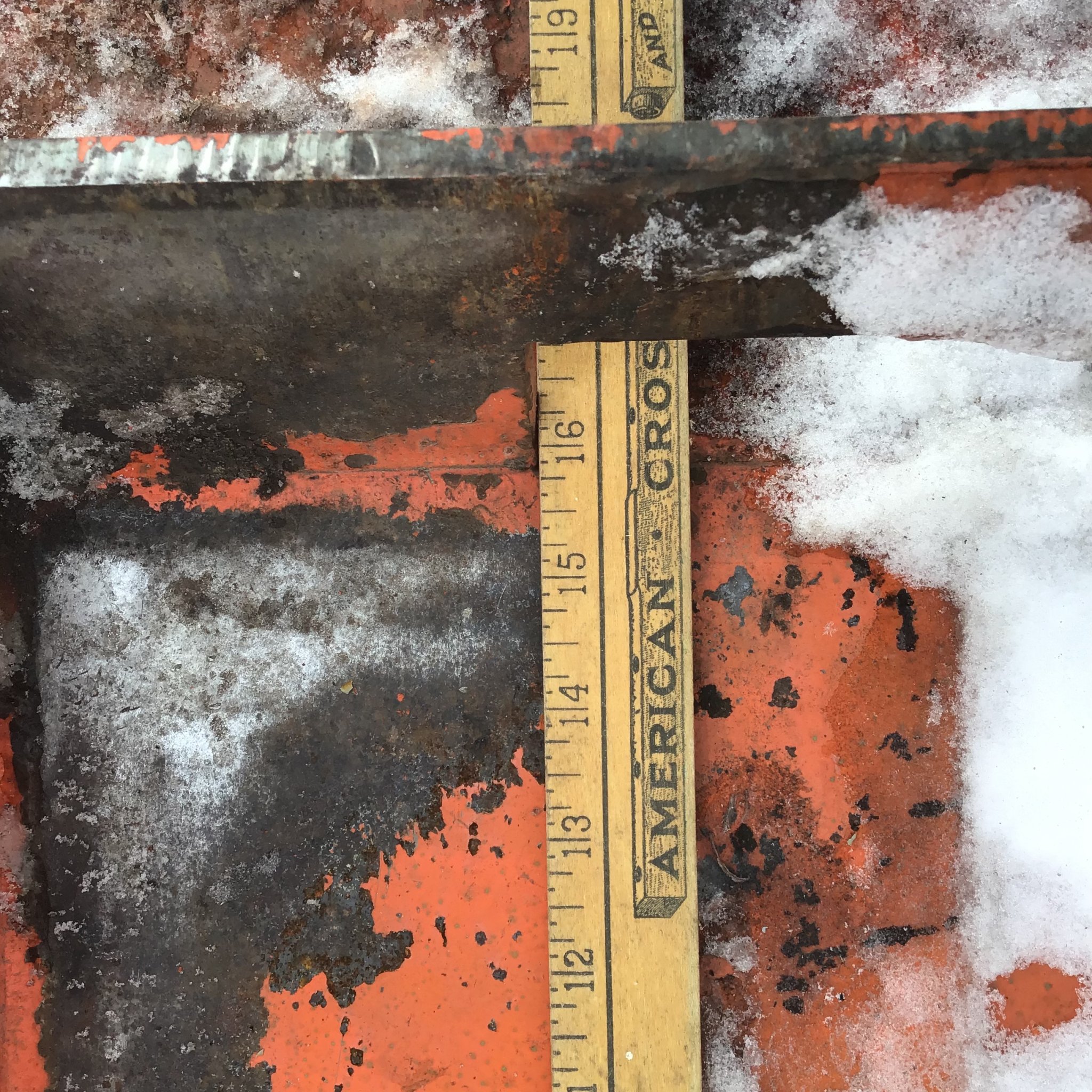

Not sure where you're seeing 16-3/4". I referenced those drawings you sent (thanks btw) and looks like the plate on my bucket is a pretty close match (reads right around 16" on my yardstick which is tucked up inside the angled sleeve at the top of my plate).

Here are the measurements from the plate on my bucket.
The plates are on the money so your SSQA adapter is what needs to be altered.
If it were mine I would add a 3/8" or 1/2" plate on the top lip to bring it up 3/4 of an inch.
You'll have to measure which size plate at the angle, comes up to 16" when attached to the lip.
Tack it on and check fit.
like this:

right picture (Kubota13), looks like 16 3/4", just left of 'CROS' on the yardstick.
He's not measuring to the pocket, he's measuring to the bend, 16", ok 15 7/8" if you want to be super technical, but the top of the yard stick is not tapered to fit the bevel so it's probably 16" exactly.
And 16" to the bend is right on the money.
