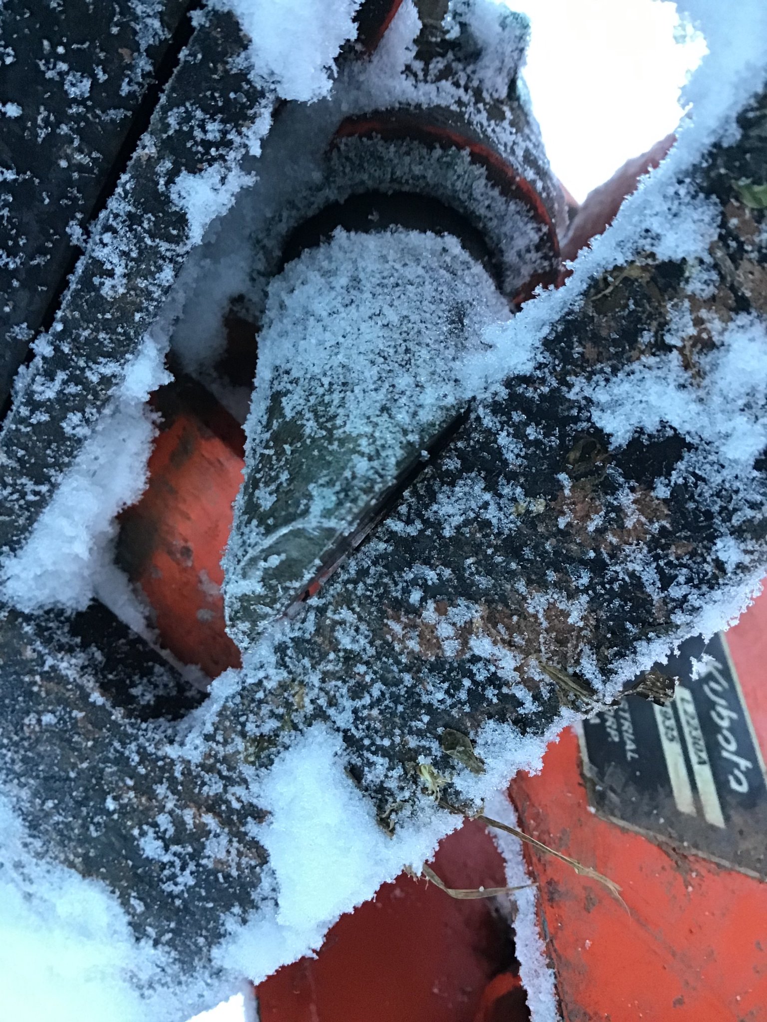

Here are some photos.. hope they're helpful. I tried to attach a video I took of me jostling my pallet forks around (which shows the pins moving relatively freely inside their respective holes on the attachment) but the site won't let me attach the movie as-is (Quicktime vid). Not sure if there's a different format that'd work..?

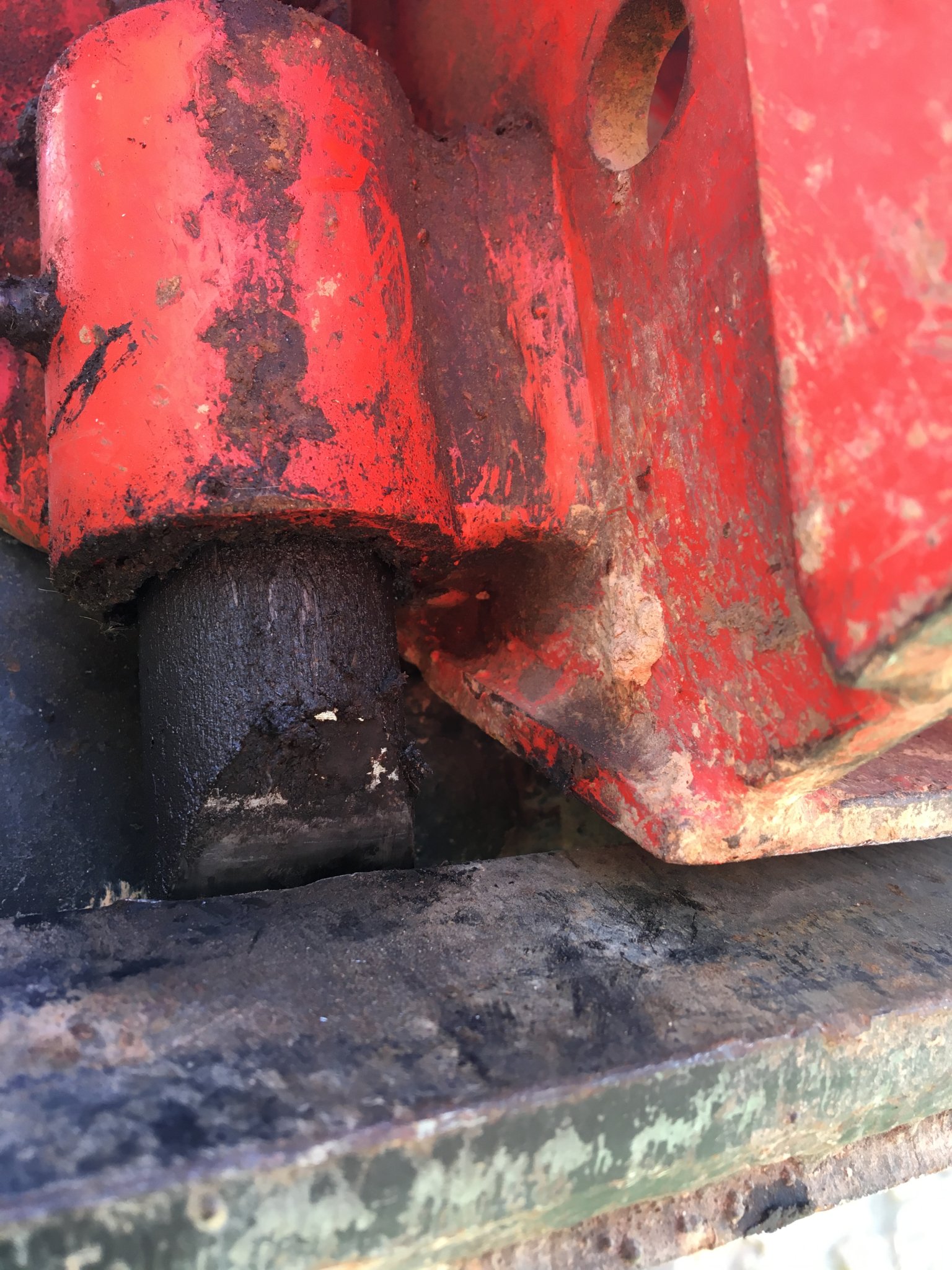

I included one photo of a pin engaged in its slot. You can see a little daylight between the pin and the attachment.
If the pins were worn enough to cause this, I would be surprised to see them worn so evenly, no? They appear to have their factory taper. Do these springs wear out?
Eager to hear what you think. Thanks.

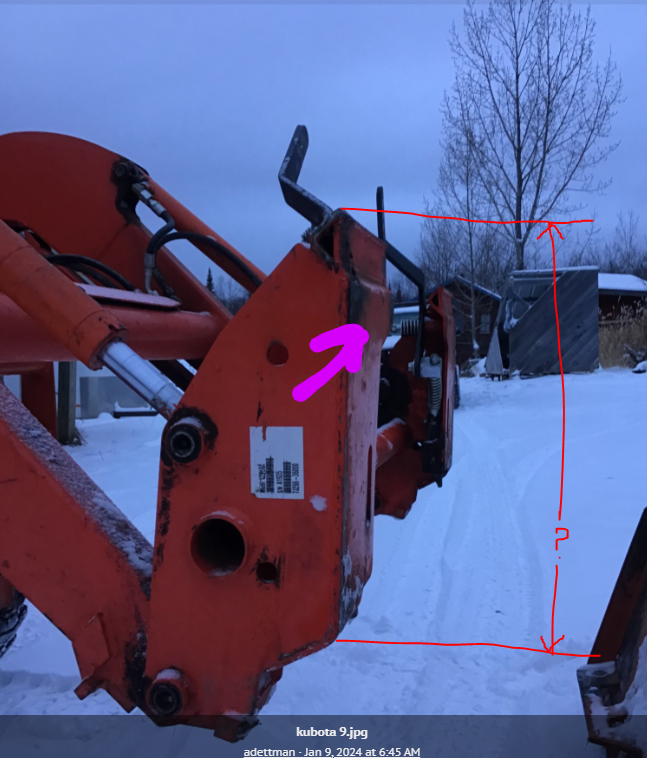

In post #11 where the red line is at the top, does he need to add some steel there to extend the adapters for a tighter fit?
Sort of what I'm wondering as well.. where'd be the best place to start in terms of shimming my SSQA?

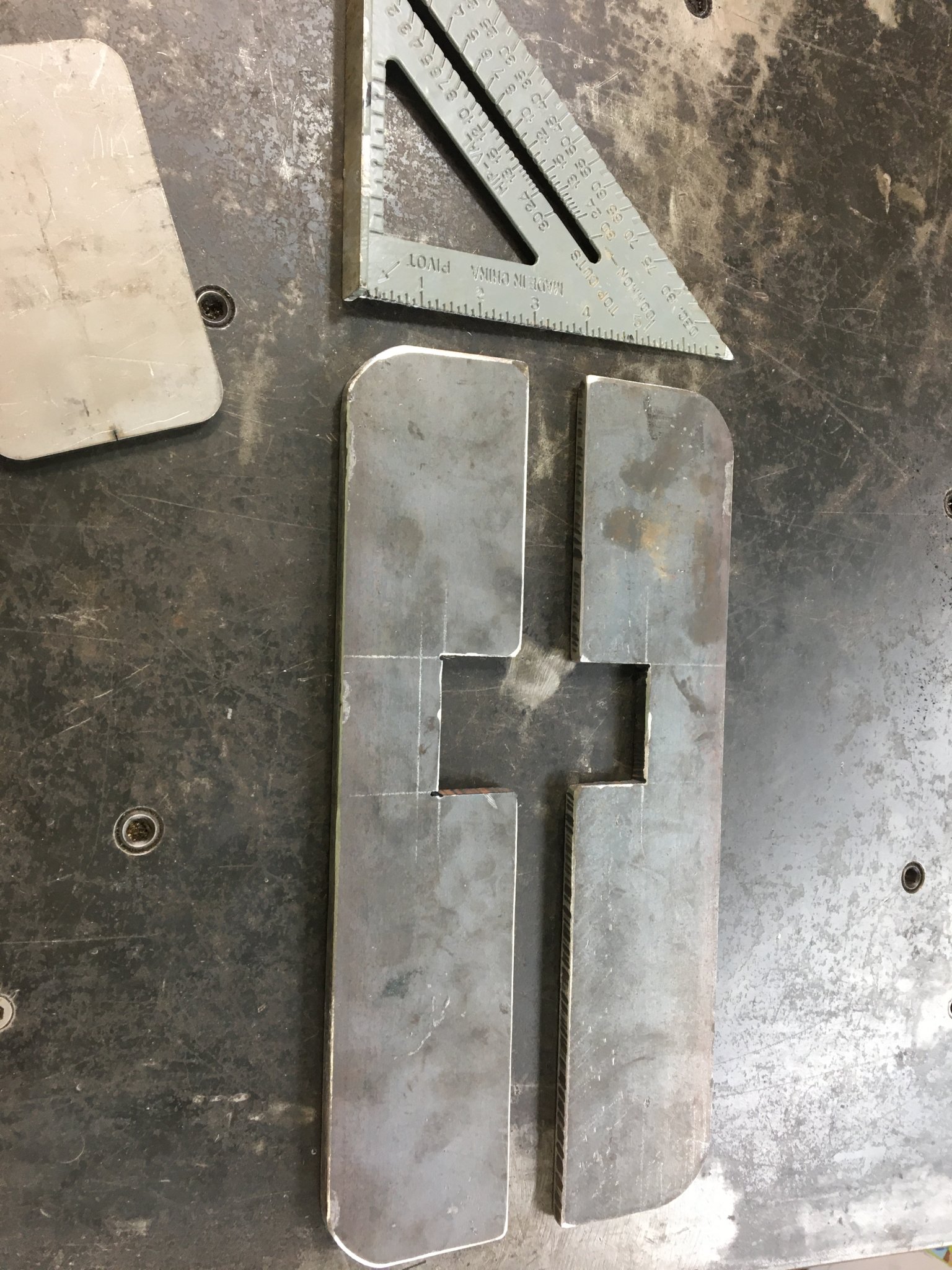

Measure your mounting plates first, that will tell us which way to go.
32,636
8,191
The best way to fix it is to add a plate on the top of the SSQA adapter to bring it into spec.

Would someone please post a picture of a "properly fitting SSQA pin" when its engaged.
I will check this weekend, but I am quite sure mine is like the OP's.
I am almost 100% sure that when engaged, my pin hits about 5/8 of the way up (from the tip of the pin.)
Having a properly fitting reference would help a lot....(at least for me).
