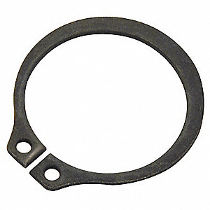

Is it ok to use this type of retaining ring on the rotary cutter gear box shaft? Its their in case the shear bolt breaks. It keeps the u-joint drive line on the gearbox shaft.
36,564
11,311
If it's already set up to use that type of snap ring, then yes.
36,564
11,311
The original snap ring was round, no eyes. Being cautious because the shear bolt may actually fail one day after it is notched.
Then the original snap ring wasn't a traditional snap ring, it's a different kind of ring, and then no that snap ring will not work because the eyes will grab and fail.
You need to get a retaining ring without the ears.
