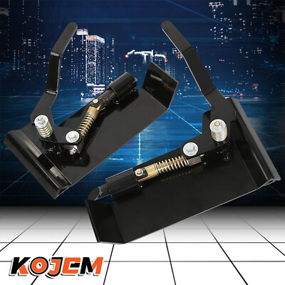

Get these parts:
Or
34,070
9,274
The first plate will be used for the back of the existing bucket.
It is also the plate you will use to get the spacing right for the attachment plates.
Do not attach it to the bucket till you are done fixing the attachment plates to the loader arms.
( You will want to cut out the center steel to make it lighter so not to add too much weight to the bucket. )
The second will be used to make a fork frame.
The third or fourth attachment plates will be used with the existing brackets that you cut off of the existing bucket.
You will also need a connecting bar from one pad to the other.
