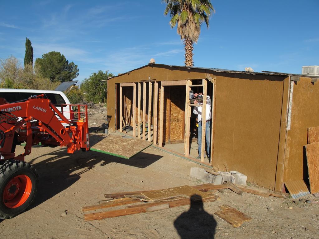

I have the Kubota 36" forks on mine, got them when I bought the tractor. I use the forks almost more than anything else, just moving things around the property. They also make a good portable work table. Sometimes I'd like 42", but most of the time they're fine.

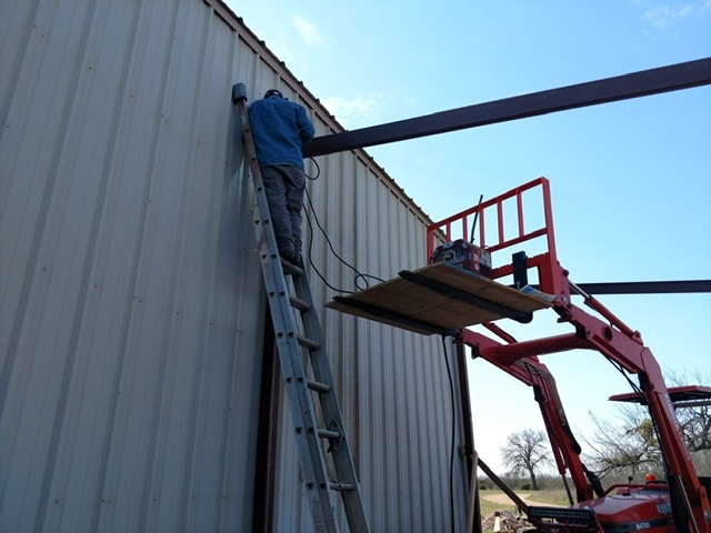

When adding a boat-shed to the side of my hangar we used C-clamps to clamp a piece of plywood to the forks to make a work platform. We used it to get the welder and the cracker-box up to the workplace for welding up high. Worked out very well. (We did not notify OSHA.)
