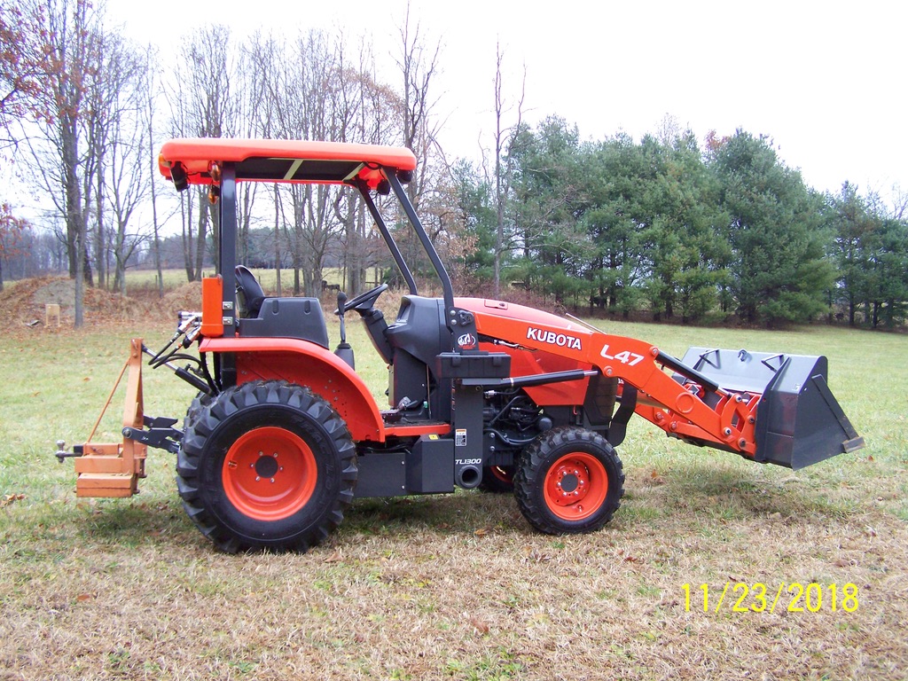

How easy is it to remove backhoe and install the 3ph on a dedicated TLB?
I find it pretty easy, maybe 1/2 hr. I never timed it.
BTW I'm 69 and sometimes it takes me a while just to get myself off the floor.:oops:
I do more loader/dirt work with my tractor than mowing/farm tasks.
I bought my L47 as a loader without the backhoe. I had been disappointed in agricultural loaders and wanted something more sturdy. The L47 has a huge subframe that supports the loader. Everything is heavier duty than it's ag equivalent, even the tires. Because of a dedicated pump the loader is much faster.
It's very stable moving things like round bales.
I also wanted something my wife can easily operate. She has no issues with the six speed hydro.
Cost w/o the backhoe was $38,900 with some extras 2 1/2 years ago.
The backhoe was added about a year later for around $10k. 3D8FA523-A192-42F8-9D11-7727C047158B_1_105_c.jpeg
