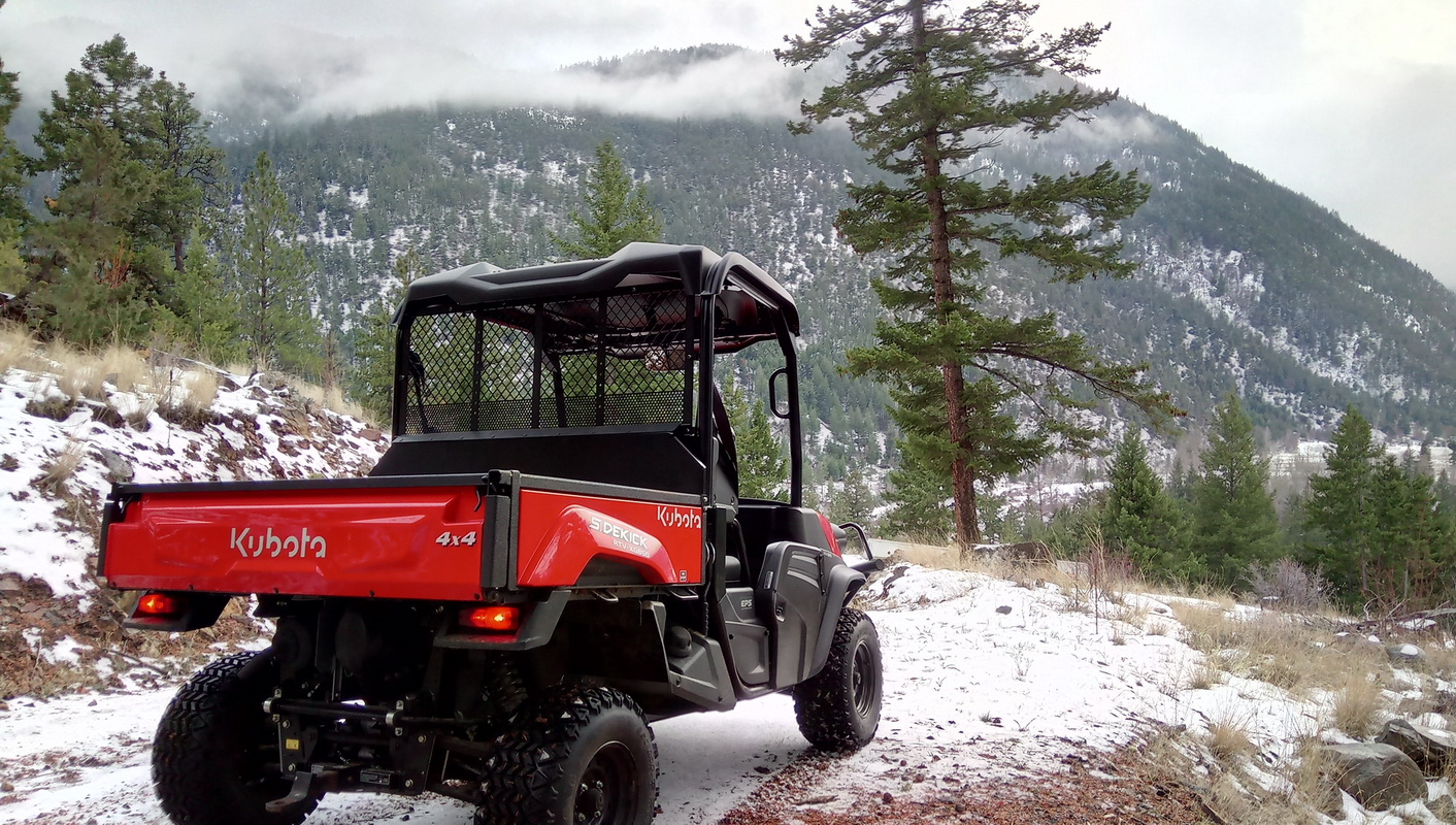

That said, for anyone looking at one of these...I read all the "deez are da crap, dey gots da subarus and dey all crap" posts, and look, EVERY buggy is going to have issues, we ride them hard, we work them hard. My experience (and I have NO affiliation to Kubota, I personally think their pricing is insane, but love their products) is this:
I have used this buggy to haul full loads of logs out of the forest, 15 full cords a year, and since I'm on a mountain, that's constant 10-30deg runs. I have a half mile laneway that has 7 switchbacks and a rise of 300'. We get up to 10' drifts of snow. I use the buggy with a plow on it to clear that driveway. I've pulled pickups and an old blazer around with it. I've gone mudding with it, I use the roof as a shooting rest. The thing has not had a single issue, nothing (well less packrat incursion). I DO keep up on all the maintenance, I DO use a bit of seafoam in the gas and in the crankcase (anyone who says it shouldn't be used in a crankcase quite literally doesn't know what they are talking about).
In fact, the only negative was the factory battery, it died in less than a year and the dealer didn't want to replace, but meh, I can live with that. Oh and the tires (in the pic) only lasted about 1000 hours, but again, ROUGH use. I ended up ordering those same ties, just upgraded the rims, because they worked on dust, mud and ice.
