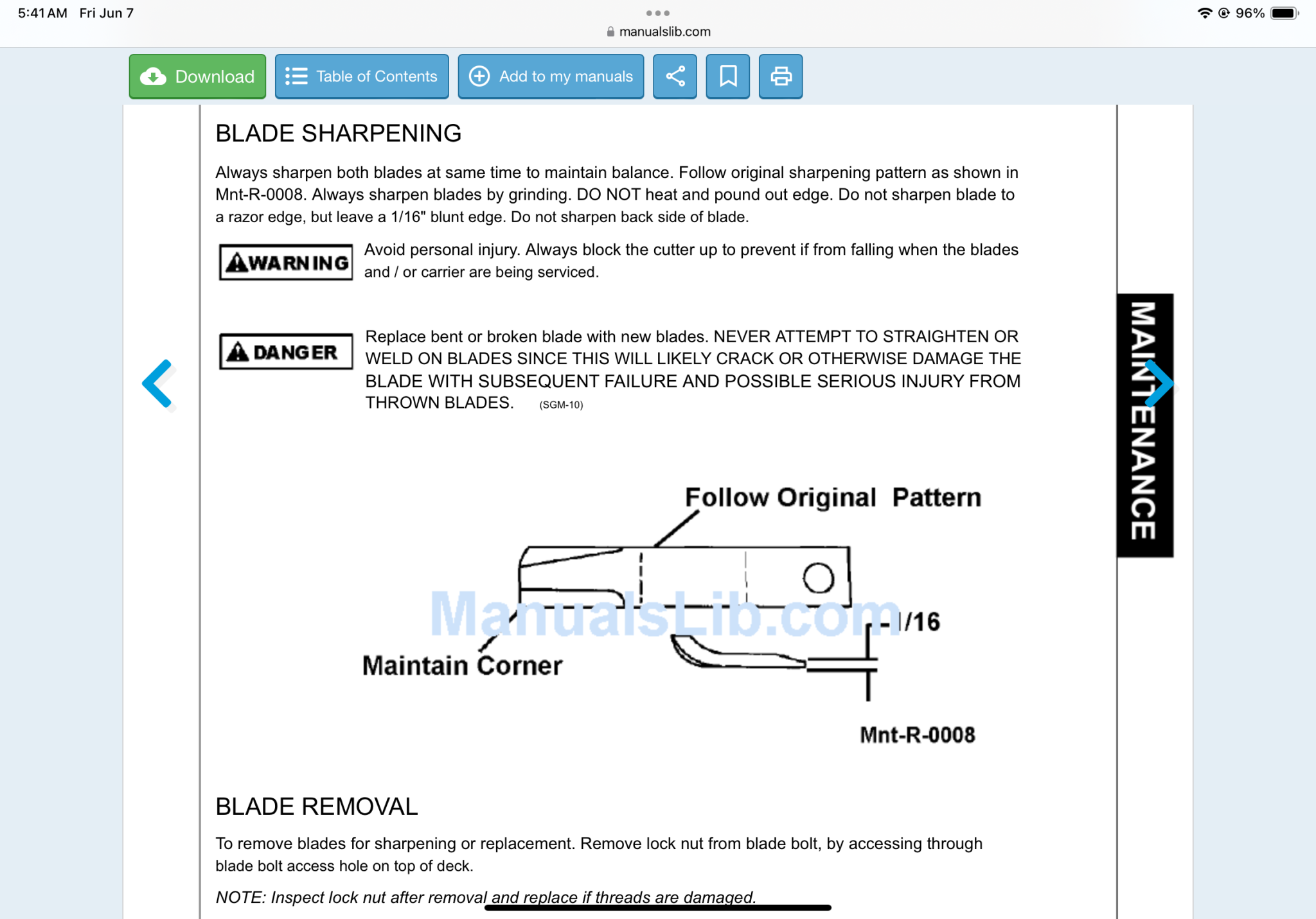

The actual edge shape should not cut the skin if you run your hand down the edge. A Fresh/New blade actually has a FLAT leading edge…for strength…and to “break” the stem of plants. Specific instructions on blade maintenance from Rhino describe the leading edge to have a 1/16” flat leading edge.
But the videos I posted …for those who didn’t view them…. points out that a rotary cutter is Not a Finish Mower…. it is intended to ”shred“ small woody brush and weeds.…and the condition of the blades “sharp” edge is almost unimportant…. dull blades whack the brush just as effectively as “sharp” edges do on that type implement.
