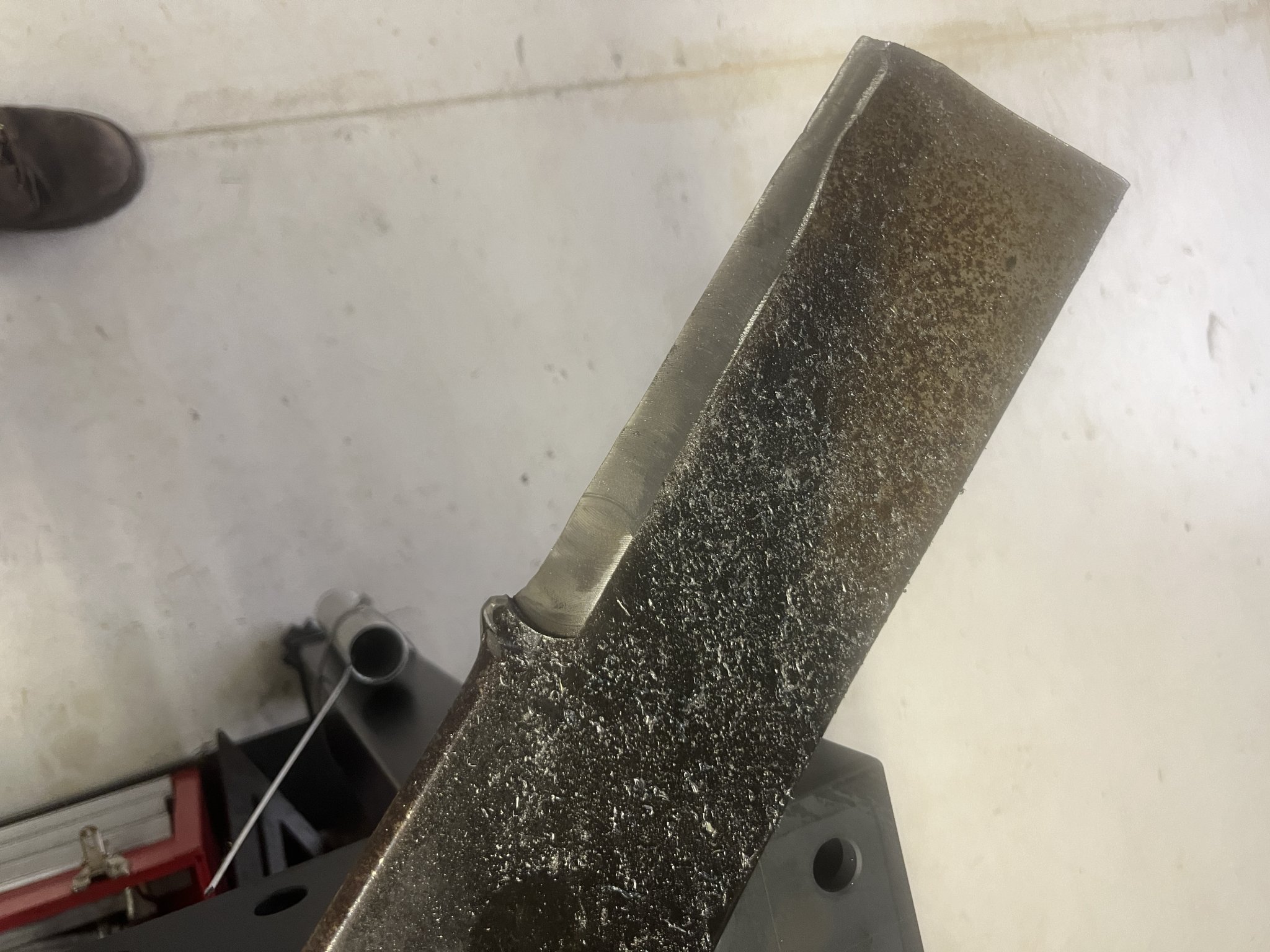

I agree that in a perfect world, this is the way to go! BUT.... (there's always a BUT) in the real world, unless you just finish cut lawns your blades will look like this:
Disclaimer: I am a professional, my company mows thousands of acres a year, and the above blade has less than 40 hours on it.

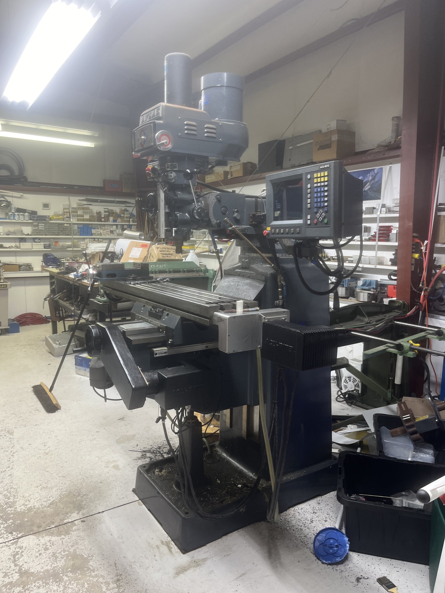

We have an Atlas Mill:

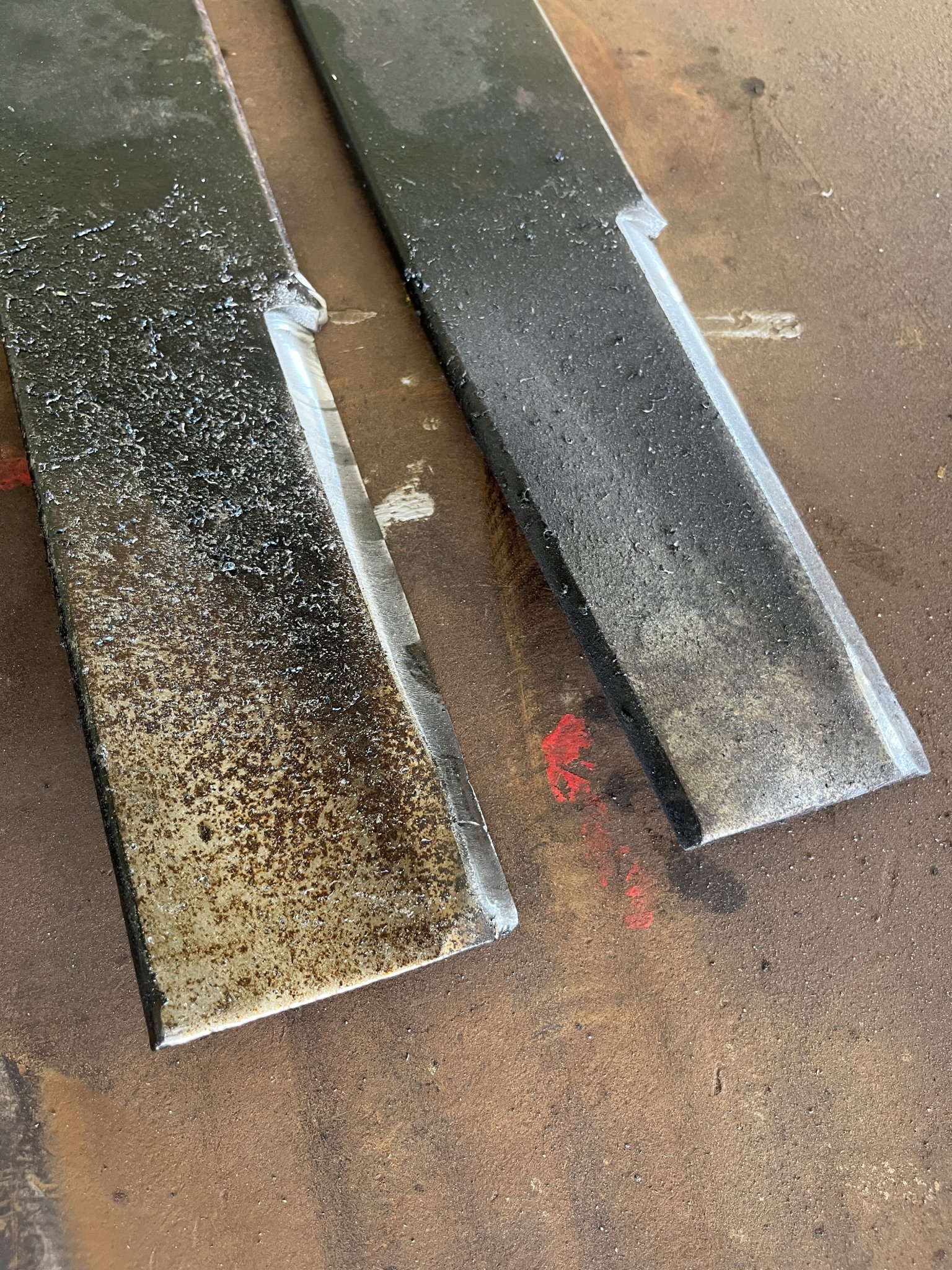

We set up a tilt table on it, set to 37.5° and mill back to this:
Sometimes it takes a bit of welding for the bigger gouges like the one in the first picture, but the end result is a "new" edge that can be field dressed with a 4" grinder on a daily basis. We do that for 40 hrs or so, then back to the mill. We keep 5 or 6 sets of blades in reserve, and once the mill is set up, it goes pretty fast. 5 sets of blades will last a couple seasons (I'm in Florida, we mow about 9 months a year)
