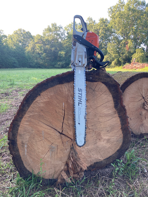

Depends on the chain. I have a couple of loops of carbide chain for this bad boy:
At over $300 per loop, I replace the individual chipped cutter links when required. The first time paid for the spinner and breaker!;)
