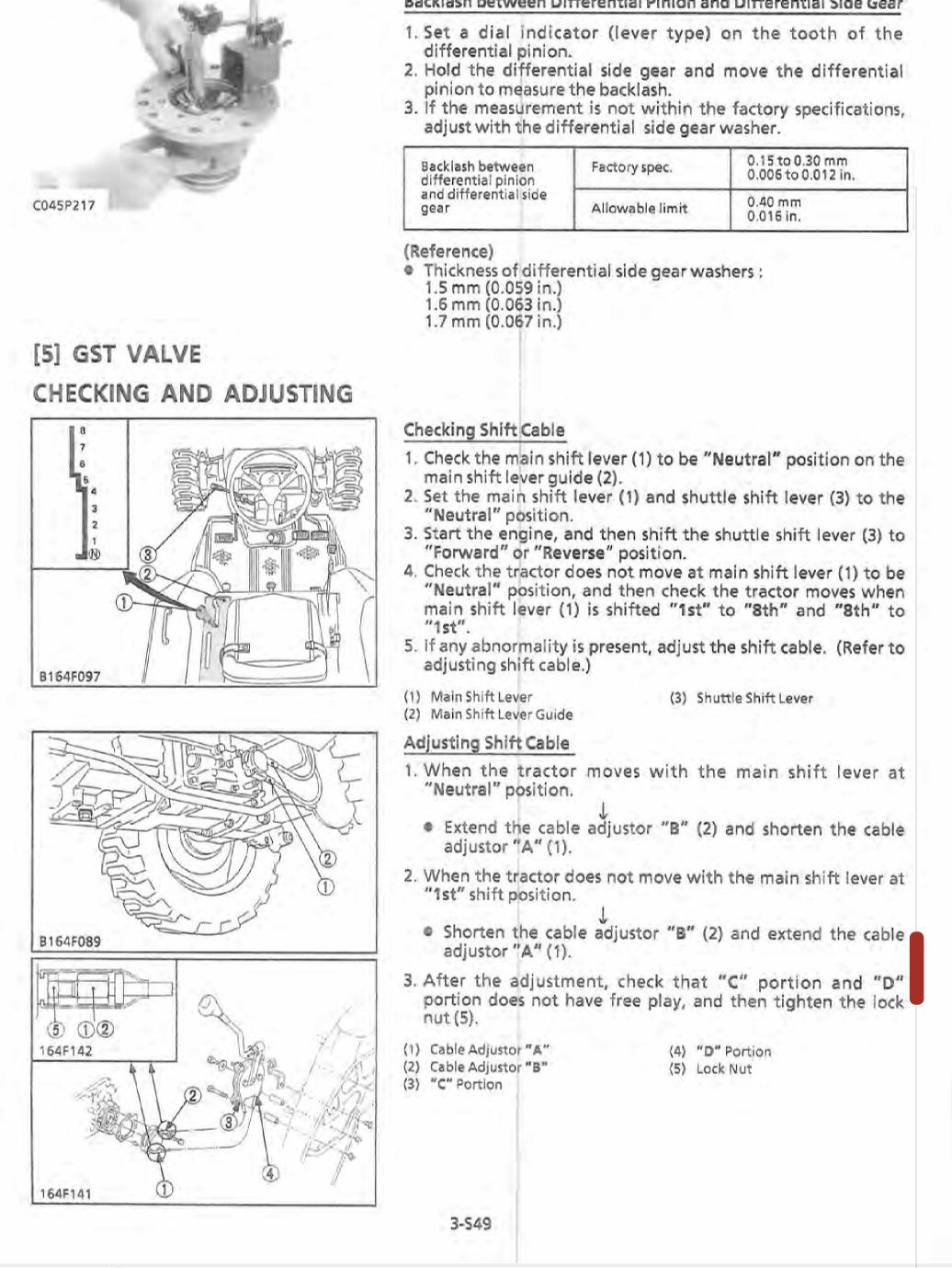

I will check those adjustments today. I did buy the manual and downloaded it but the repair section of it where the pictures are at are very hard to read. Is there a particular symptom I'm looking for if it's the transmission?
Is this any clearer?
The GlideShifts have a bunch of hydraulic valves and passages, so I'd recommend Kubota fluid when changing fluid. And there are some pressure checks. But your symptoms seem like a cable/adjustment issue.
The clutch sounds like a wear/adjustment issue or something's bent, broken, or disconnected.
YES!! Thank you for that picture. I'll keep you posted.
So I adjusted the shift linkage per in instructions. The tractor has very tight shifting now and is way better. The only issue is that when shifting from one gear to another gear there is a delay as it takes probably 1-2 second to catch. Not all the time but majority of the time. I also have to adjust it back a little as when in neutral it wants to go forward or reverse in #1 gear.
Remember, this isn't a hydrostatic transmission. When you move the lever, the tranny is disengaging the clutch pack, shifting gears and reengaging the clutch. And when going between 4 and 5 it's also shifting ranges. It can be a little disconcerting when going up or down hill.
