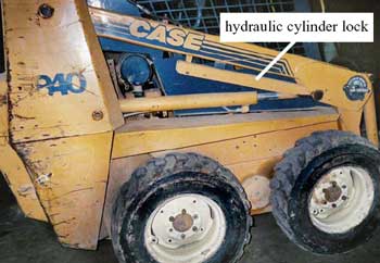

Many would say it is a very bad idea - pure safety, if somehow a hydraulic line failed, it would fall and ,well - there is a picture that needs no description!
Most who raise the FEL - place a piece of U shape tubing over the cylinder or make their own. This "tube" will not allow the ram to lower. It can be made by cutting a piece of pipe in half and then strapping it back over the cylinder , or two pieces of angle iron that can be place back together on each cylinder. There are many places on the net to buy, and many ideas to build.
AND NO - s 2x4 standing up is not a good idea!:D:)

Josef, if you extended you loader up in the air, you would be able to see the shinny chrome of the cylinder ram.
If you had a piece of metal the shape of a "C", you could put that metal on the shinny chrome so it would fit only on the chrome and butt up against both ends of the cylinder. This could be held in place by a tie strap, large hose clamp, bailing wire! But it keeps the piece of "C" shaped iron in place so the cylinders can not collapse under any condition, until it is removed.

What D2Cat said;
A picture is worth a thousand words
Picture this bucket fully up, drop the safety lever down onto the ram,
lower the ram back down onto the safety bar and will go no further down,
while you are under it.
