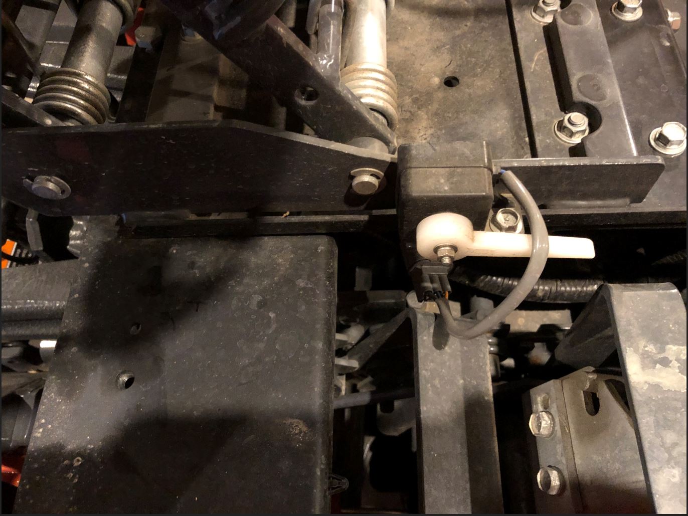

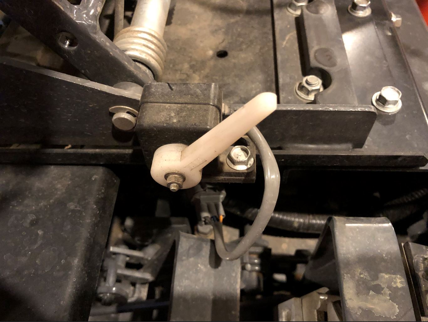

Here's what I did. Perhaps yours is the same as mine...
"stock"
"Fixed"

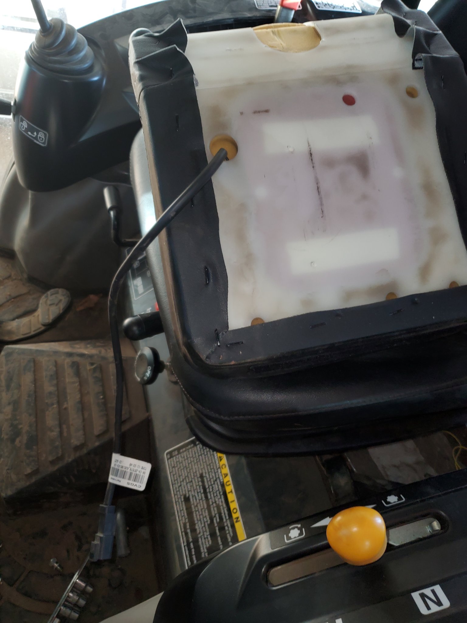

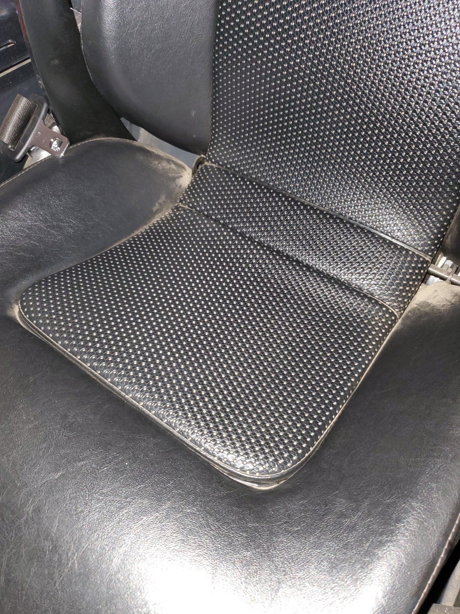

So today I bypassed the seat interlock, nothing like the pictures supplied by @dirtydeed, his might be an open cab model not sure, mine has a cab.
Thinking that my situation was the same as dirtydeed's I started out removing the seat. Removing the seat is not necessary. You start by removing the seat cushion, loosen the Velcro on the front and pull down on the seat back, the cusion will now be free of the seat.
Next you will move the seat all the way forward and disconnect the connector for the seat interlock. After that I made a small jumper with 14 AWG wire and inserted it into the connector.
When that is complete reattach the seat cushion and you are ready to go. I will be getting some shrink wrap to cover the jumper with but other than that its a pretty quick fix once I knew what was happening.

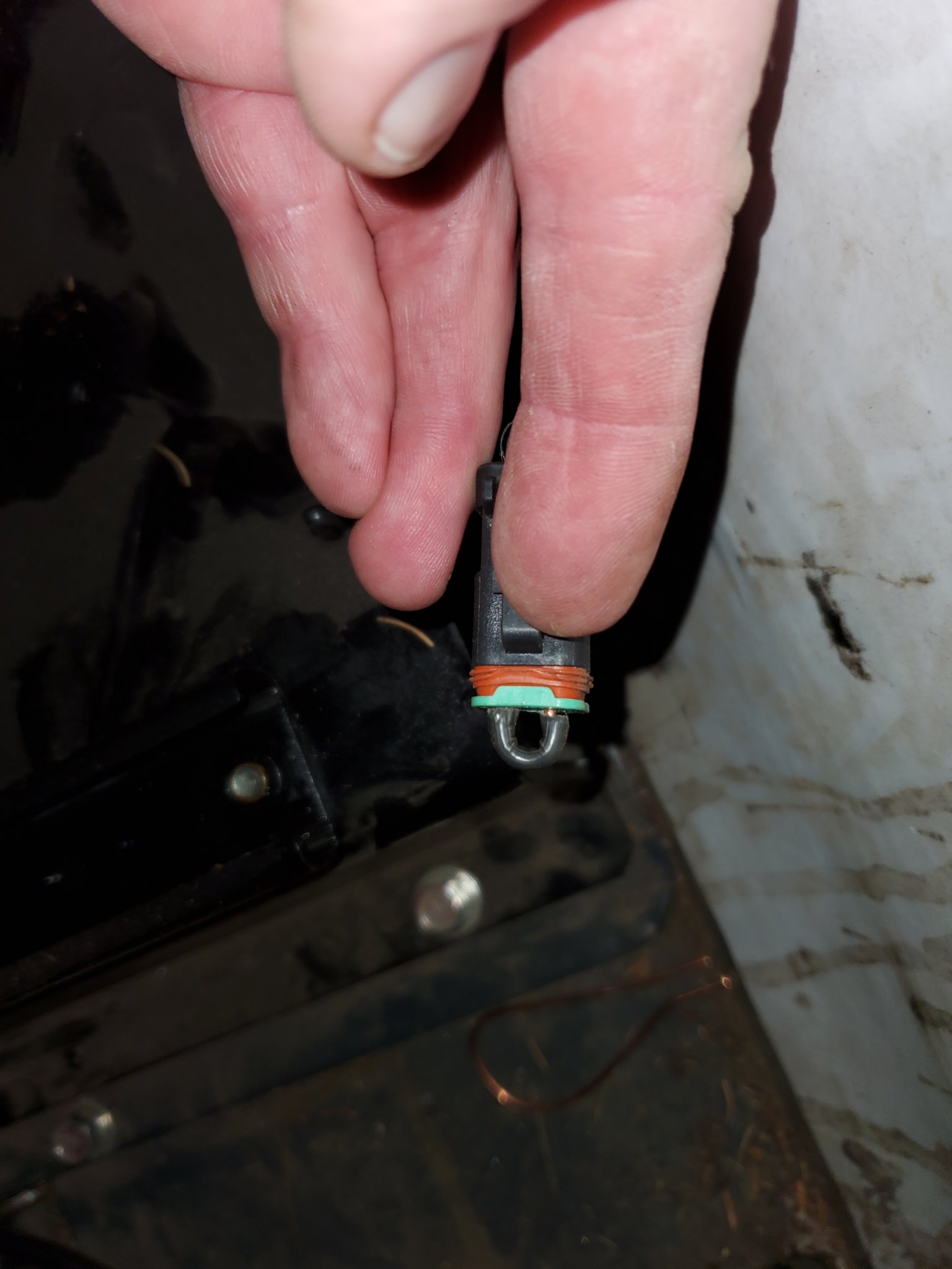

Or you can do what I did as posted here
it has been this way for a year now without one failure and I still have all the functionality of the original seat switch
