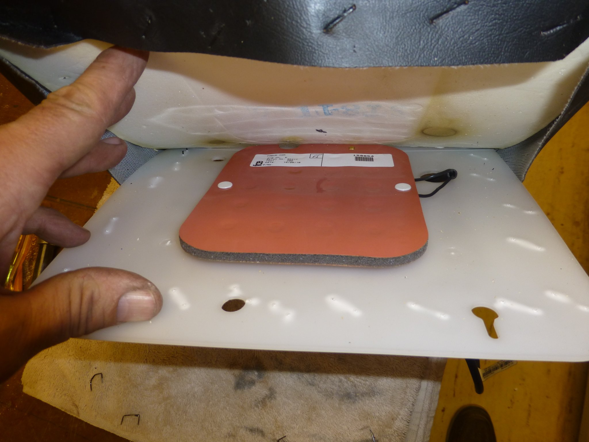

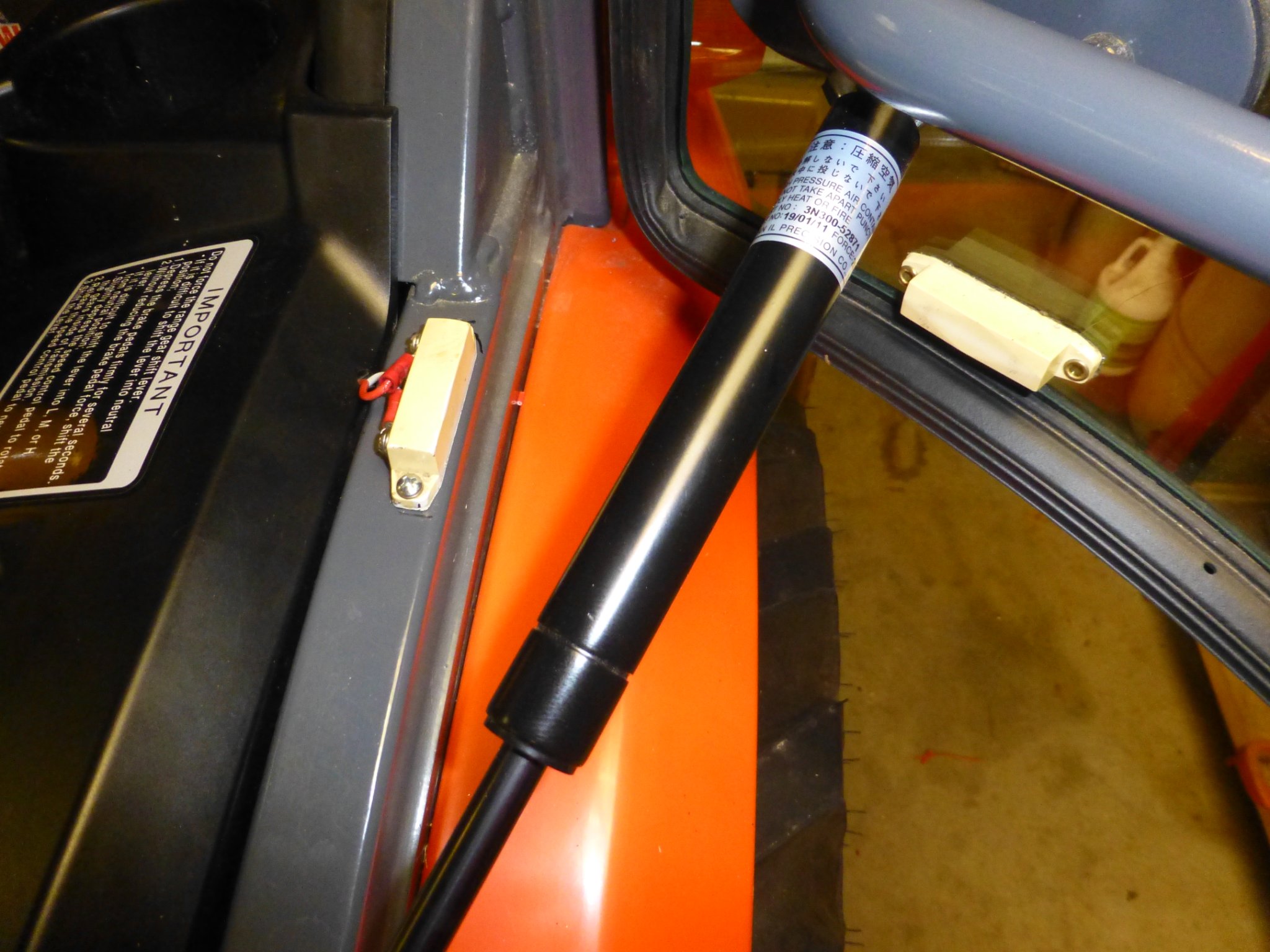

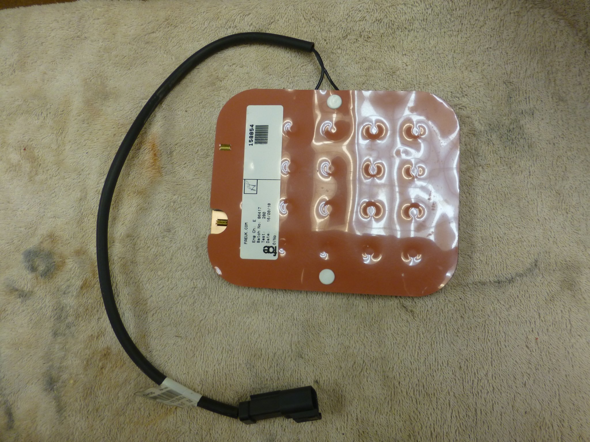

I have had my B2650HSDC for almost 2 years and have had a intermittent seat switch problem almost from the begining. Because I have no way to get my tractor back to the dealer to have the seat switch replaced under warranty, I have had the seat switch bypassed since late summer. Well I have permanently solved the problem by installing a magnetic switch on the door of the cab. I disassembled the seat pad to find that what is most likely causing the problem, is the layer of foam between the two copper foil sheets. In cold weather the foam in the seat, as well as the foam between the copper is harder to compress, thus keeping the copper from making contact to close the switch. I also believe that the size of the switch is too small to effectively make contact if you shift your butt in the seat. I really did not want to leave the switch bypassed for safety reasons, so now with the magnetic switch mounted to the door, I have exactly the same functionality as before without all if the hassle of the intermittent failure of the seat switch.
I disassembled the seat pad to gain access to the wires and cut them loose from the copper foil pad. I ran the wires behind, and under the plastic cup holder and to the outside edge where I mounted the switch. The magnet half of the switch is held to the glass door with some good 3m double face tape. Now if my tractors quits running during normal use, I will know to look elsewhere for the problem.

That should work well for you. Nice pics! I've always wondered what those seat pad switches looked like.

I wish I would have thought about putting the dome light on a magnetic switch while i had the roof off the tractor. It would have been real easy to have run some wires down the pillar to accomplish it. So far the door switch has worked flawlessly.

First of all, if I am operating my tractor from the cab, I always wear my seat belt. So it would be unlikely that I would fall off the seat. The door switch does the same thing the seat switch does, only without the nagging intermittent failure of the seat switch that causes the tractor to shut down because it believes I have removed myself from the seat while either the pto is engaged, without the parking break set, or I have pressed the foot pedal, to make the tractor move in forward or reverse direction without being in the seat. Both actions have been designed into the Operator Presence Control system to shut down the tractor to prevent bad things from happening to the operator or equipment. Now if I open the door, while any of the above mentioned conditions exist, the Operator Presence Control system does the same thing, it shuts down the engine, keeping me and my tractor safe.
While some people may think that I am going to far to be on the safe side of things, thats ok. But this is my first tractor, and I want to make sure that at the end of the day, that I can go home in one piece. I'm sure all of those people that got wound up in their pto shaft, or run over by their own tractor, didnt leave their house that morning thinking that that would be their last day, but it was. Thats not the box thats going to be checked on my death certificate.

The Operator Presence Control system allows the engine to start with the following conditions being met:
The transmission can be in any range, neutral being the preferred choice.
The pto needs to be disengaged
The forward/reverse treadle pedal must be in the centered position.
Under the above conditions the engine will start.
If one needs to do inspections with the engine running, the following conditions should be implemented:
The parking break should be engaged.
The transmission should be in neutral.
Note that these two conditions make it safer to walk around the tractor, but the engine will still start even if these conditions are not met.
If I need to run the pto, say for a chipper, or log splitter, I can open the door and get out of the cab, if I first engage the parking break. I need not put the transmission in neutral, but it is recommended. I can then engage the pto, and exit the cab.
The seat switch, now replaced by my door switch, only plays a part of the Operator Presence Control system when any operation of the tractor requires that one actually be sitting in the seat to perform any tractor operation that requires movement of the tractor, or pto engagement. So again, if I open my door while my pto is engaged, or I am trying to move my tractor forward or reverse, my engine will shut down.
As I understand it, the above stàtements may only apply to my specific B2650HSDC model tractor, and that other models have different requirements for the safe operation of that model. I would encourage everyone to read and follow the operators manual for their specific tractor, and follow all manufacturers recommendations.

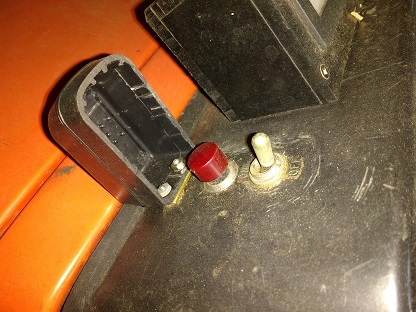

I have an older BX23 with most of those troublesome safety switches. They are all working as they should right now, but they seem to cause trouble, just when you really need your tractor. Consequently, after consulting the WSM schematic, there is now a switch that will bypass all of them at once. That way, you can keep on operating till there is a good time to fix them. It has bailed me out more than once.
