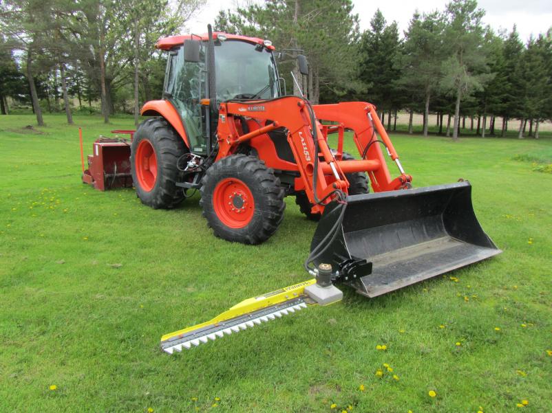

I have a Samurai.
It is not going to cut grass. Small saplings yes.
Be certain to get the break-a-way optional mount.
Dave
How well does it do Dave? Any issues with it? I was interested in one to trim back our trails on the lease mostly cutting 1/4" to 1 1/2" stuff overhanging. I think the GPMs on the hydraulic on my L2501 will run it.
If the stuff you want to cut is dead and has been to the point of being hard and tough then it struggles to cut it.
1-1/2" seems too large but I never measured anything.
I like it but it is not a perfect solution but I do not know what is for that type of application.
Serious farmers use their tracked excavators to push back the growth rather than cutting it.
I rigged up a 3 gpm sprayer on the back of an old garden tractor and have both a wand and a single nozzle which sprays Roundup 11'. I drive along the edge of our trails and spray the stone fences which is where the growth on our land is happening.
I am trying to stop stuff from growing in the first place.
The Samurai manufacturer is excellent to deal with.
I bought my cutter before the break-a-way mount was available. My tractor was breaking bolts on the standard mount and was frustrating me. The break-a-way mount, now available, was only $100 more than the standard mount. I contacted the company and they agreed to have me return the used standard mount and supply me with the new style paying only the $100. That level of customer service is rare!!
Dave
